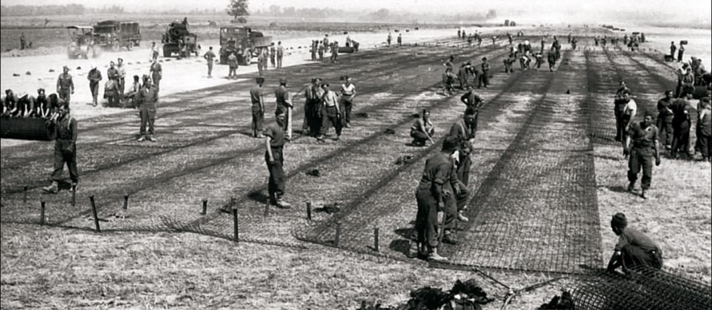

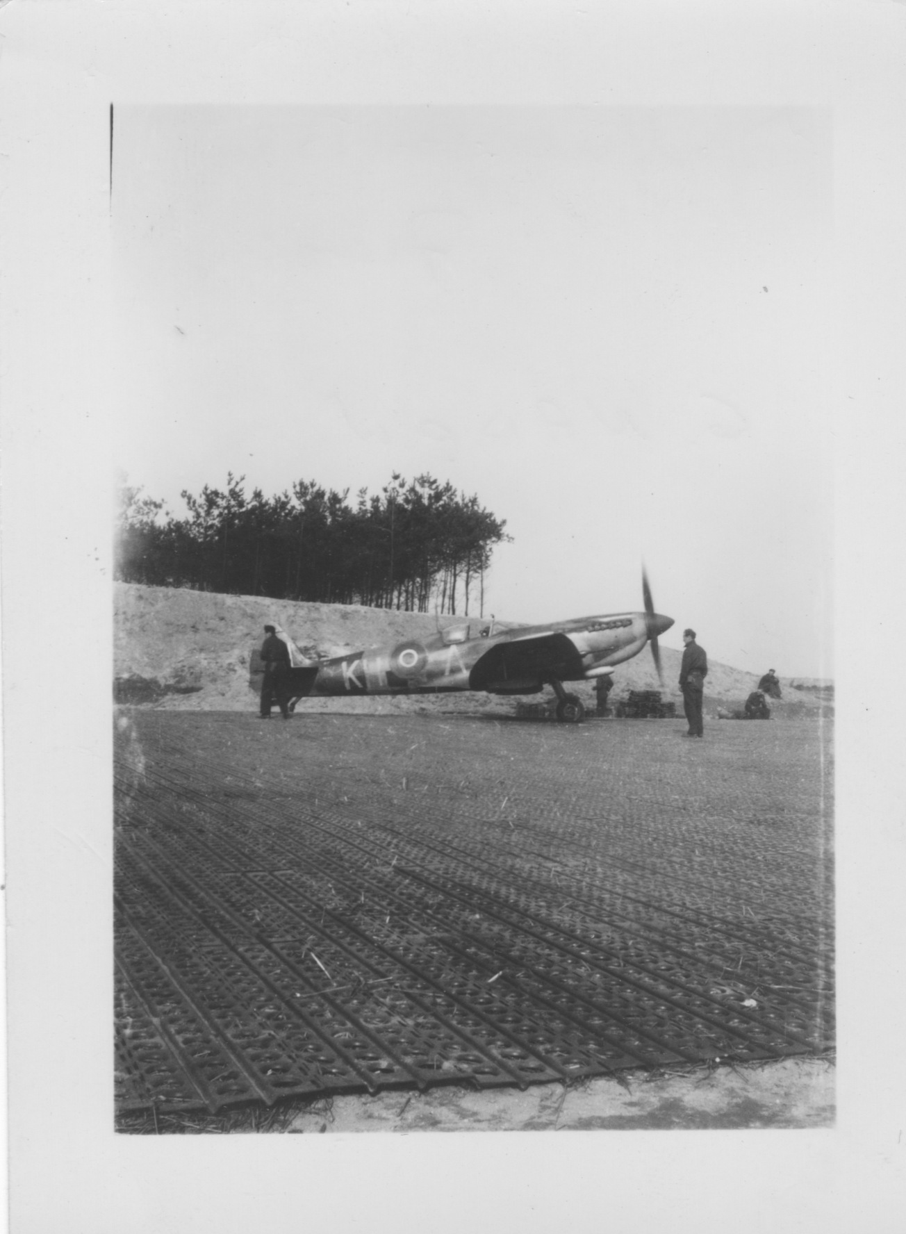

Each group comprised two Road Construction Companies and two Pioneer Companies. The plant available included crawler tractors, motor graders, scrapers, rollers, tipper trucks and transporters. Square Mesh Track (SMT) was used as ground surfacing material.

Despite these delays, the first Emergency Landing Strip was constructed at Asnelles by 16 Airfield Construction Group and was operational by D+1 (7 June), the first Refuelling and Rearming Strip by D+3, and the first two Advanced Landing Grounds by D+7 (13 June), one day ahead of schedule.

ALG B-2 would have been completed as the first ALG in Normandy on 9 June, but a B-24 Libeator crashlanded at the uncompleted airfield that morning and ripped up a lot of SMT.
Instead it was completed two days later, on June 11, and serviced the first 36 aircraft (Spitfires) of 127 Wing that same day.
