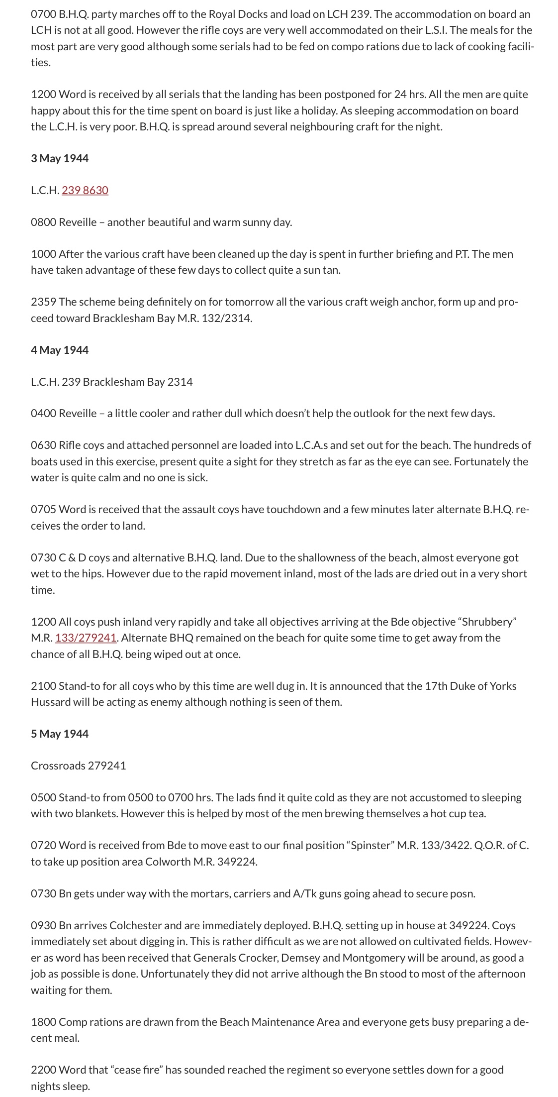

Phil, tried your suggestion........first I wanted to confirm the EXACT DATE and timings that Fabius III happened.....and this was hard also (not many records on line of the exercise......but I finally found it in the Queens Owns Rifles War Diaries
So, the Exercise happened (after a delay of 24 hours) from the 3 May to 5 May 1944.......

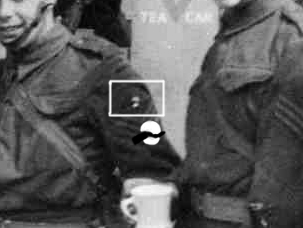

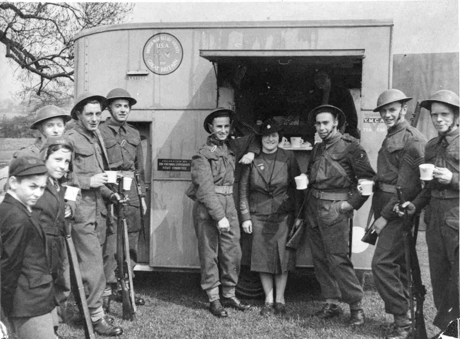

Further information and a photograph. The aim here is to identify these men as Canadians, if not personal identification, and ascertain what Canadian units were in Horbury/Wakefield, whether or not they participated in D-Day training and if any were killed in said training.
YMCA tea van - Mrs Briggs WVS.jpg (151.77 KiB) Viewed 15429 times

I'm seeing if we can get a clearer image of this soldier's shoulder.

Phil, I tried to see if their is anything on their uniforms or equipment that would identify these men as Canadian………and what I see Phil are BRITISH soldiers……..my reasoning:

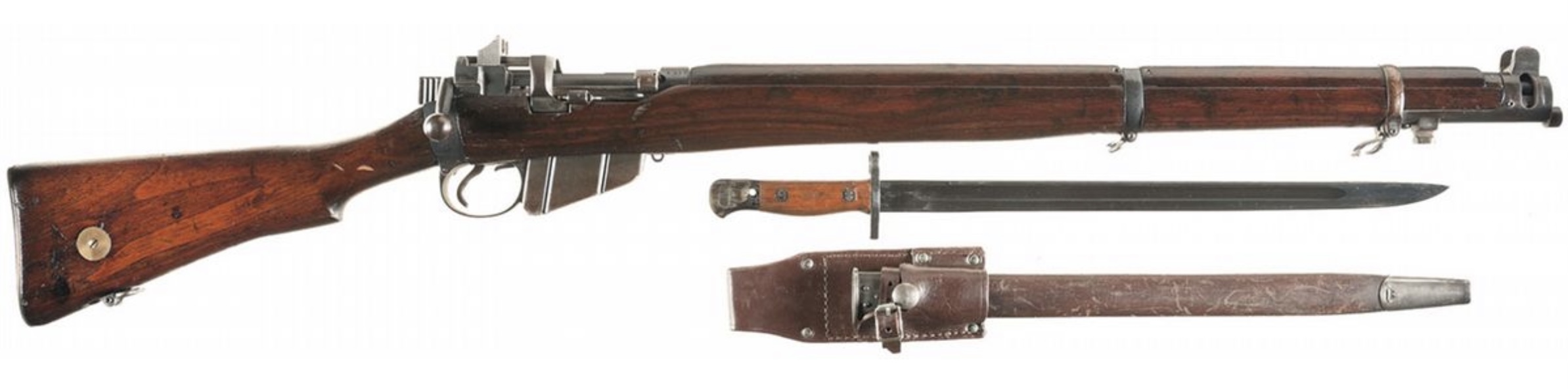

I focused on the rifle and bayonet. The rifles in this picture are Lee–Enfield No. 1 Mk V with sword bayonet. These are rifles issued and carried by the British army. The No1 Mk V had TWO bands on the foreshock of the rifle, and the front site was at the END of the rifle, with the front stock coming to the very end of the barrel……photo below…….this photo also shows the sword bayonet…….that you clearly can see on the hip of the soldiers

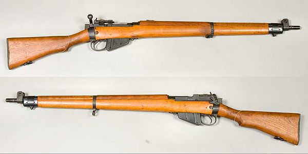

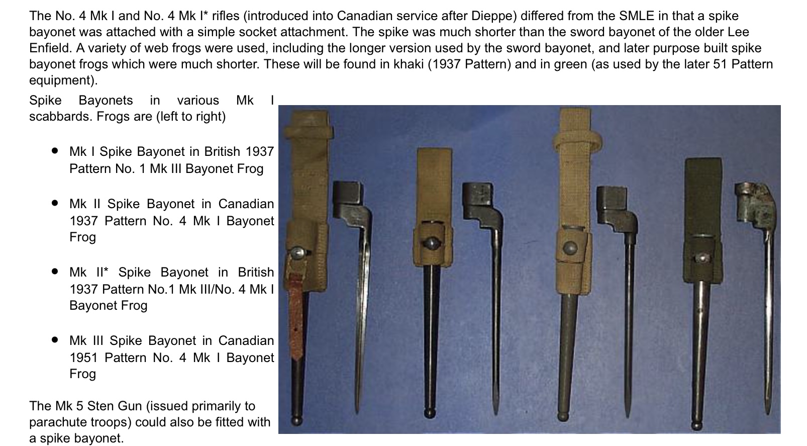

The CANADIAN ARMY adopted the Lee-Enfield No 4 Mk 1 in 1943, and these were the rifles Canada used in Italy and NW Europe……..these rifles had ONE band on the fore stock, the barrel “protruded” beyond the end of the fore stock……you can see in the photo below………AND the Canadians used the “spike” bayonet (and later adopted a “knife or blade bayonet, much shorter that the “sword bayonet”)
So I believe these are NOT Canadian troops, but are BRITISH TROOPS

Post by Temujin » Fri Aug 06, 2021 11:44 am
Another clue is that these men in the “coffee truck photo” are wearing the Mark 1 helmet………Canadian Troops who were assigned to land on D Day were issued the Mark III “Turtle Helmet”……..and in fact were wearing them on Exercise Fabius III (the Juno Beach practice exersice). Photo below, and you can see the Canadian troops are wearing the Mark III Helmet and carrying the Lee Enfield No 4 rifle. This is at Fabius III
On the soldier standing on the LAC (over the number) you can see the barrel sticking out beyond the stock, which is the No 4 rifle, and NONE of the soldiers are wearing the “sword bayonet”…..which was very long
So, I’m sticking with my premise the the “coffee truck troops” are NOT Canadian (assuming this is taken in 1944?)

Post by Phil » Fri Aug 06, 2021 1:01 pm
Yes, the assumption is 1944 for the photo even though it is undated. I agree with the helmet assessment, they stood out to me initially, and it is quite obviously a sword bayonet that one of the tea car soldiers has on his hip. Great work.
