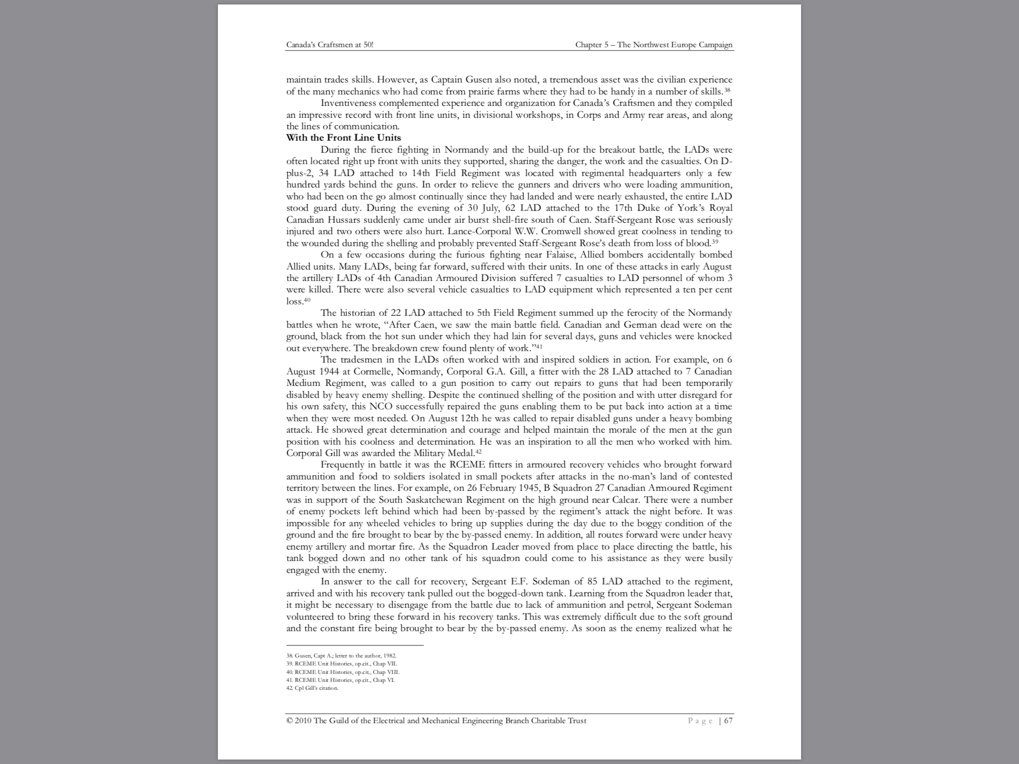

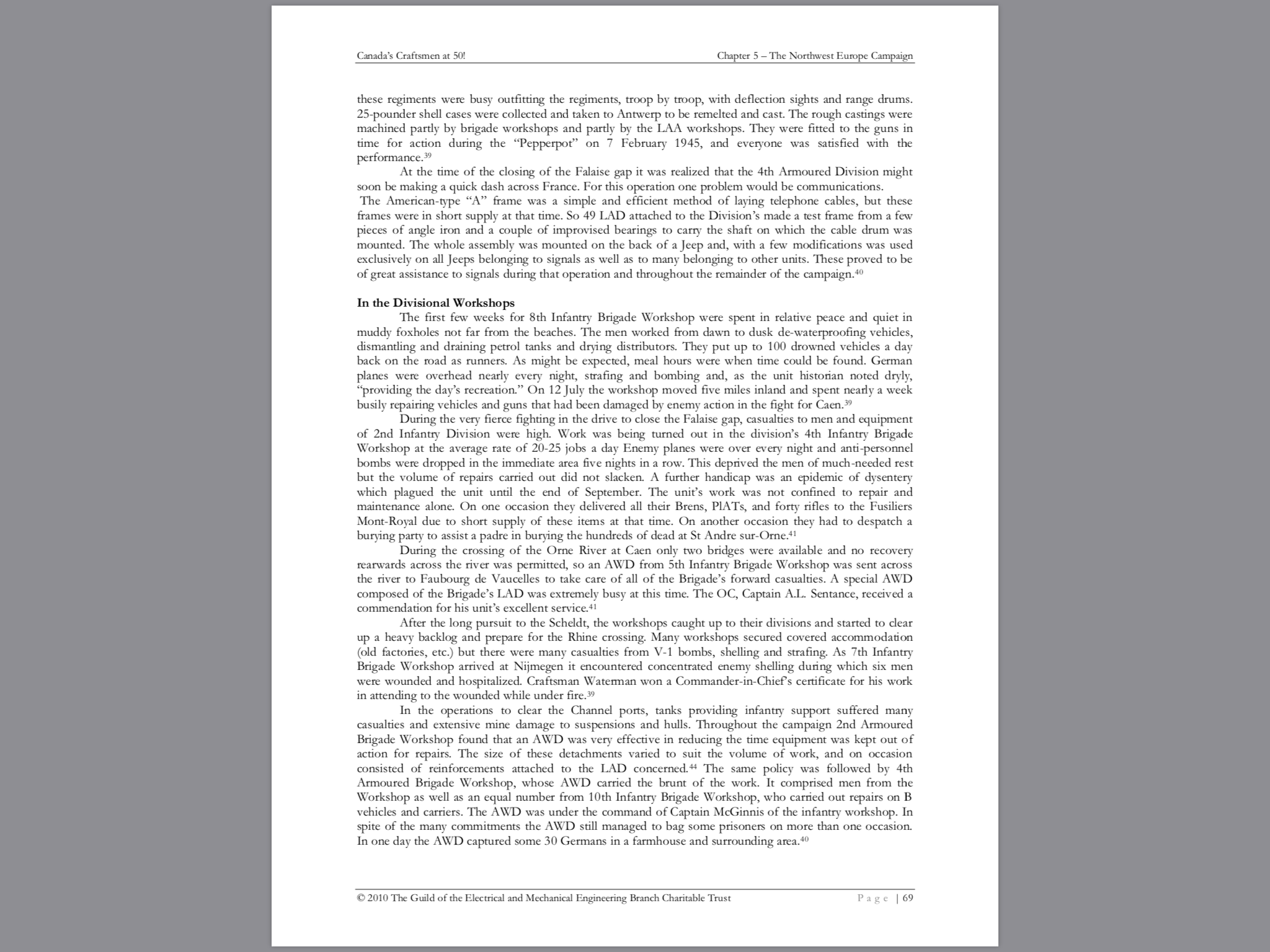

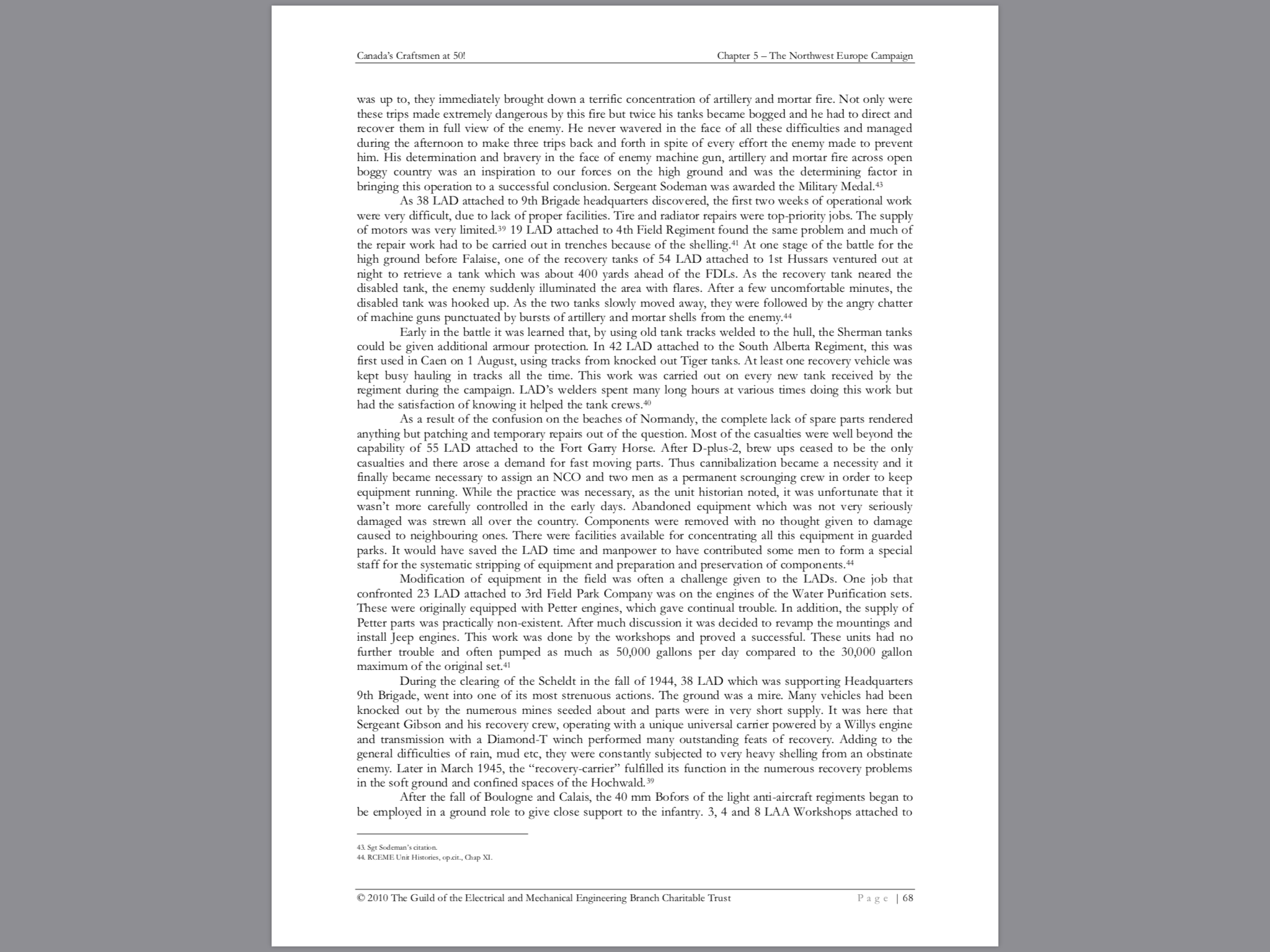

Post by Temujin » Fri Aug 17, 2018 1:24 am
Here’s some “history” of LAD’s during the Normandy Landings. Give’s you a sense of what they did
Source:
The Story of Electrical and Mechanical Engineering in the Canadian Armed Forces
up to and including The 50th Anniversary of the formation of the
Corps of Royal Canadian Electrical and Mechanical Engineers
by
Colonel Murray C. Johnston

Post by ccamfield » Fri Aug 17, 2018 6:19 am
Woah, that's a lot of information :) But I guess it's easier to cut & paste the whole kit and kaboodle.
This does of course answer my question and it's quite interesting. I see that 35 Cdn LAD (assigned to 3rd Canadian AT) already was a Type D.
Will have to see what more I can glean from this when I have had more sleep. :-/
