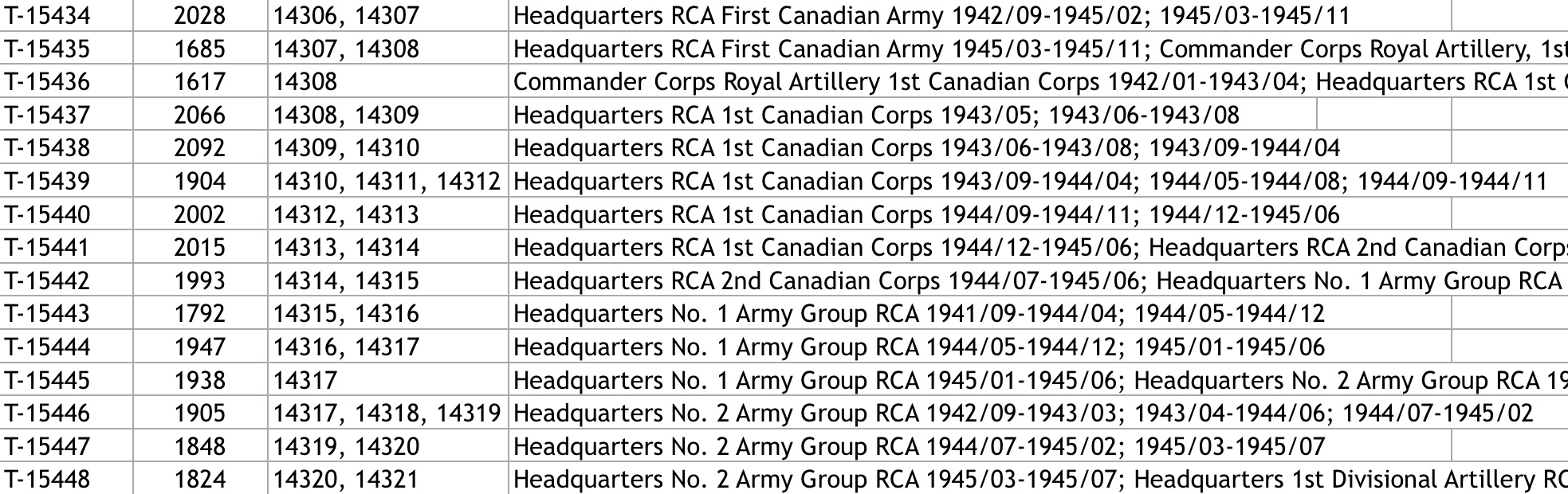

Thanks temujin, that's wonderfully informative as always! I did not know about the artillery trailer in between quad and gun.
I have access to the spreadsheet which I think you have taken a screenshot from so no worries there. I wasn't looking for a specific unit, it was more that I came across a complaint about the FATs in August 44.
The performance of the wheeled tractor drawn 17-pounder equipment has not proved satisfactory and the need for more 17-pounder SP equipments has been represented by British as well as Canadian unit formations.
I guess actually any more information I could turn up on vehicle holdings for 7th Canadian AT Regiment might be helpful. But I don't know how I would work from that (which I think was a Corps level unit) to which field company or LAD was assigned to it. I have looked at their WD in the past.
P.S. and how interesting that we were mostly using Morris FATs!
P.P.S. I don't suppose you have any experience hunting down 21st Army Group / 1st Canadian Army memos at LAC? :D
I’m not exactly sure what your looking for in your reference. If your looking for correspondence in reference to something sent “up the chain” from the 7th Cdn AT Regiment, I would look thru the War diaries of the HQ’s unit above them, so I would first look at 1 Cdn Corp, RCA war diaries, then CCRA war diaries, then First Cdn Army RCA HQ’s war diaries........before I would even attempt to look at 21 Army Group HQ AGRA
In the War diaries list, I would like thru the files of these units first

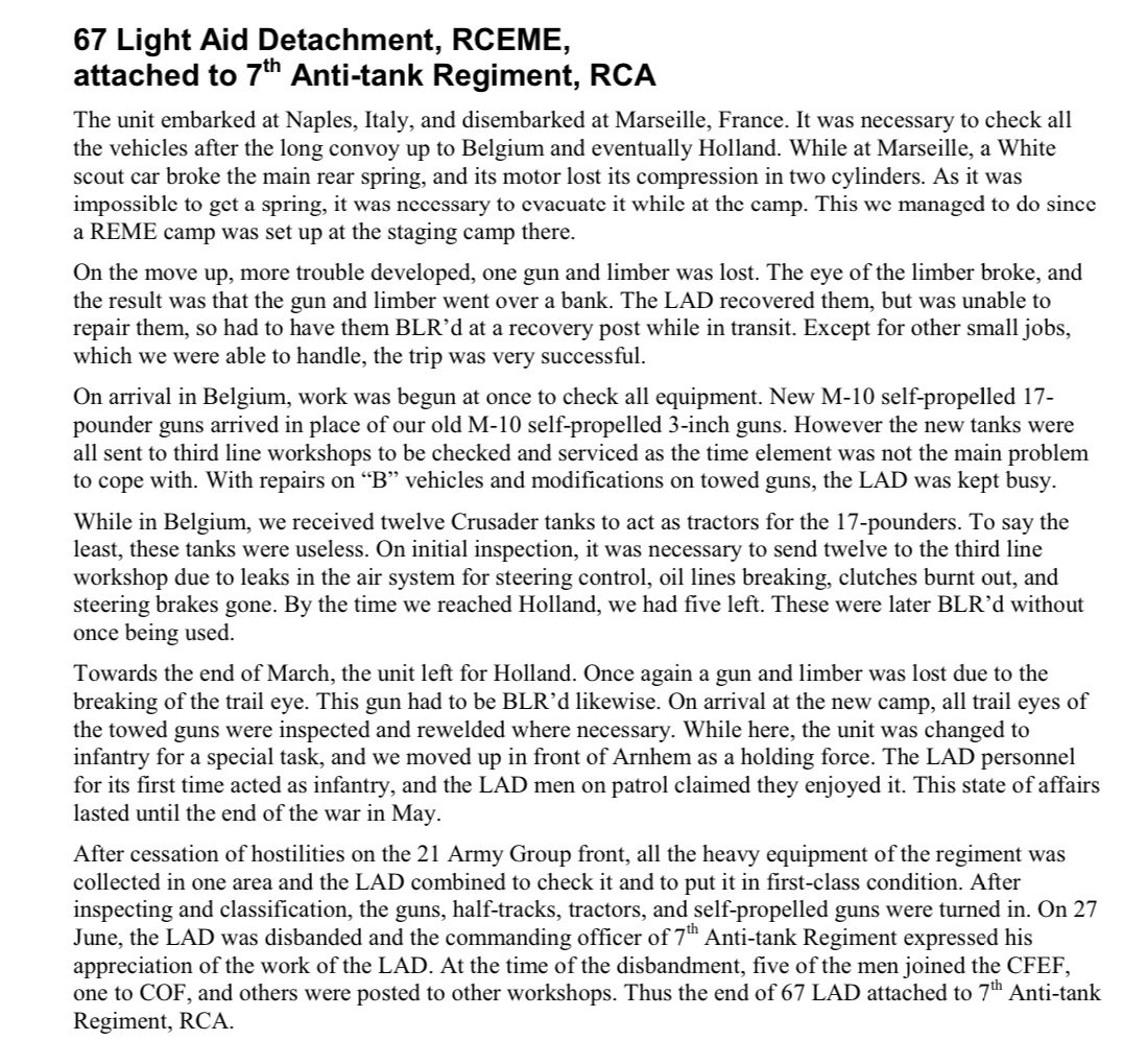

I did actually photograph some of 67 LAD's war diary on one of my visits to the archives. (Sept '44 to June '45, only the daily entries)
e.g.
