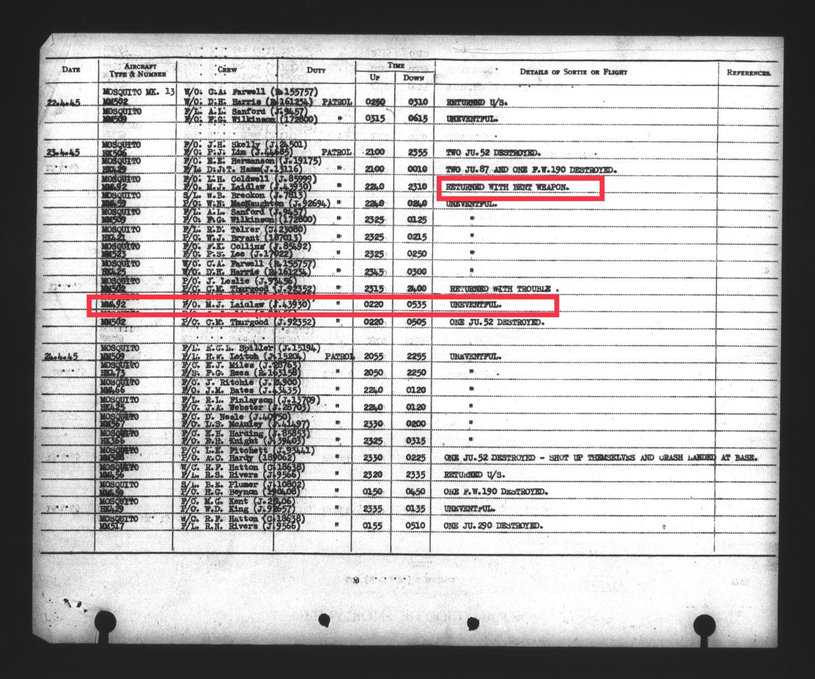

The “clue” George is the Mosquito you have quoted, was MM492, which was a Mosquito NF XIII model. A “night fighter”......so was “armed” with the airborne radar to track enemy aircraft. A “bent weapon” was the term used then to indicate that the “radar system had failed”.....which meant they couldn’t track enemy aircraft in the dark because their main “tracking weapon” was broken.
Other phrases they used at this time were:
’Flash your weapon' was the instruction given over the R/t (sometimes by a Waaf!) to use airborne radar. 'Bent weapon' indicated yet another failure!
Here’s the record on that aircraft for you
