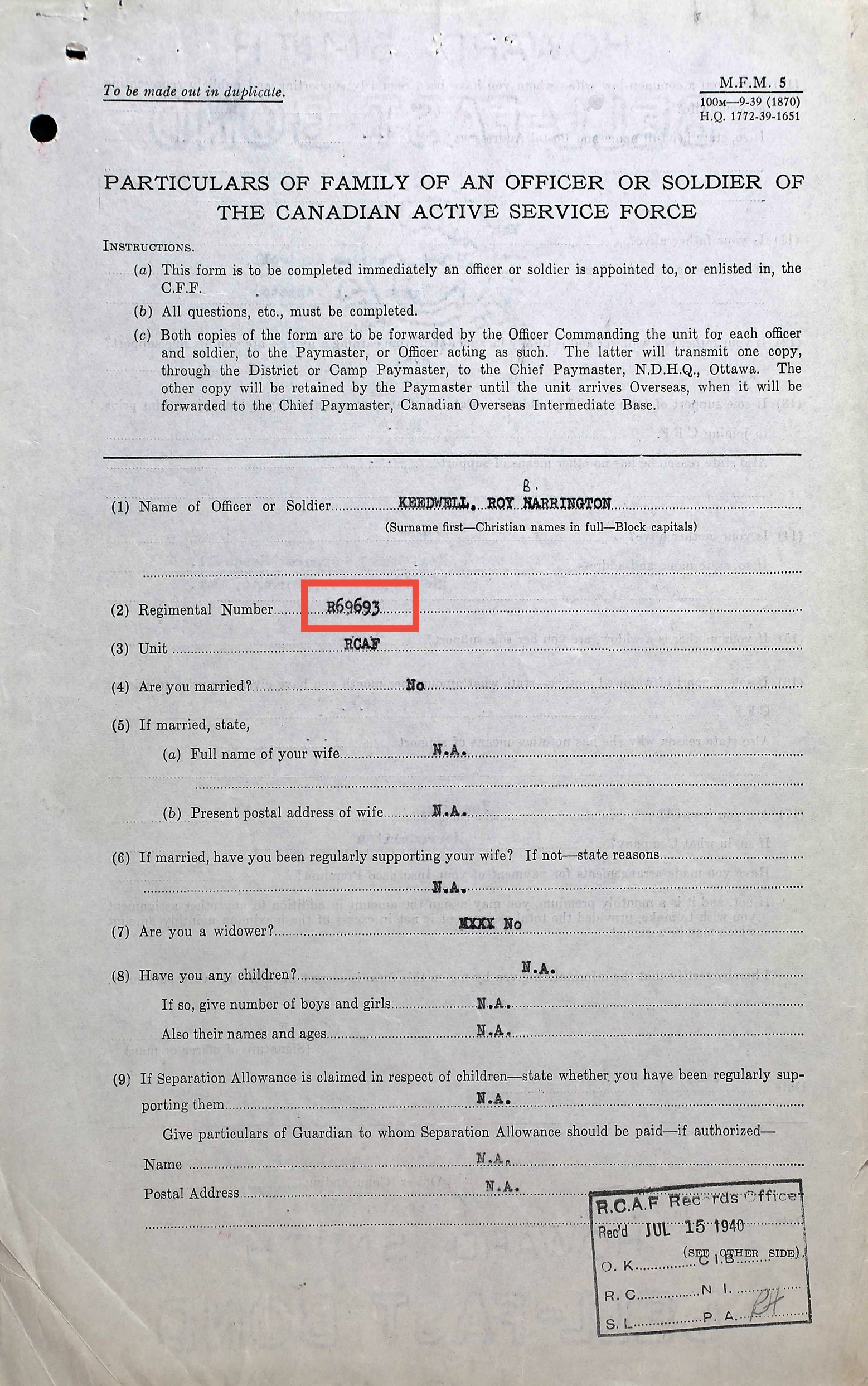

Hi Wartimes,
I have reached the entry in They Shall Grow Not Old for P/O Roy Barrington Keedwell, who died in hospital on or near February 11, 1942, in Palembang, Sumatra, either from wounds or injuries. TSGNO gives his serial number as 'J15227' which is in the range for RCAF officers promoted overseas. But the CWGC site has his serial as 'J152217', which is suspect.
To further complicate the matter the site https://rcafuplands.blogspot.com/2012/1 ... -1940.html gives him the serial 'J15217', previously enlisted as 'R69693'.
Not often we see 3 different serial numbers for one officer. Can anyone clear this up?

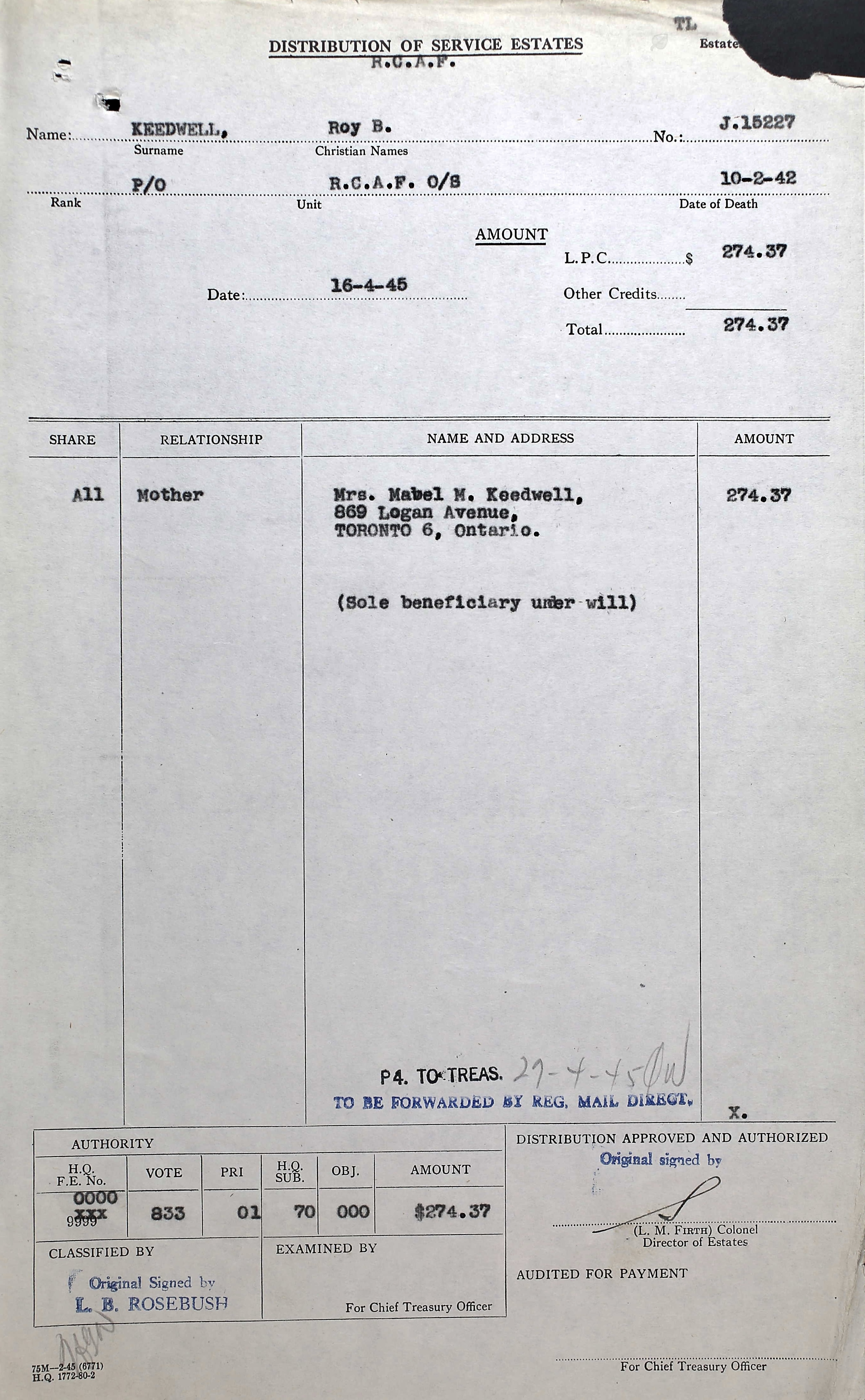

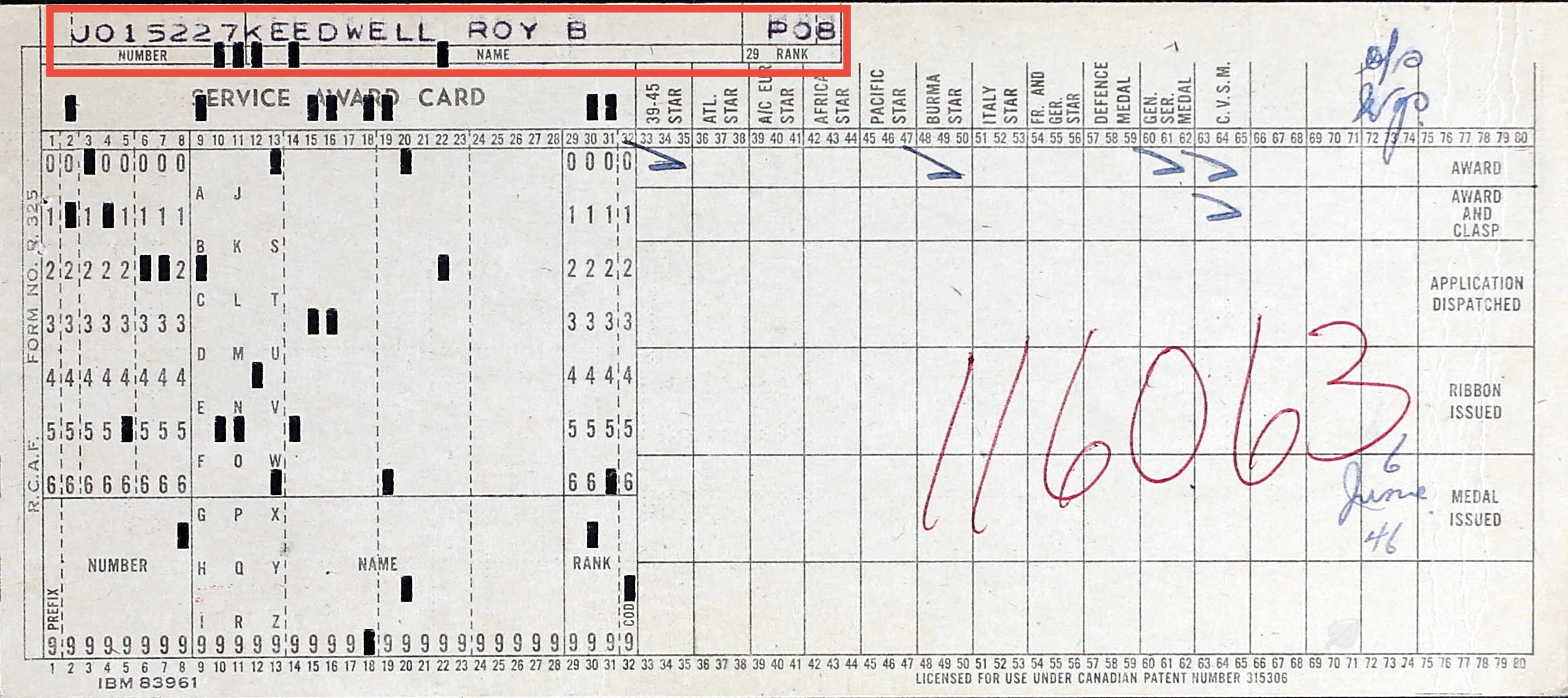

Paul, copies of various records showing his Other Ranks Service Number as R69693 and his Officer Service Number was J15227Paul Squires wrote: ↑Wed May 21, 2025 10:20 pmHi Wartimes,

Thank You again Temujin,
It's not often I see a possible error in the Commonwealth War Graves Commission site, and I don't assume anything unless I can check it. It's too easy publish something that then gets quoted as fact.
(It's what I am trying to do, compare the records on the Internet with the official information, where possible)
In the case of P/O Keedwell the situation at Palembang at that time was chaotic, to say the least, and published recollections of survivors afterwards are, not surprisingly, different. The attestation from Scott, P/O ---- and Gregory in April, 1943, is probably the earliest written statement, and likely the most accurate and Many Thanks again for sending it.
I'll update his entry in the Chronology, and add the information to the Errata, and also reference this thread to the Canadian Virtual War Memorial.
