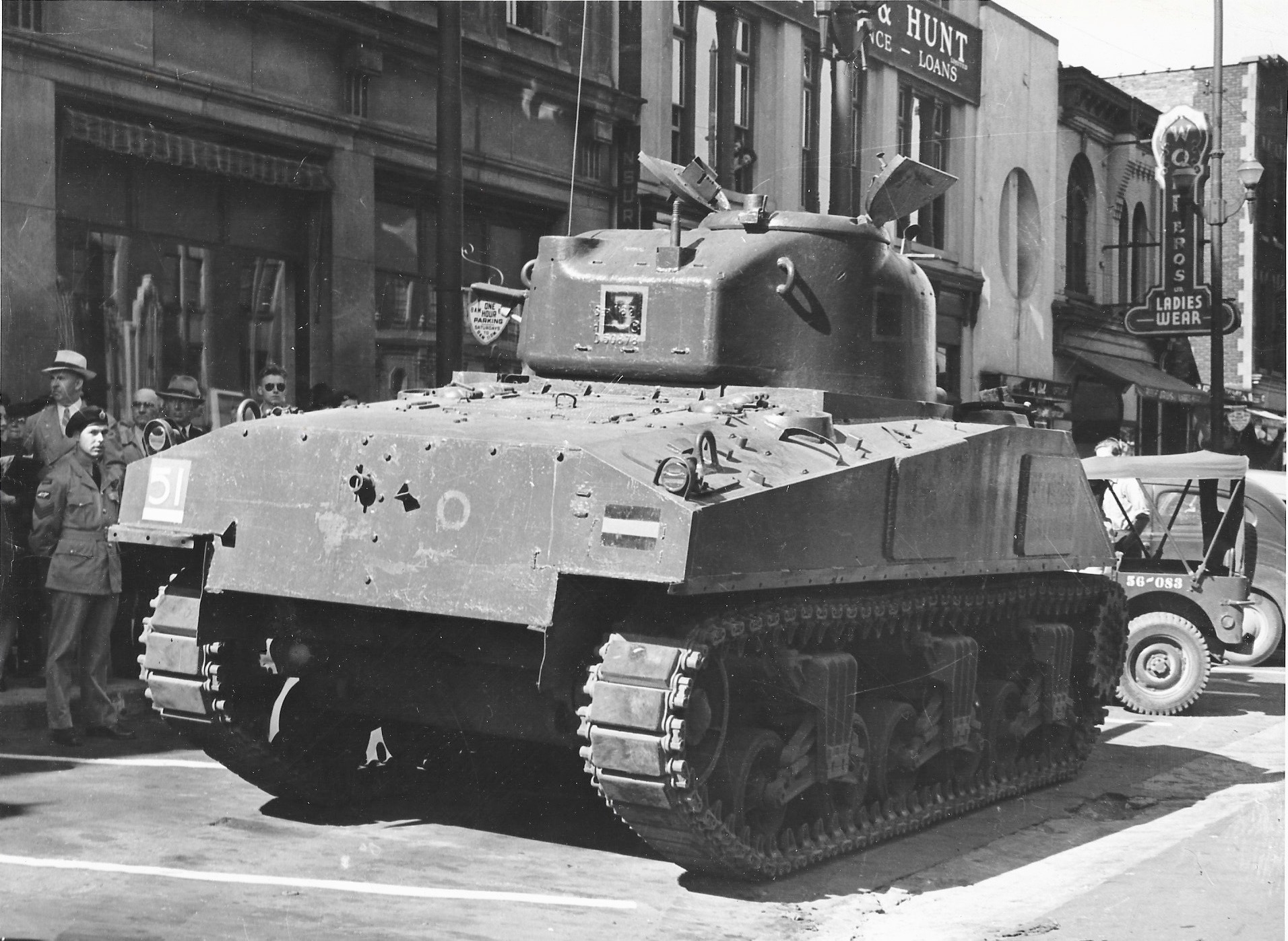

The other is for the armour folk. I have a photo of a tank that on each side of the turret is are two squares outlined in one colour and another solid interior, on the back of the turret one square with a 3 inside the square. I'm thinking B Sqn OC, but some other information has come up to indicate it is the rear link tank due to the 3. Anyone?

As per requested some photos of the tac symbols. BTW Temujin, you are a pillar and an endless amazing person of information. Many many thanks..

Thank you........oh, this is Holy Roller, I believe this is one of the “few” tanks that survived the entire war (from Landing in Normandy to the Cease Fire in May 1945)......I had not seen these photo’s before so thank you so much.CanadianTanker wrote: ↑Wed Jul 15, 2020 4:06 pmAs per requested some photos of the tac symbols. BTW Temujin, you are a pillar and an endless amazing person of information. Many many thanks..HolyRoller2, 14 June 1946jpg copy.jpg
Yes, just checked and 'Holy Roller' is one of just two tanks in the Canadian Army that fought from the D-Day landings until Victory in Europe Day on May 8, 1945.
Let me search a bit more on this, I haven’t found my “tank marking info” (sorry, I have over 100Gb of data stored and sometimes I just can’t find things), but let me look further
And thank you for the compliments, I try to help everyone......and if I don’t know the answer, I can try and find out

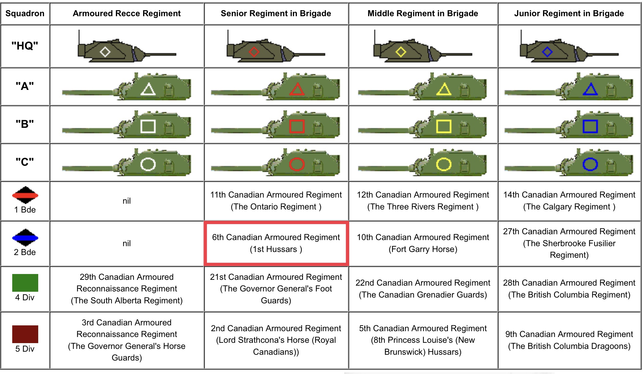

A few photo’s of the tank, and its “request” (with “BOMB”, the other tank that survived the entire NW Europe campaign) This table is “tank markings”, and you can see the 1st Hussars would and this tank would have had RED markings (A square in this case). I have NOT seen where they put TWO marking on the same side of the tank (two squares) before......but we do know that each Regiment kind of “went there own way” in respect to vehicle markings, they were “suppose” to follow directives from HQ’s, but you see LOTS of variants in markings
It is thought that this tank was with Headquarters Troop of the regiment, hence it's name starting with an 'H' (Canadian and British regiments had a tradition of naming their tanks with names that started with the letter of whichever troop thew were in)

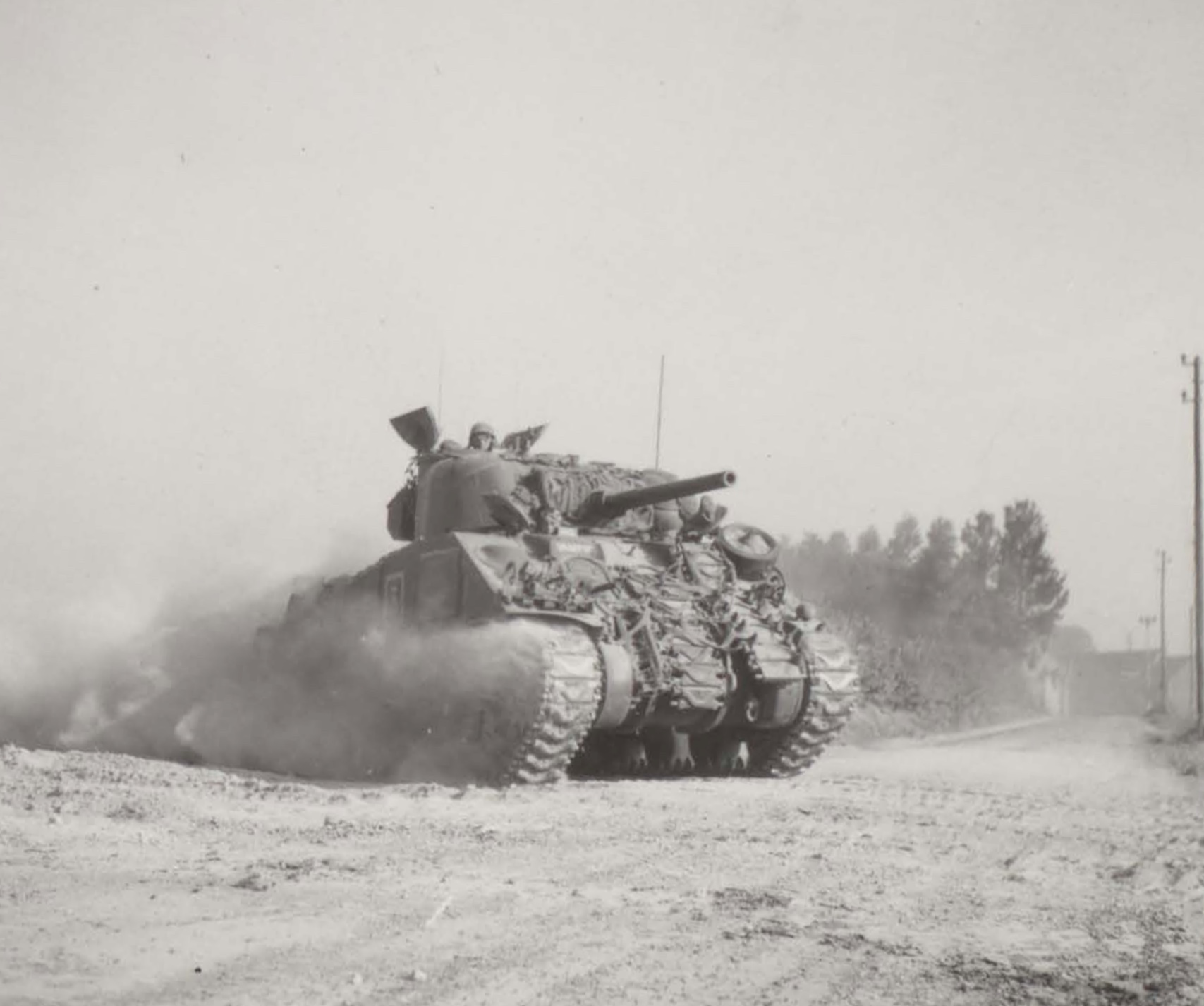

I’ve been searching for more info on this tank. I have found a “whole bunch” of photos of 6 CAR tanks in Normandy and will post them as soon as I get them all downloaded.......I am finding that many did NOT have tactical markings, I’m assuming as many were replacement tanks after the initial landings and crews may NOT have had time to mark them.......also, the 6 CAR received their new Sherman DD tanks in April 1944, not long before D Day. There is also a record of one of the radio operators assigned to the 6 CAR tanks on landing, and he reports that none of the tanks were carrying any markings.
Below is a photo of a TANK (I am NOT sure if this is a 6 CAR tank) which clearly shows its marking, and unlike the photo’s you posted, have the standard “markings” of just ONE marking on each side and rear of the turret. (The pictures you posted were taken in Canada, probably on the vehicles return to Canada) and looks like it has been freshly painted so I’m not sure if the side markings are accurate
More to come:
Photo below is DND photo, taken 20th June 1944
More to come:

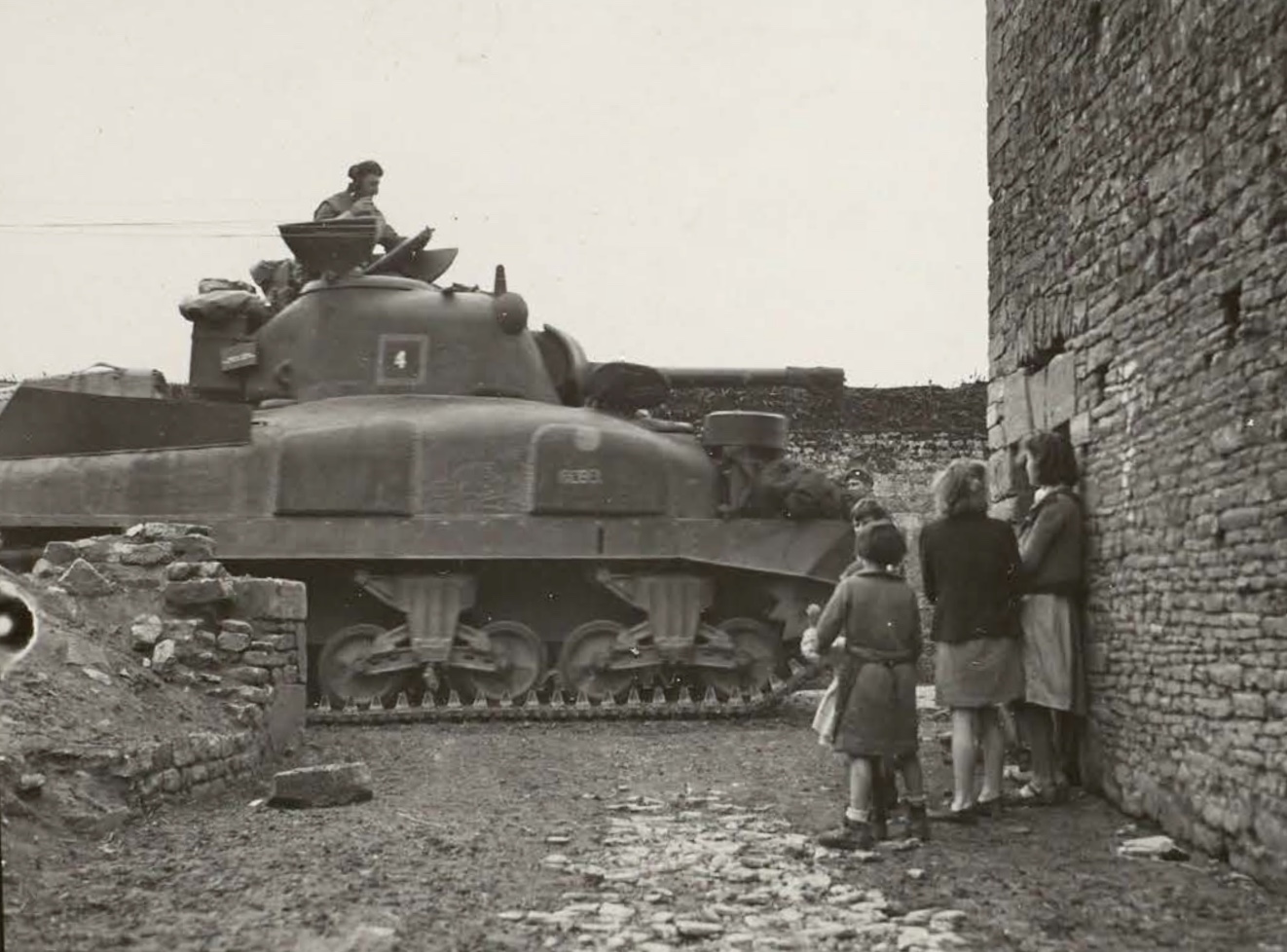

Re: Qualification symbology
Another example of tank markings, this is a Canadian Tank on th 18th July 1944. You can see this one has a “square” with (I believe) the number 3 in it, but the marking is on the hull, NOT on the turret. So markings varied greatly......plus the photo’s I”m going thru mostly show NO marking on tanks at all, and many have the markings (usually the Allied White star) painted OUT, after D Day

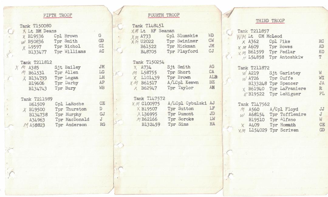

Gary, I found my files
Good News - I have all the files that shows the TANKS and the MEN ASSIGNED to each of the for ‘B’ Troop, 6 CAR on Landing on D Dy
Bad News - ‘Holy Roller” is NOT one of those TANKS
First the info on ‘B’ Troop
