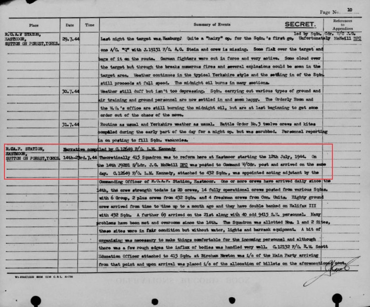

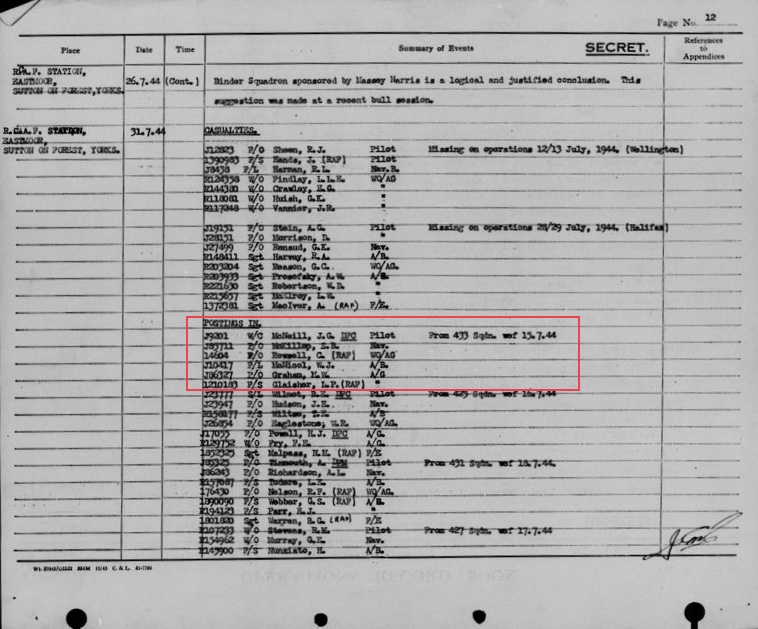

Heather, finally found him. W/C J.G. NcNeil and crew were posted into 415 Squadron in July 1944 and as you can see, they were posted in from 433 Squadron
The first record is of their posting in.......

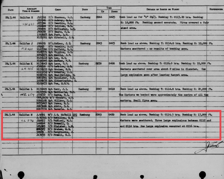

This second record is their first mission.........
I will continue searching and posting up info here
Re: Researching 415 Squadron Operations from January 1944-August 1944
Post by Temujin » Tue Feb 26, 2019 4:22 pm
On this record, you can see the Squadron was “reformed” in July on 1944, and W/C McNeil arrived on the 14th July. It doesn’t say his crew arrived on the same day, but I would assumed they arrived together........

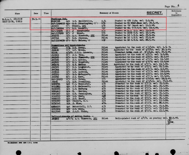

Post by Temujin » Tue Feb 26, 2019 4:50 pm
Still searching......I found this record that indicates that he was posted OUT of the 415 Squadron in 14 Sept 1944, so he was only with 415 Squadron for 3 months........I’ll see what other missions I can find
