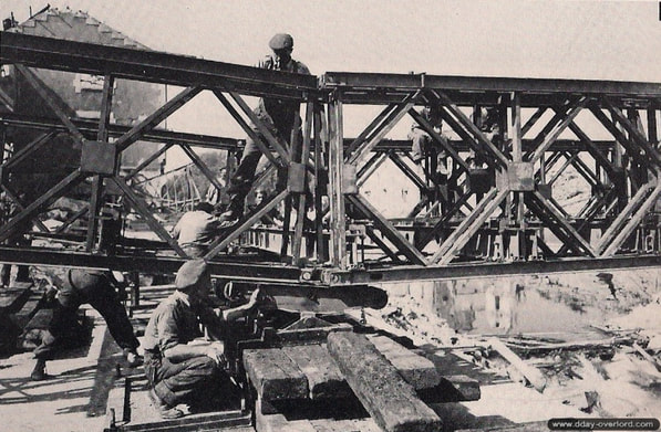

Building a Bailey bridge in Caen,
Normandy. This was called Monty's
bridge. The section on left is the
launching bay and is used to help push
the bridge into position by being higher
than the part that the bridge rests on.

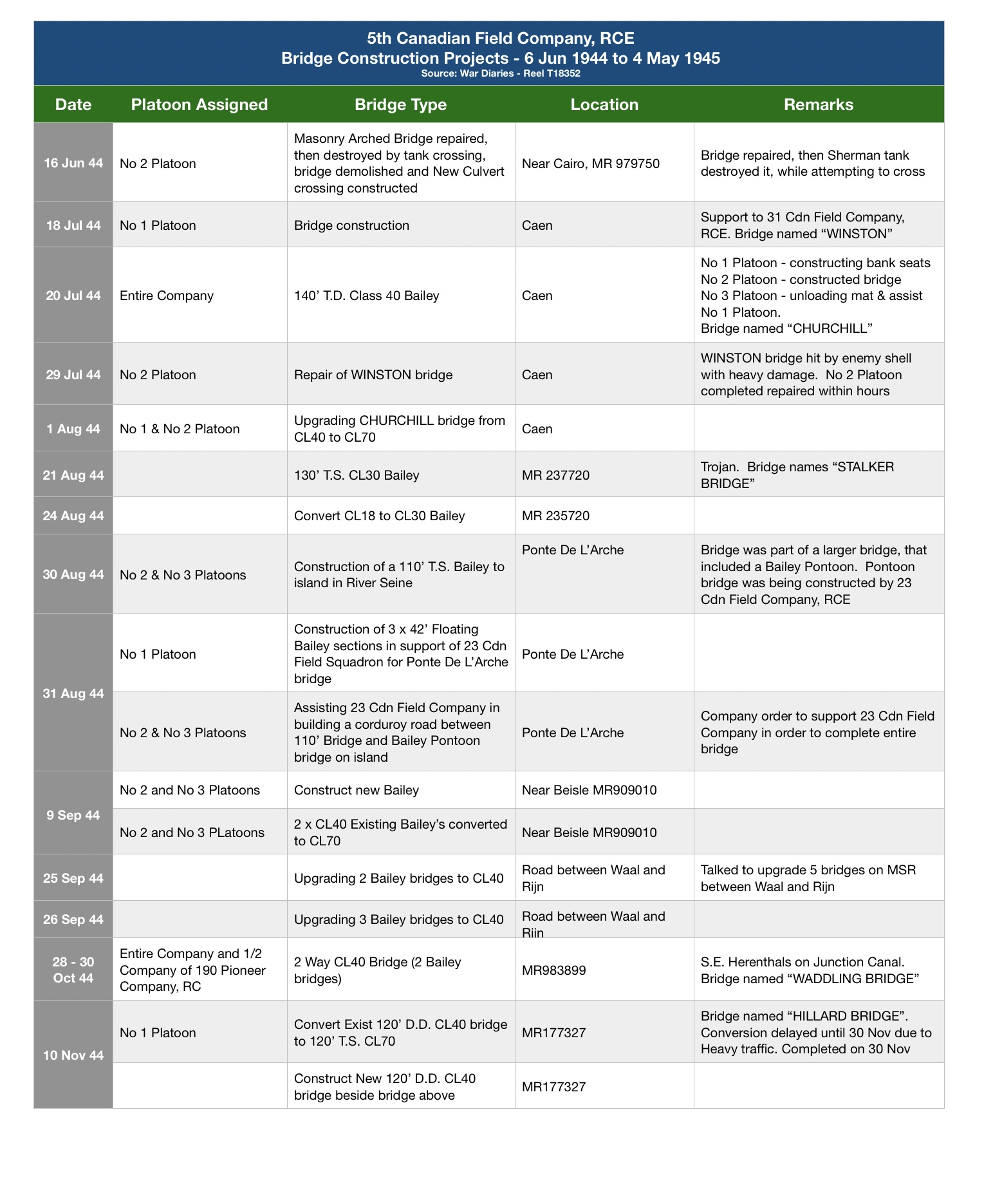

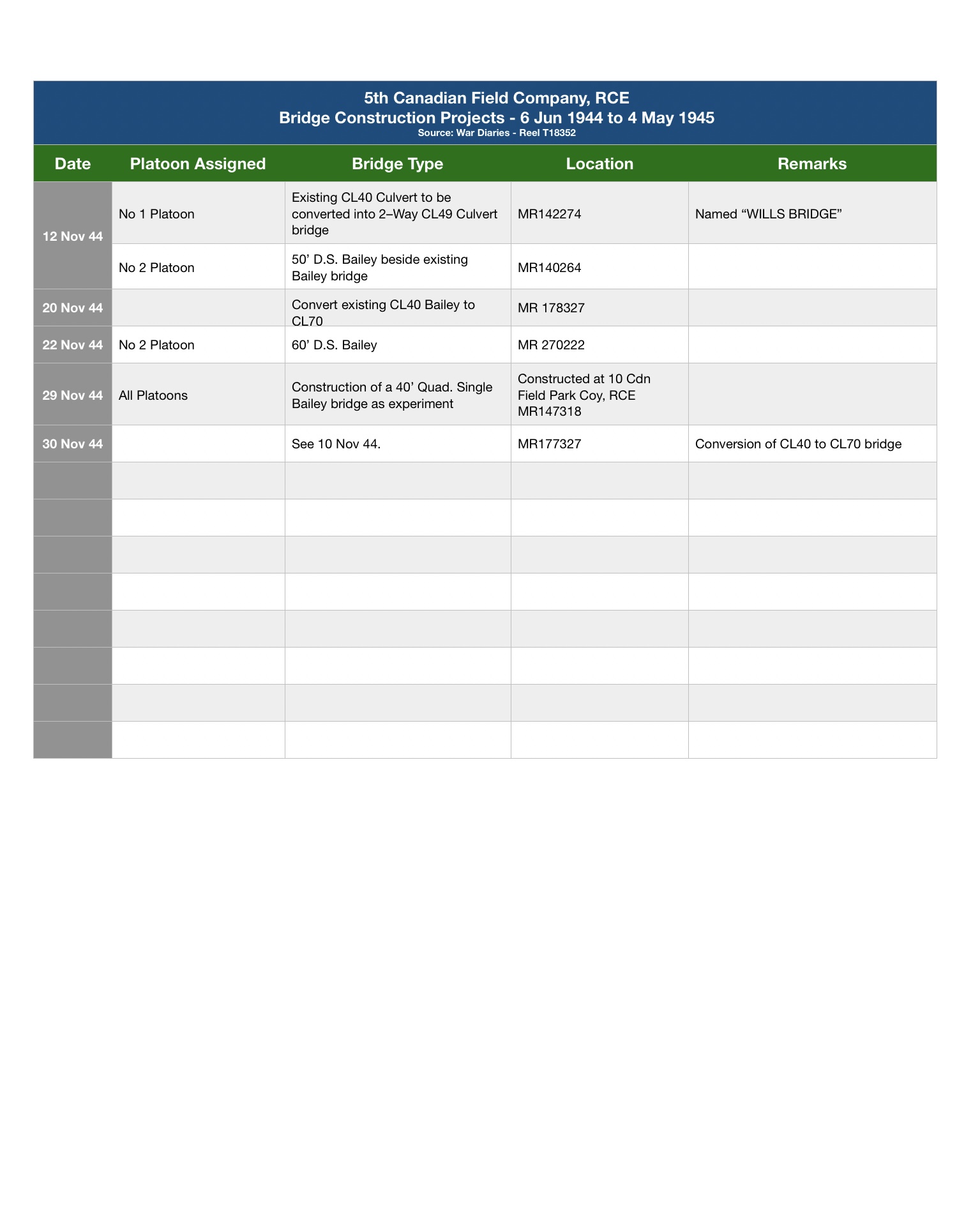

Here are “some” of the bridges they built. Info from their War Diaires. Reel numbers are on this info. Info is available at Heritage Canadiana
