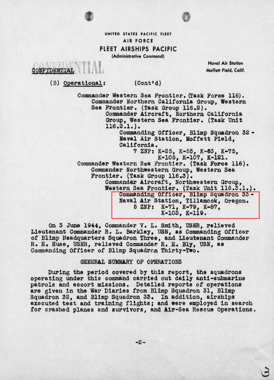

A follow up.
I had found the “war diaries” of Blimp Squadron 33 for Mar, Apr and Jun (their are no diaries for “May”
And in these diaries they list the Blimps that are “on strength” of the squadron......so I figure, the crashed Blimp must be one of the one’s that is NOT on the June List.......maybe
A search of the Blimp No’s came up blank, so I’ll post the documents here so all can look and give me advice or search
MARCH
APRIL
JUNE
So, COULD the crashed Blimp be either K-20 or K-51 or K-83

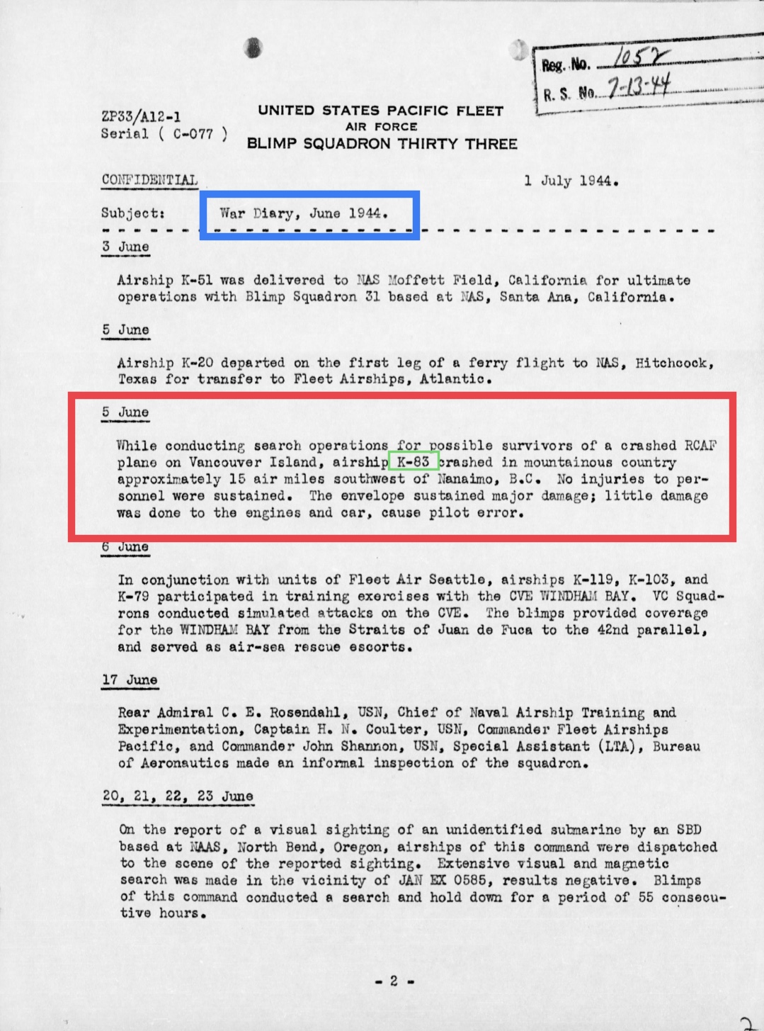

Re: US Navy Blimp Crash, Nanaimo, BC Jun 1944
Posted: Sun Dec 01, 2019 12:01 am
Found the record finally........needed to search using “Blimp Squadron Thirty Three”....NOT Blimp Squadron 33 (which was on all the other records...........
Blimp that crashed was K-83

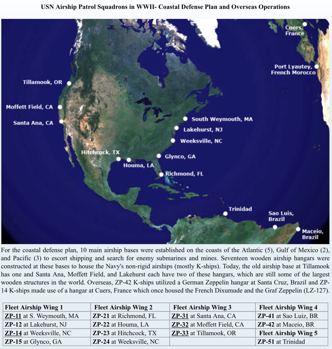

Side Note, map of US Navy Airship Patrol bases during WW2 and a list of Navy Squadrons

Done.
The post in the Chronology will appear under June 1944 as:
5 USN ZP-33, Tillamook, Oregon, blimp K-83 was engaged in a search for missing #5 OTU Mitchell HD345 when it was forced down on a mountain at the 3,000 foot level in a downdraft when low over the terrain 15 miles southwest of Nanaimo, BC, due to pilot error. The airship landed gently with no injuries to the 9 USN crew and 2 RCAF observers on board, or damage to the nacelle. Most of the airship was later salvaged and brought down from the crash site on horseback on a trail cut to the site, and the depth charges destroyed on-site (Research staff at wartimes.ca).
