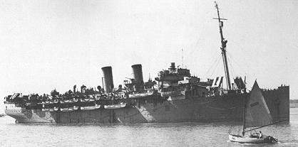

Monowai’s Roll during Operation Overlord Assault Landings - 6 Jun 1944
Monowai was assigned to Operation Neptune, to initially take part in the assault landings by Canadian Troops on Juno Beach - Nan White and Nan Red
The ship was assigned to GROUP 324, 4 LSI Division, and embarked Canadian and other British Troops in Southampton.
Monowai and the other ships assigned to this part of the Assault landings carried the 8th Canadian Infantry Brigade Assualt forces. Below is a list of units assigned to this Brigade

HMNZS Monowai - J30, Ex Armed Merchant Cruiser Razmak. A large and fast cargo liner built in 1924. She was 10,852 tons, 519 foot long and could make 20 knots. She carried ten LCA from 544 Royal Marine Assault Flotilla, nine LCA from 556 Royal Marine Assault Flotilla and a LCA(OC).

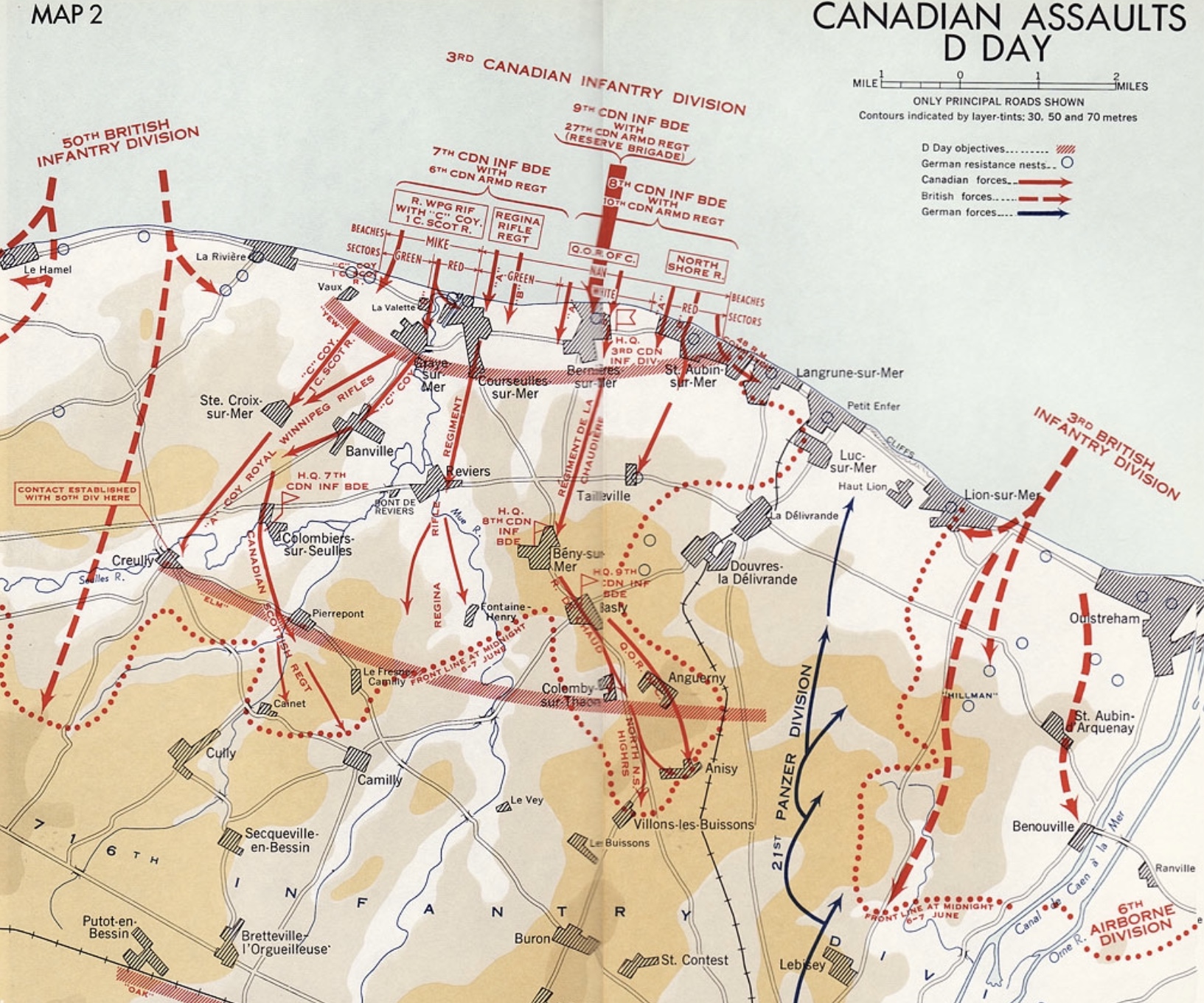

Next is a list of the Assault Beaches and the Canadian Troops that were part of the initial D-Day landings from the Monowai. The list below shows the LTIN Serial numbers assigned to the each of the Monowai Landing Craft Assault (LCA’s) and what troops and equipment were aboard each of the LCA’s from the Monowai. As you can see, these LCA’s and troops landed on NAN WHITE and NAN RED as part of the assault landings.
The Initial assault waves were the Queens Owns Rifles of Canada and the La Regiment de la Chaudiere.

Posted: Thu Mar 07, 2019 9:06 pm
The map below shows Juno Beach Landing area, and the troops assigned to each section of the beach
