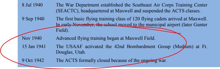

Having looked through some other (A) military abbreviations (Armoured, Active, Air, Advanced, Army) I'm beginning to think that in this case it stands for
Advanced. Advanced flight training began at Maxwell in 1940.
Page 12
- AdvancedFlightTraining.JPG (44.28 KiB) Viewed 44963 times
