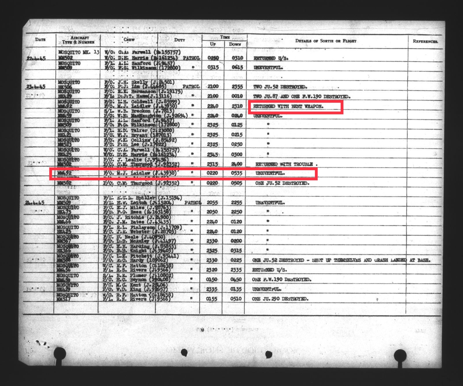

Been doing a bunch of research on Mosquito aircraft mishaps and such and I came across a term they seem to have used a lot … Example,
23-APR-1945
409 (Nighthawk) Sqn RCAF
Mosquito, MM492
T/o 22:40 hrs to patrol.
Returned with bent weapon
. Landing 23:10 hrs 23.4.1945
I have come across quite a lot of missions that were aborted due to "Bent Weapons", anyone have a clue what they are talking about ????

The “clue” George is the Mosquito you have quoted, was MM492, which was a Mosquito NF XIII model. A “night fighter”......so was “armed” with the airborne radar to track enemy aircraft. A “bent weapon” was the term used then to indicate that the “radar system had failed”.....which meant they couldn’t track enemy aircraft in the dark because their main “tracking weapon” was broken.
Other phrases they used at this time were:
’Flash your weapon' was the instruction given over the R/t (sometimes by a Waaf!) to use airborne radar. 'Bent weapon' indicated yet another failure!
Here’s the record on that aircraft for you
