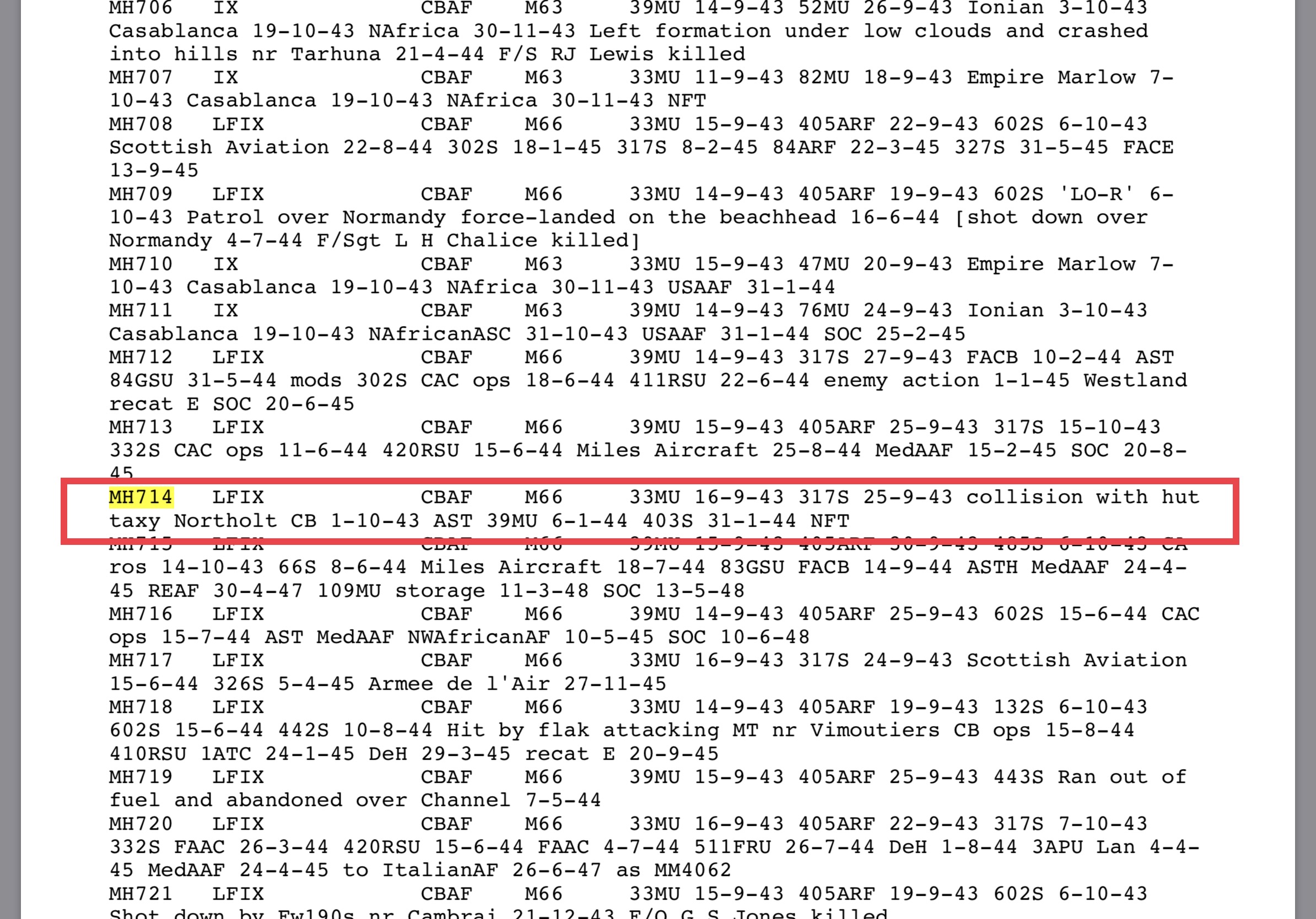

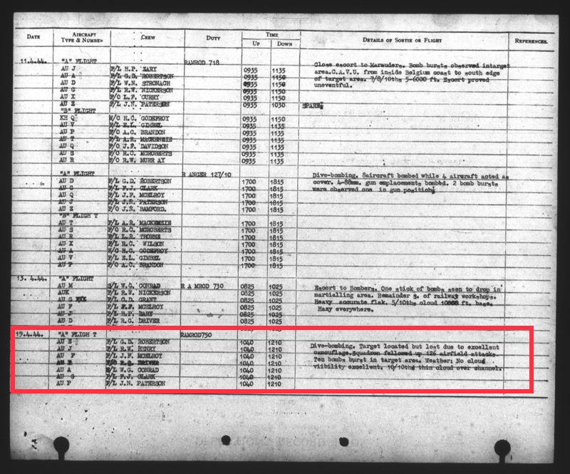

#1) Spitfire MH714, some pages say that Flt Lt R.W. Henry, 421 Squadron was shot down had to bail out and became a P.O.W., another says it was with 317 squadron, had an accident running into a hut, sent for repairs and was then sent to RCAF 403 Squadron

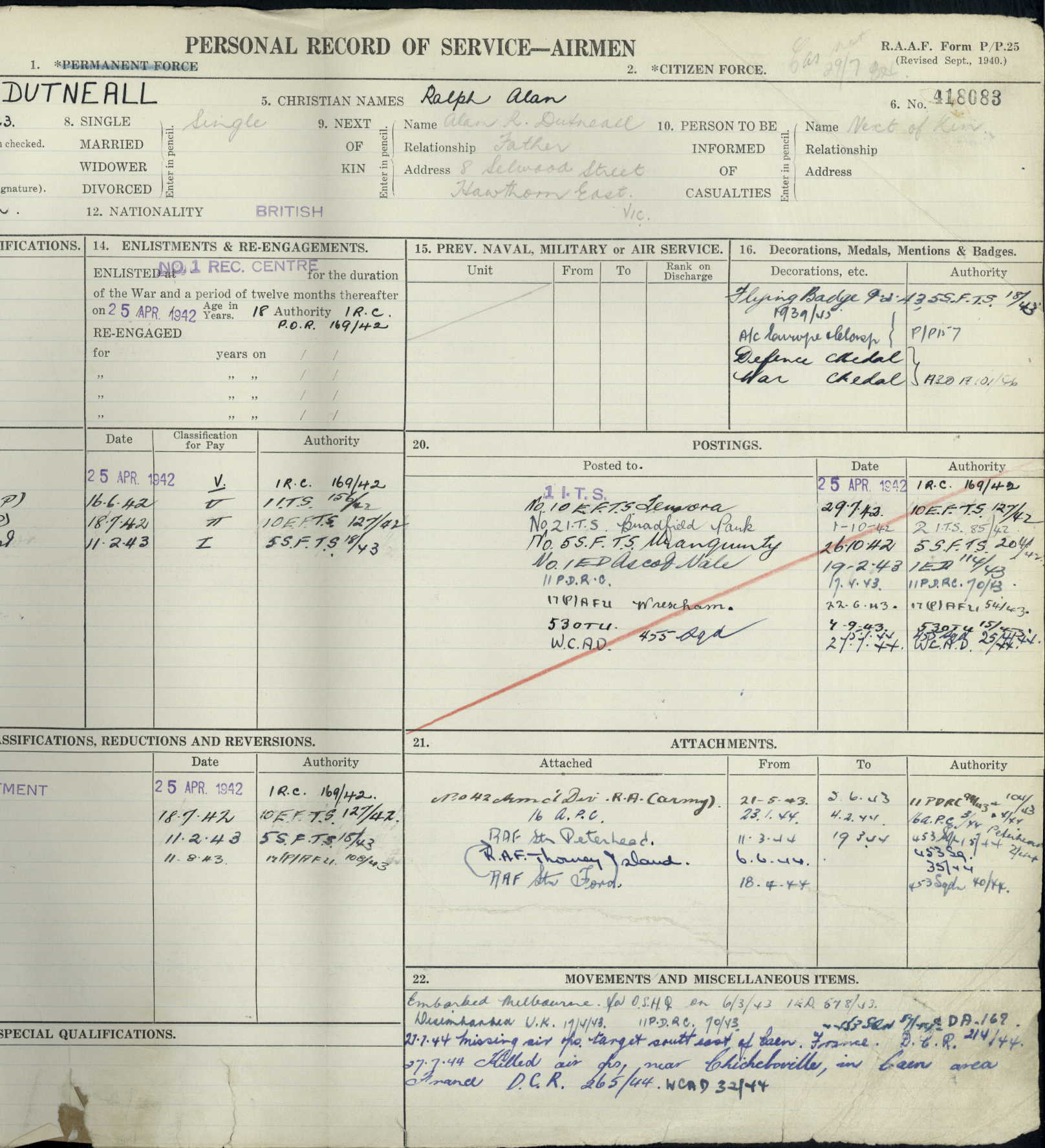

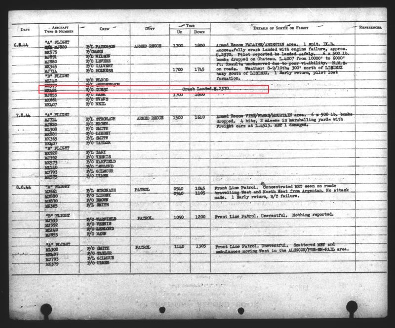

#2) Spitfire MK421, some pages say that W/O D.N. Guest, 421 Squadron was flying a recce mission when it was shot down and he became a P.O.W. and another site says it was with RAAF Squadron 453 when it was shot down killing the pilot Flt Sgt R.A. Dutneall

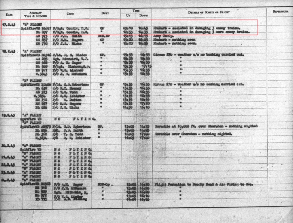

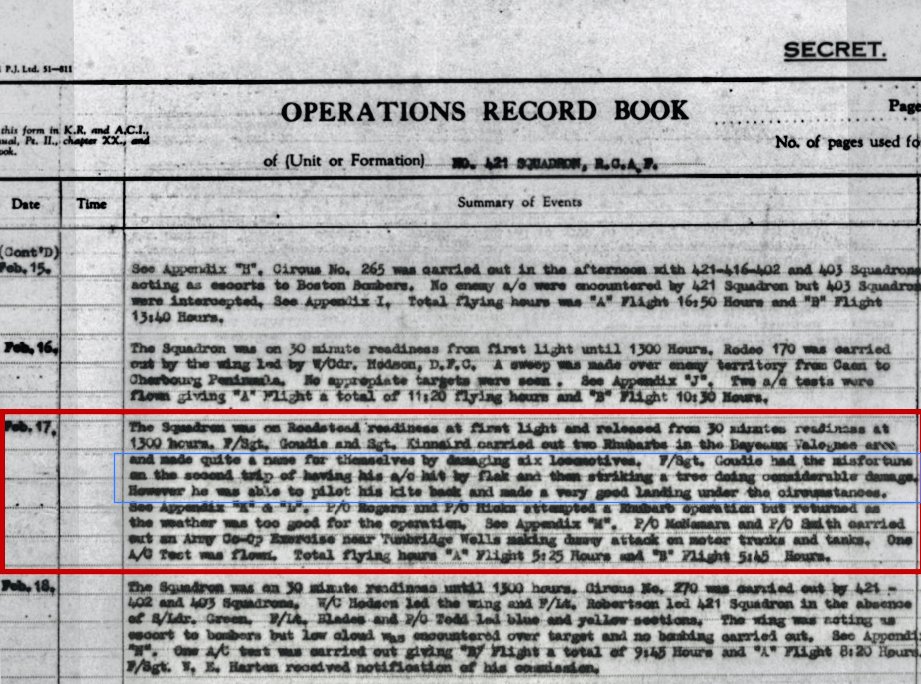

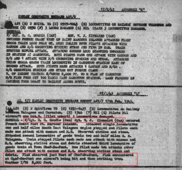

#3) Does anyone know what the serial number of the Spitfire was that Flt Sgt D.C. Goude was flying on February 17, 1943, he was flying a Rhubarb Mission when the aircraft was damaged
Would appreciate if someone can head me in the right direction on these !
Aircraft BL897

I am showing for Flt Lt R.W. Henry, it was on May 19, 1944

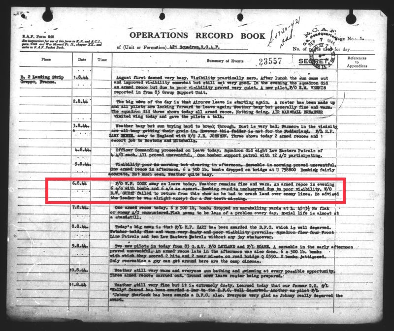

This one took me a while to figure out.....found D.N. Guest and 421 Squadron, RCAF records.......and then had to find 453 Squadron, RAAF and found this on the British National Archives. And examined all the different records on line.....
And this is what I discovered......and the records on line that show both Squadrons flying the same aircraft are INCORRECT
The correct record is that WO D.N. Guest, of 421 Squadron was flying MK421 and was lost with that squadron. Here are the records:
So MK421 crashed while with 421 Squadron, RCAF

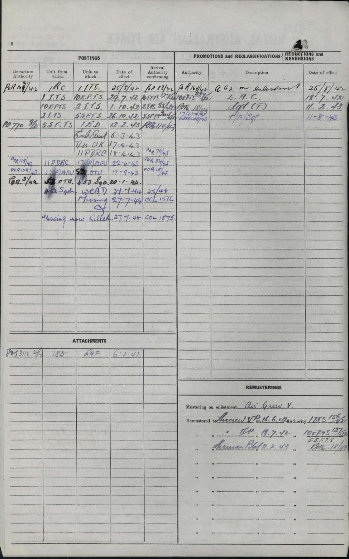

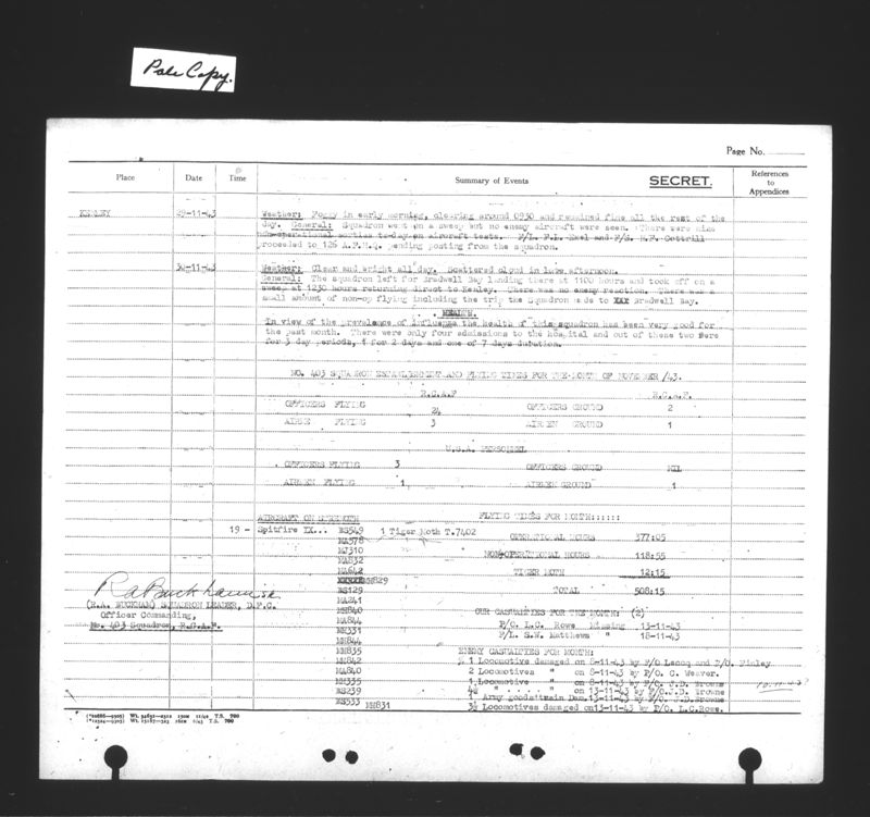

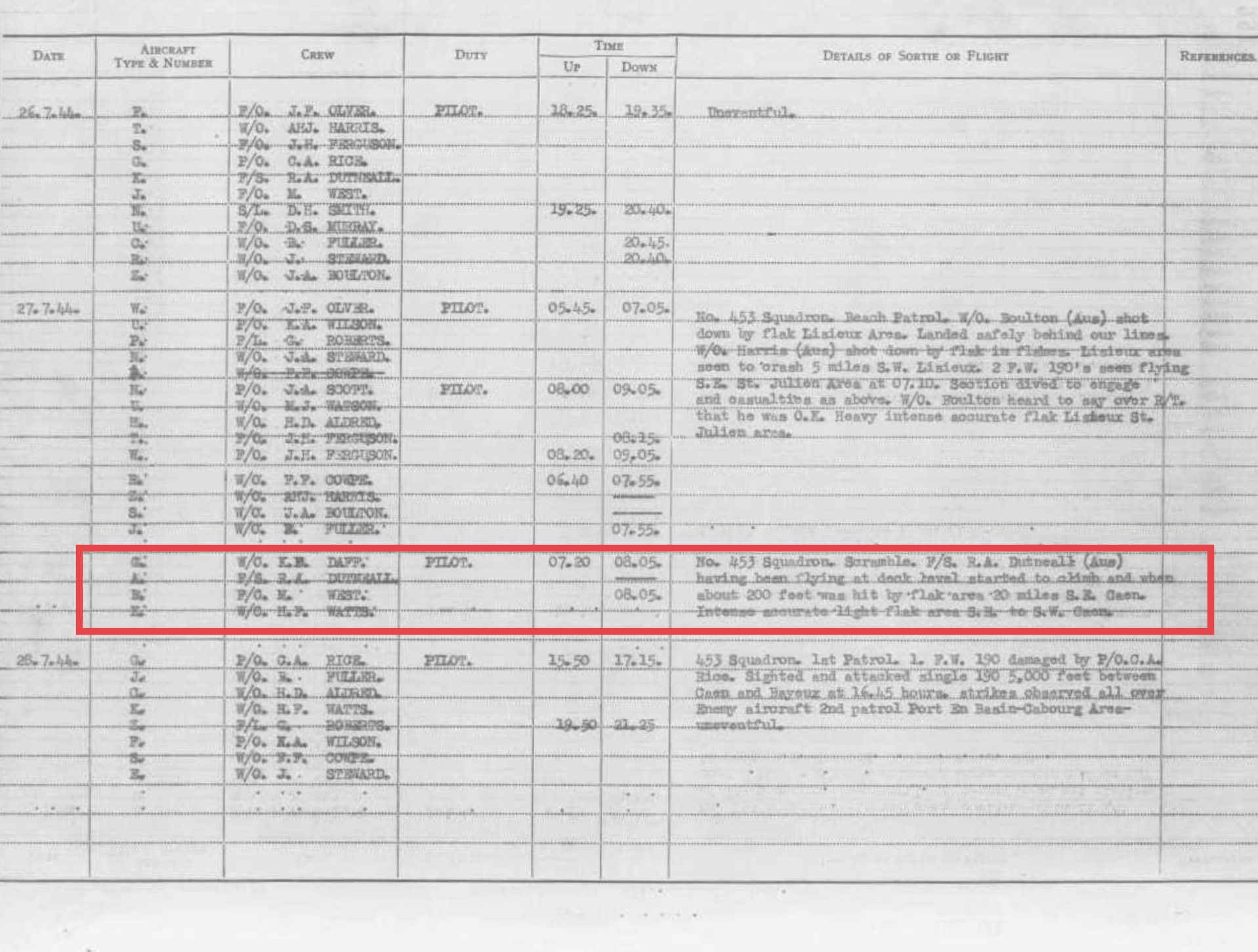

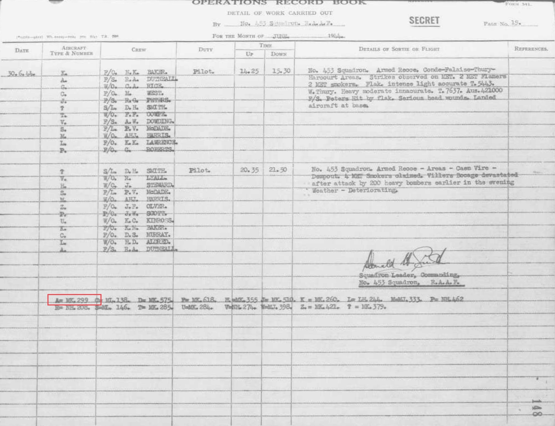

So, Now about 453 Squadron, RAAF and Flt Sgt R.A. Dutneall. The records show clearly that he was flying MK299 when he crashed. Records are below......the issue with these records, is that they just listed the aircraft by its Letter Code......which in this case he was flying Spitfire “A” of that Squadron. Luckily they posted at the END of each months records, the aircraft number for each Letter Code.......so Spitfire “A” was MK299
And MK299 went down with 453 Squadron, RAAF
I’ve also added Flt Sgt Dutneall’s partial records

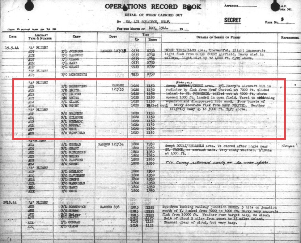

This one is harder.
This is what the “Spitfire Production List” indicates

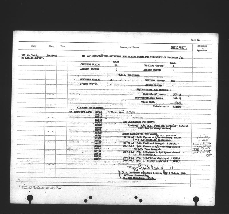

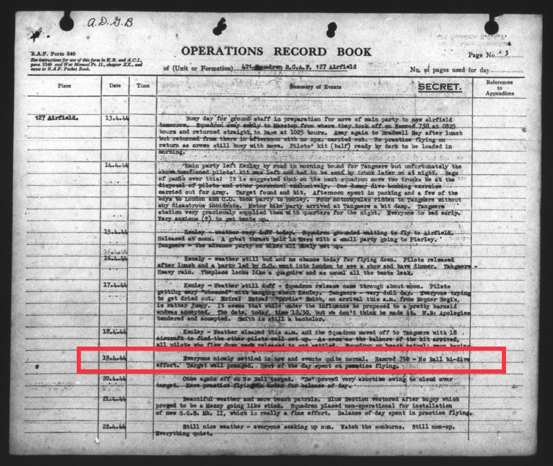

Then I went to 421 Squadron records indicate that Flt Lt R.W. Henry was NOT shot down on the 19 May 1944

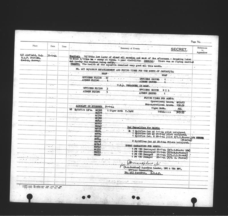

Then I went to 403 Squadrons records
In the month indicated on the first record (Spitfire production List) and in the 3 months previous, the aircraft if NOT listed on strength
So I don’t know what happened to this aircraft

Temujin, the paper work that you had put on for RCAF 421 squadron was from April 19, 1944, (19-4-44) records that I have said he bailed out May 19, 1944. (19-5-44) if available. Appreciate you shedding light on the other two Warriors.
Re: Need help, Spitfires, RCAF, 421 Sqdn
Posted: Sun May 12, 2019 1:22 am
Sat May 11, 2019 11:34 pm

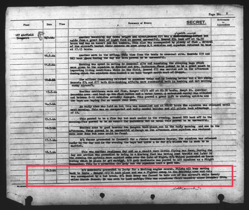

Sorry, must have been tired.......I’ll take a look at May and post up what I find
Posted: Sun May 12, 2019 1:33 am
Sorry George.......here’s the correct page and he DID bail out that day.......but not sure what the aircraft number was........I’ll look more tomorrow
