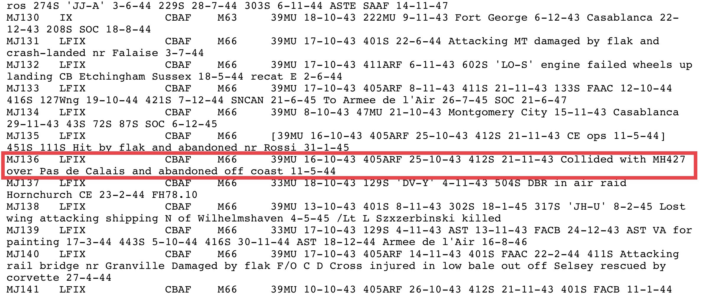

Researching RCAF 412 Squadron I came across 2 incidents where Spitfire MJ136 was lost in crashes, I looked at "Aircrew Remembered" and "Spitfire Pilots and Aircraft" with no help, both pilots are from RCAF 412 Squadron, I have:
F/O J.S. Hamilton RCAF, on 11 May 1944, with a mid-air with MH427 over Pas-de-Calais, France both pilots rescued
and
P/O D.R.C. Jamieson, RCAF on 10 June 1944, aircraft crashed over Tilly-sur-Seine, France
I am sure one of them is a typo ! any help would be appreciated !

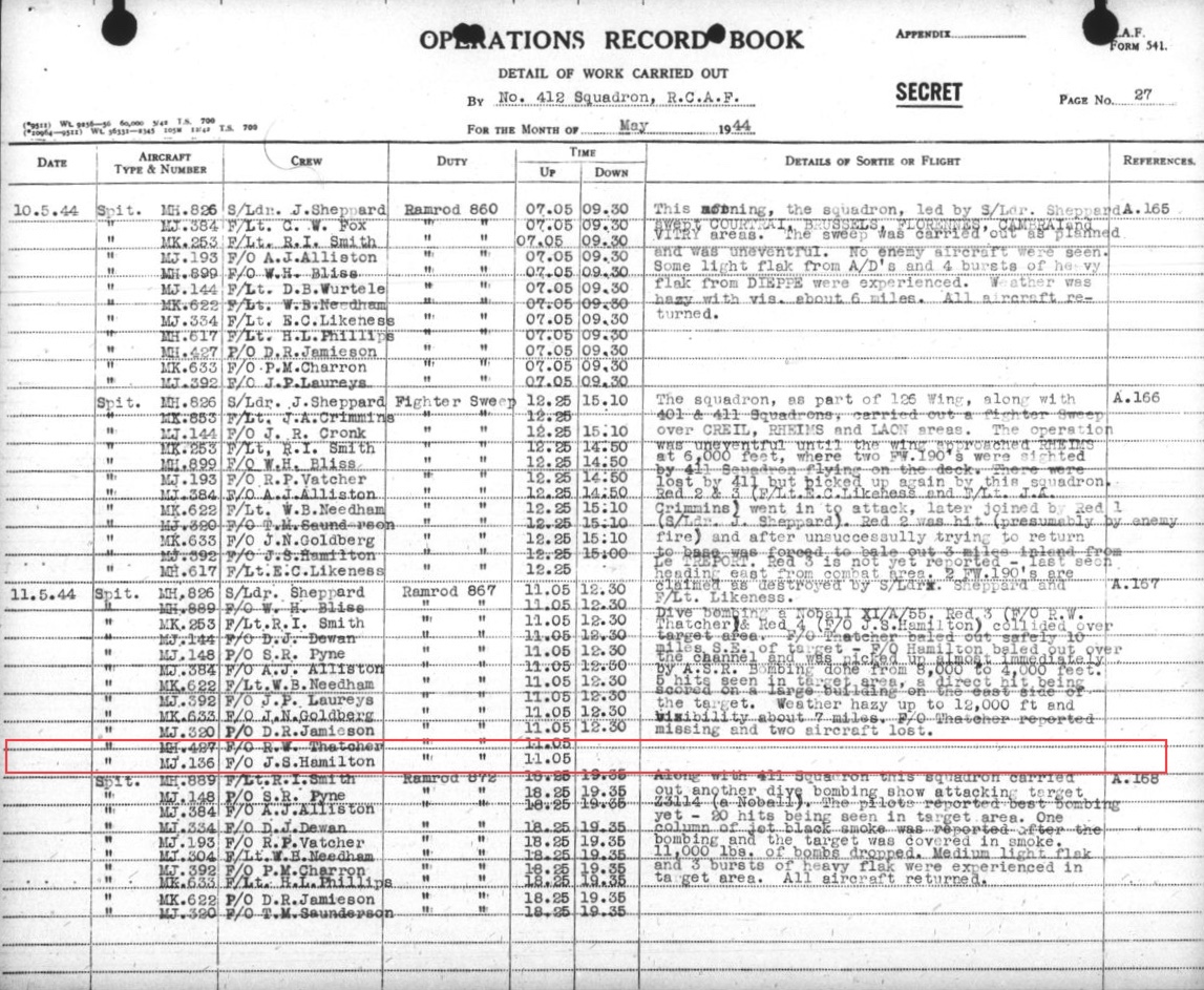

NOTE: George, checked thru the records BEFORE this crash and MJ 136 shows up multiple times......so this records seems correct

Thu May 02, 2019 12:45 pm

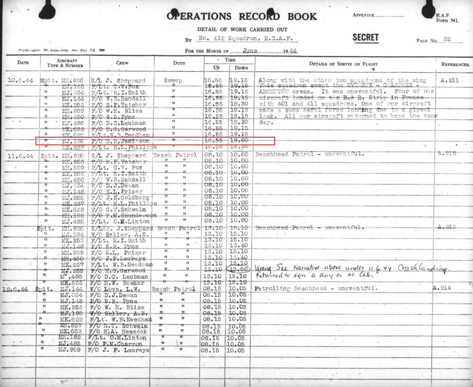

NOTE: George, checked thru the records BEFORE this crash and MJ 136 shows up multiple times......AND so this records seems correct ALSO, Not sure whats going on

Posted: Thu May 02, 2019 2:14 pm
Spitfire production list shows it was involved in the “mid air”
Source: http://www.airhistory.org.uk/spitfire/_prodn%20list.txt

Posted: Thu May 02, 2019 2:26 pm

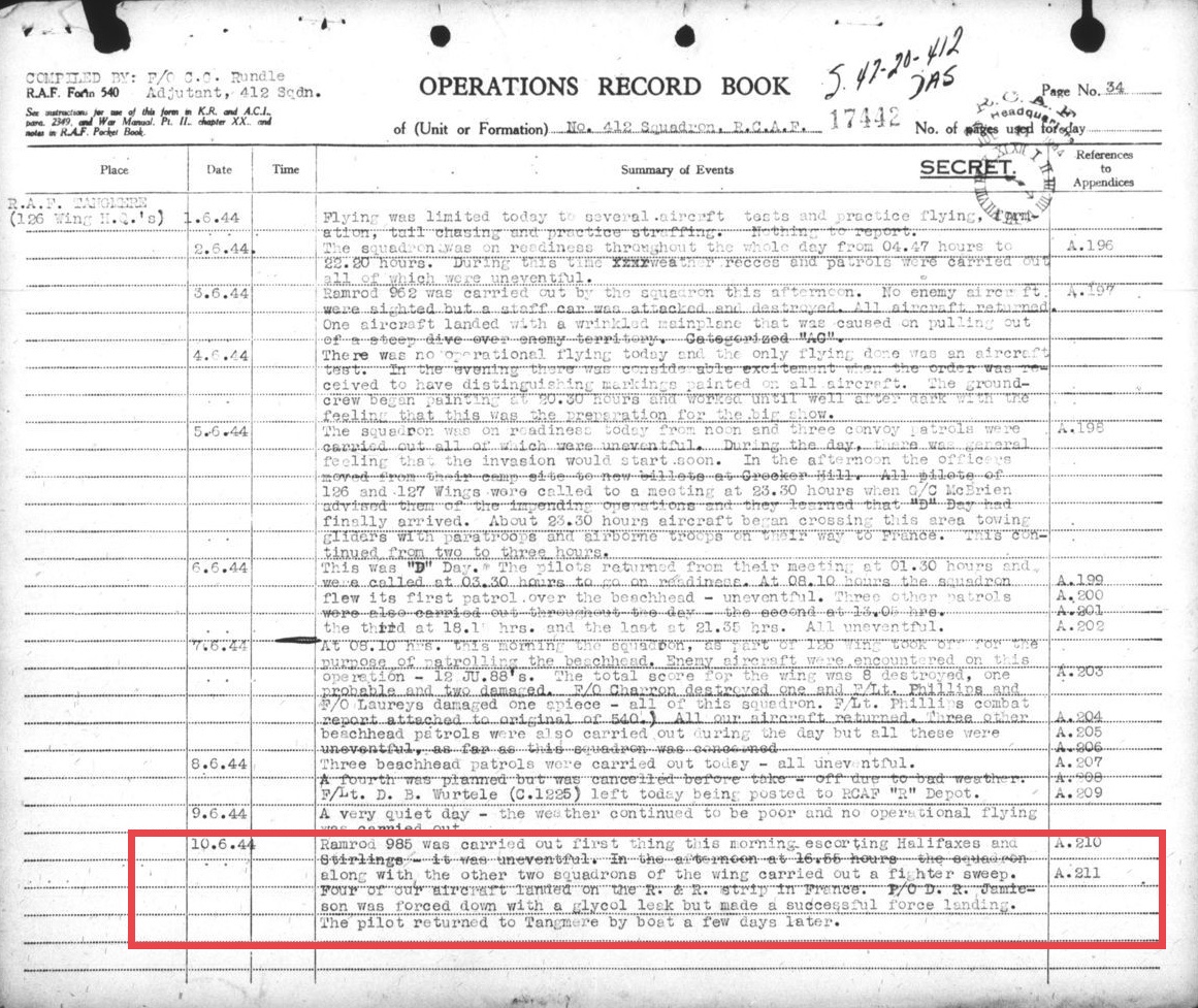

So, I’ve looked thru the records....and MJ 136 shows up in BOTH months.......and being flown BEFORE each of the ‘crashes”........so if its a “typo”....the typo’d many many times........
At first I thought that maybe it made it back on the first “crash”........and it ALMOST did, but the pilot “bailed out” when reaching England (or just before).......so I don’t think the recovered the aircraft, repaired it, and flew it the next month......
So, this IS a mystery George

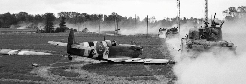

Note of interest George, if you look down the record I posted previously, you will see aircraft MJ255 crash landed the next day on the 11th Jun (I thought this may have been the confusion......but it’s not).
I found a photo of this aircraft after it crash landed........just for interest
Supermarine Spitfire Mk. IXE (Serial No. MJ255), coded VZ-S, No. 412 Squadron, RCAF, Tilly-sur-Seulles, Normandy, crashed on 11 June 1944, photo taken on 17 June 1944

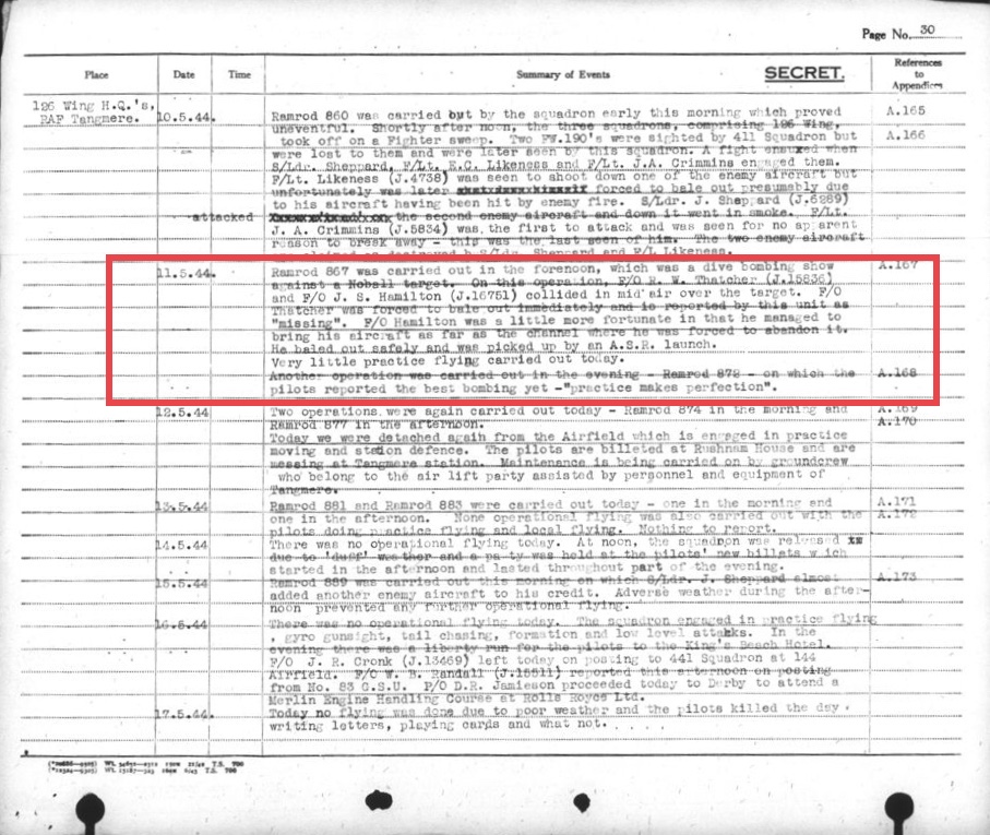

Thu May 02, 2019 1:43 pm

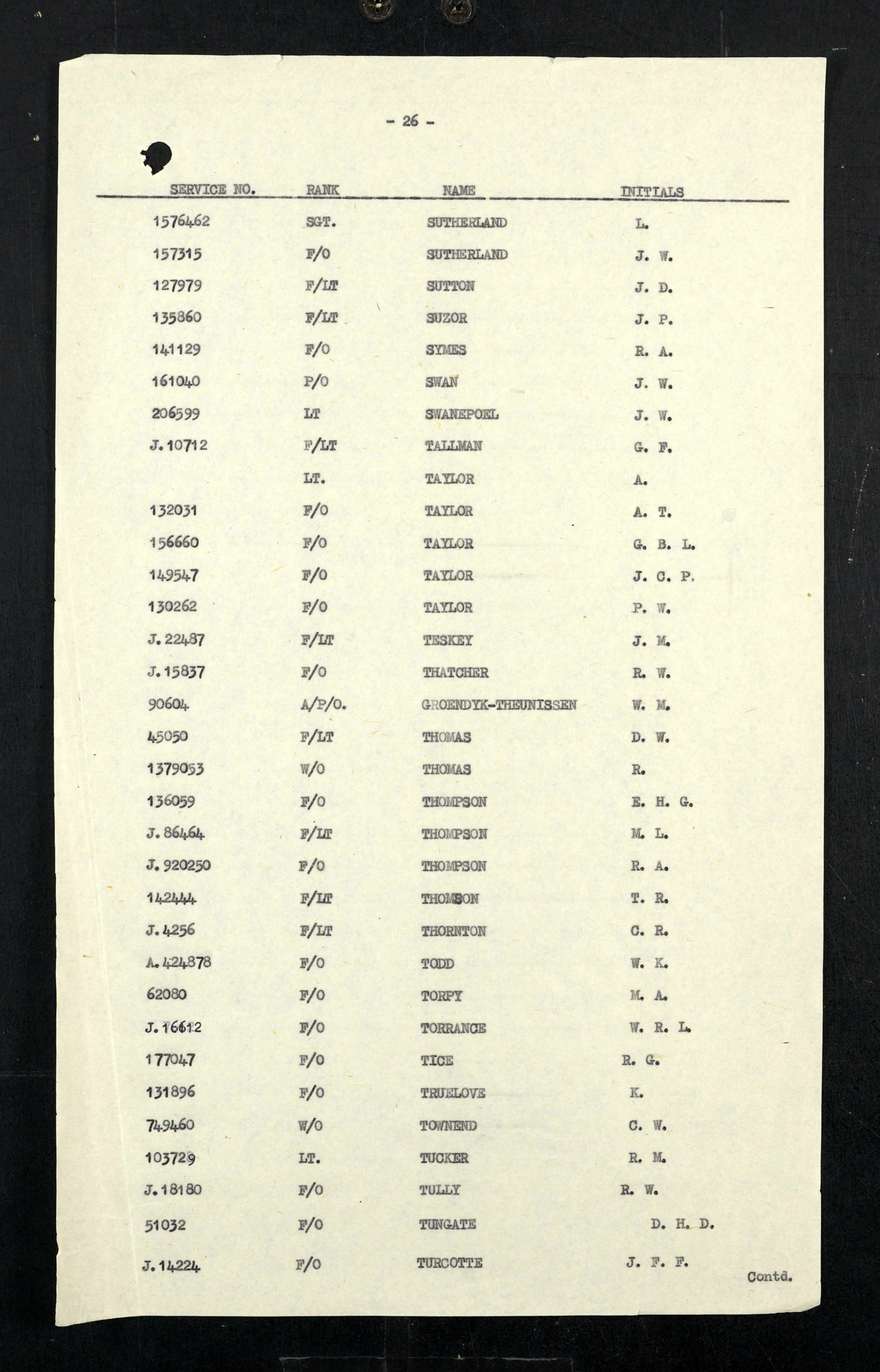

Another note of interest, F/O R.W. Thatcher, the pilot of the second aircraft that collided, was captured and a POW
POW No 5840. F/0 Thatcher, R.W. J15837
Name: R. W. Thatcher
Rank: F/O
Military Date: 1939-1945
Service Number: J.15837
Source Description: 1490: Stalag Luft III (Belaria): Nominal Roll of POWs and Recommendations for Meritorious Work

Posted: Thu May 02, 2019 9:06 pm
by georgetanksherman
Yeah, that was my dilemma, how can an aircraft be in a mid-air collision, pilot abandon the aircraft over the channel and then 30 days later, the aircraft be back up in the air and have a forced landing due to a glycol leak ????
