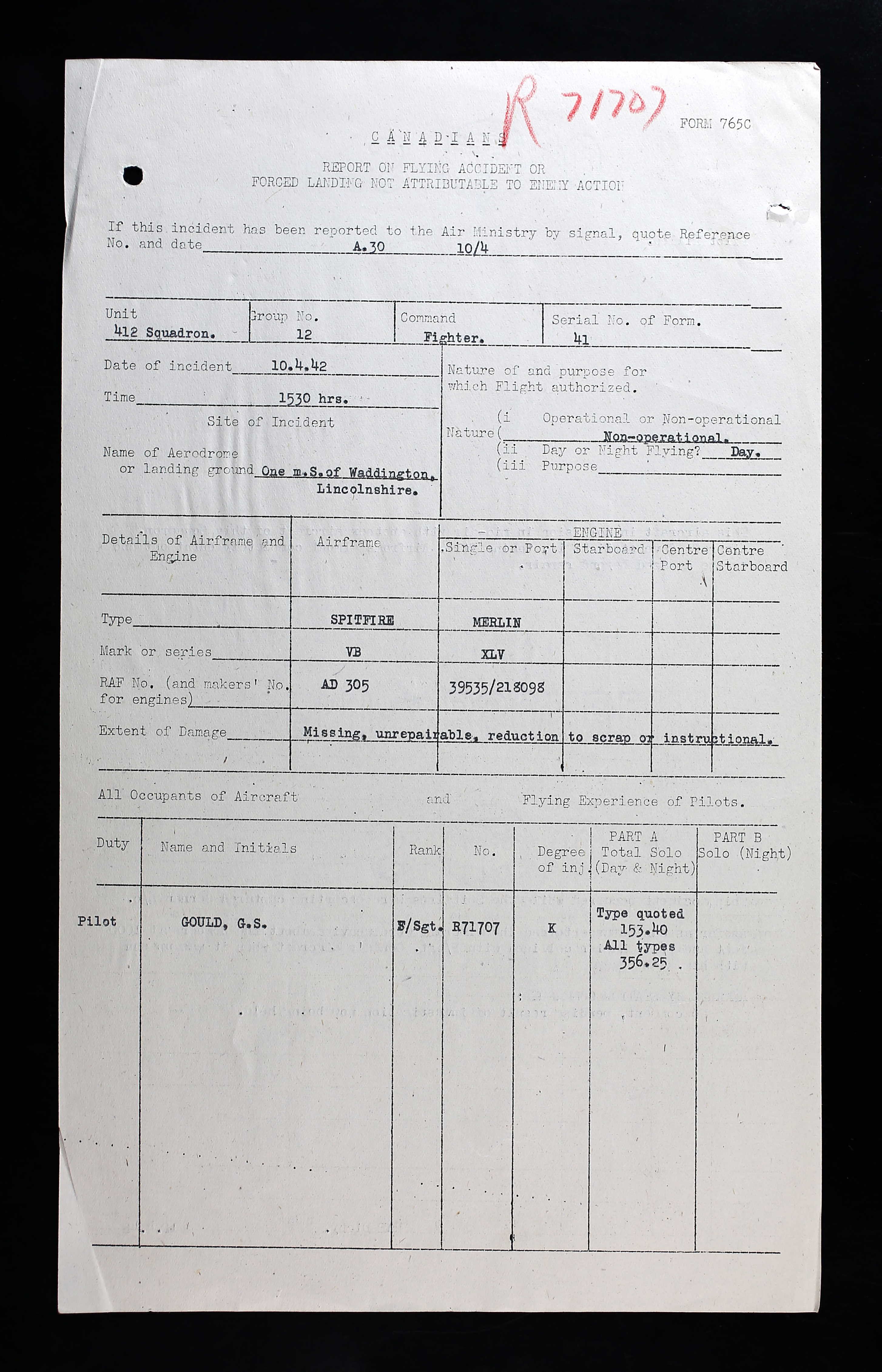

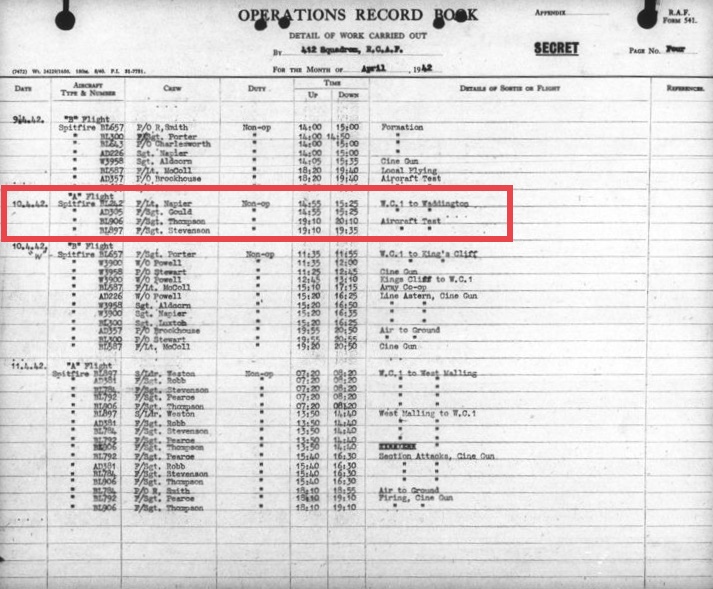

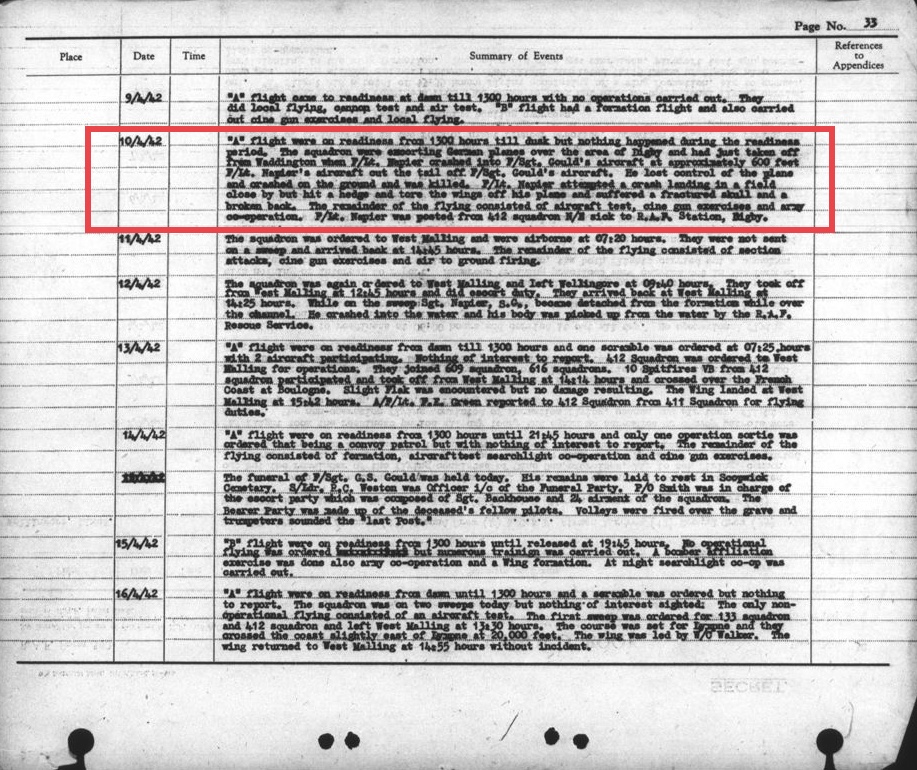

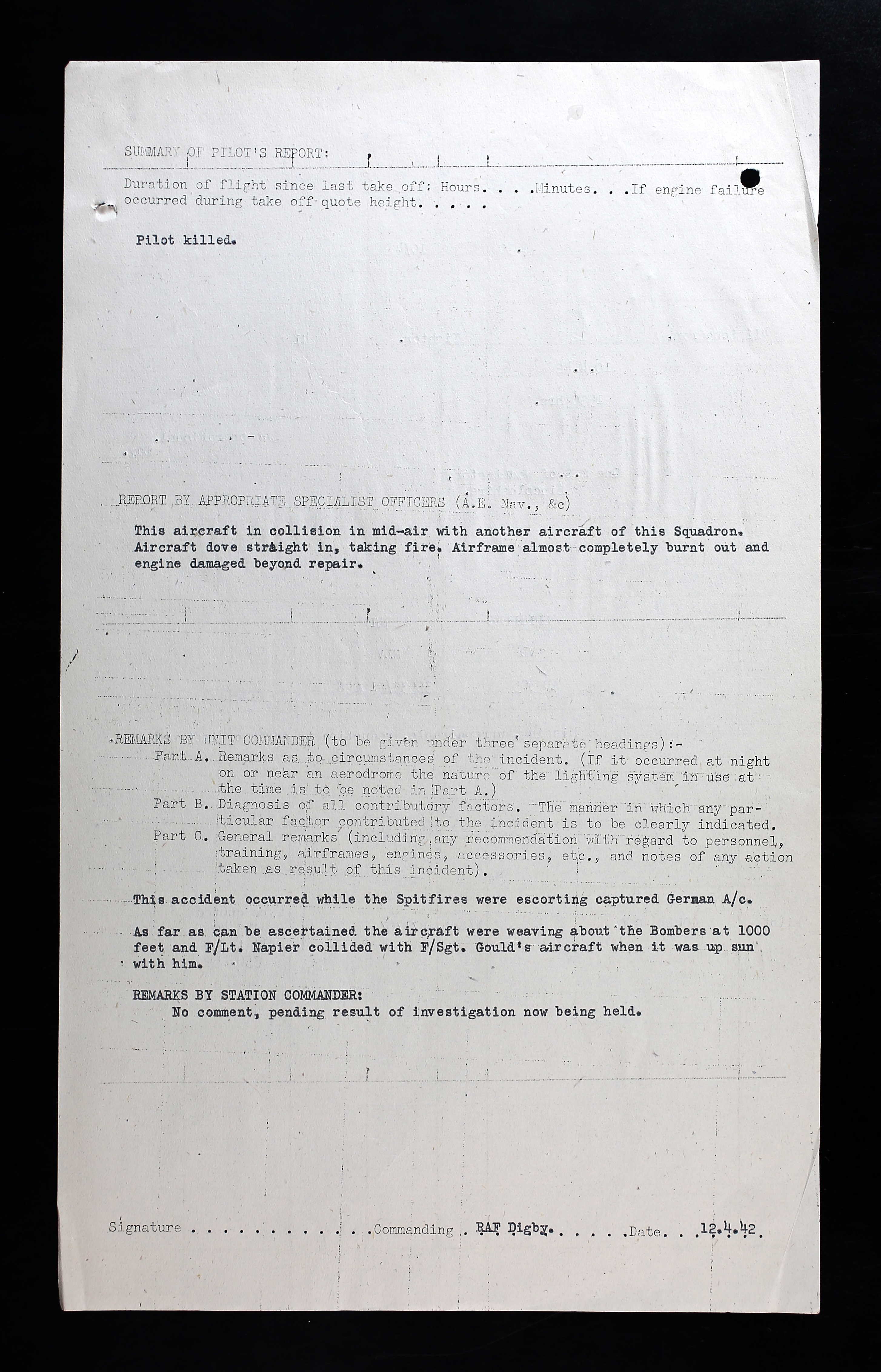

I’ve been trying to put together a bit of history on him and my grandfather Jack B. Gould who was also RCAF fighter pilot in WWII.
I’ll try to attach the info I found in George’s file regarding his death.
All the best,
Beth
