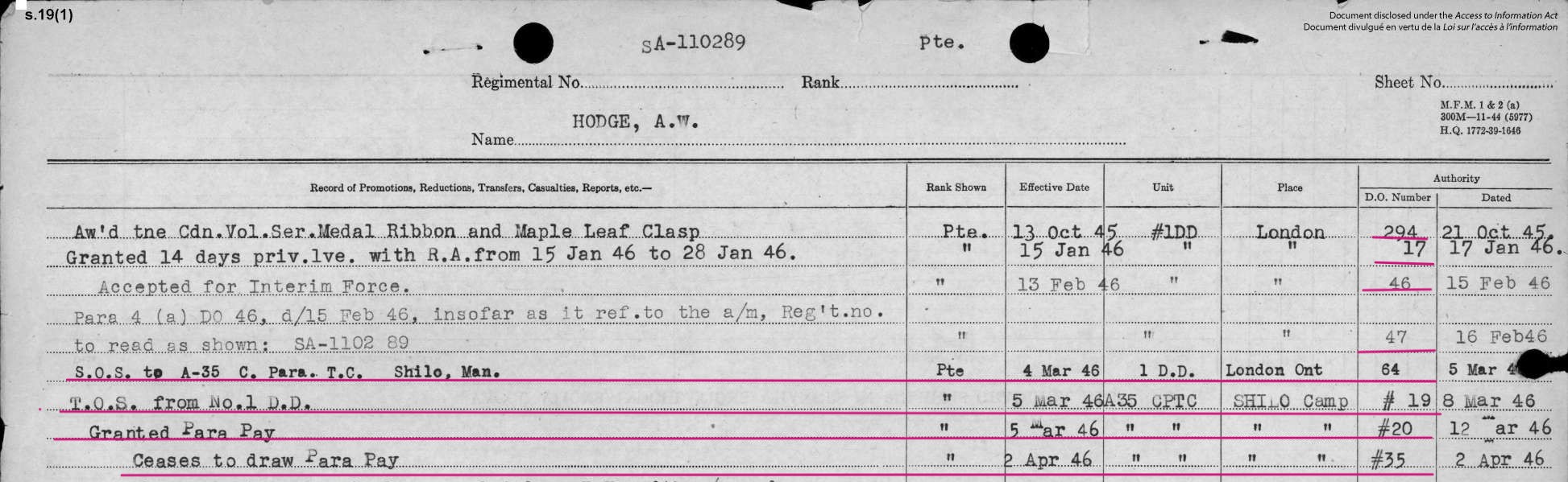

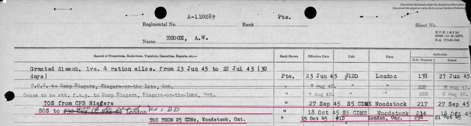

Was wondering if anyone could help. I was hoping i could find the Daily Orders Part ll for the "S-5 Driving and Mechanic School" in wooodstock Ontario, during the war years. I'm specifically looking for the time from Sept. 27th 1945 to March 1946. My Uncle was a paratrooper and when they were disbanded in Niagara of sept. 1945, he ended up in S-5 Driving and Mechanic School (S5 D and M S). I found the DO"s ( Daily Orders) that sent him there but nothing after(1st Canadian Parachute Battalion). The School closed up in March of 1946 and as it looks like on his Service Records he was returned ( at least on paper) to the paratroopers, but they had been disbanded.
Daily Orders?
Woodstock Daily Orders.jpg (267.24 KiB) Viewed 24035 times
Woodstock
Niagara to woodstock.jpg (241.12 KiB) Viewed 24035 times

This information is very interesting and helpful. Thank you for answering. I believe it is spurious as you indicated. When i found the part ll daily orders I was able to match up the dates with my Uncles Service Records. That is when he was with the 1st canadian parachute training battalion but nothing after. Ive been attempting to follow in his footsteps and write up his story so family members can remember what he had to sacrifice at this time in the world so we could have what we have now. Thank you again for this information.
