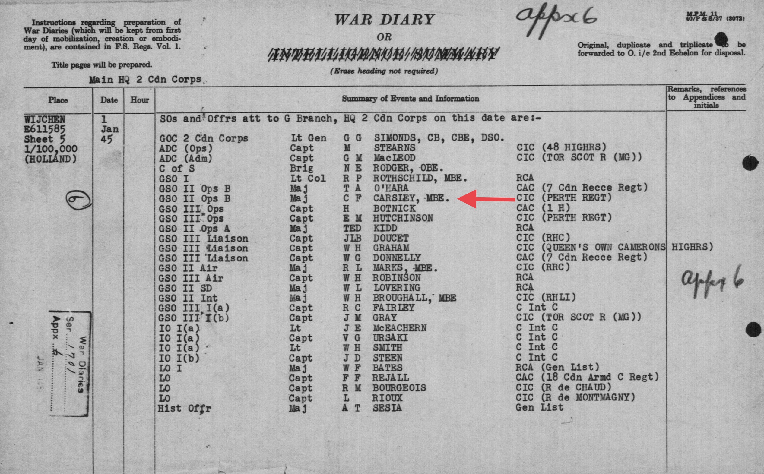

First, his his LAST NAME CARSON??? And could it be MAJOR CARSON?? Or are you quite sure on the name?? And you said HQ 2nd Canadian Corps, how do you know this??? And WHERE in France in 1944 did he leave it (LOCATION)
All this could be clues.

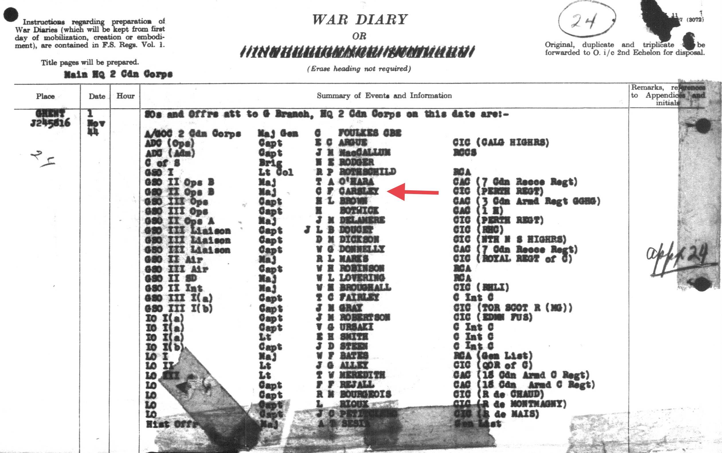

I”m looking thru the War Diaries of the HQ’s 2nd Cdn Corps, and I just picked a “random date” (1st Nov 1944) and so far all I found was a “MAJOR CARSLEY”
I”ll keep looking for you, but could you confirm the info above, and may help in my search
Re: MAGORS Carson - HQ 2nd Canadian Corps
Post by Temujin » Sun Jun 18, 2023 8:49 pm
Here’s their Officers for 1 Jan 1945, still the only person “close” is Major CARSLEY

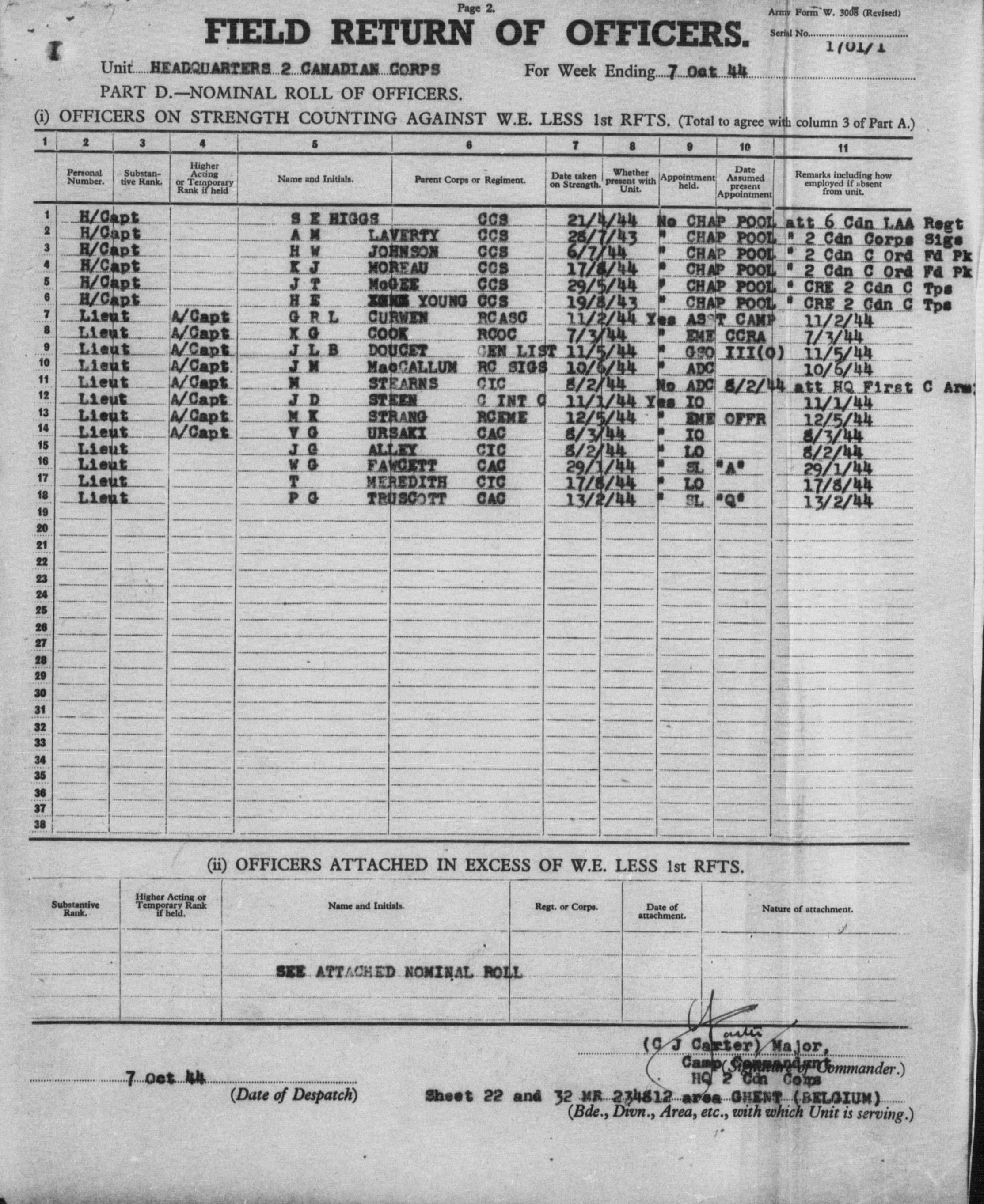

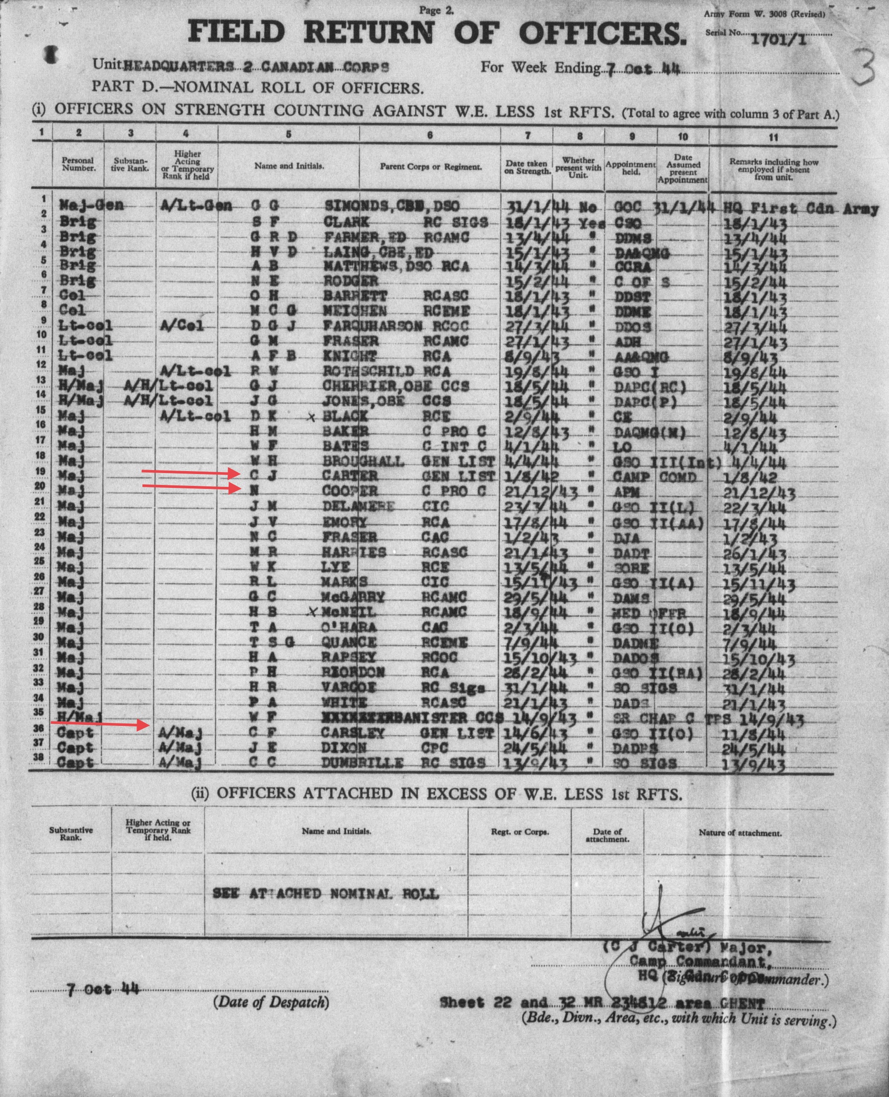

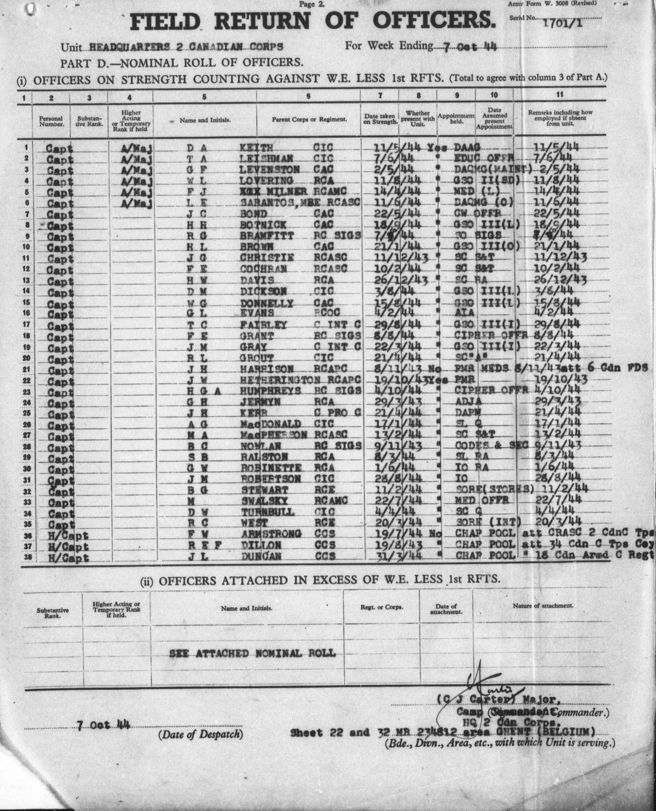

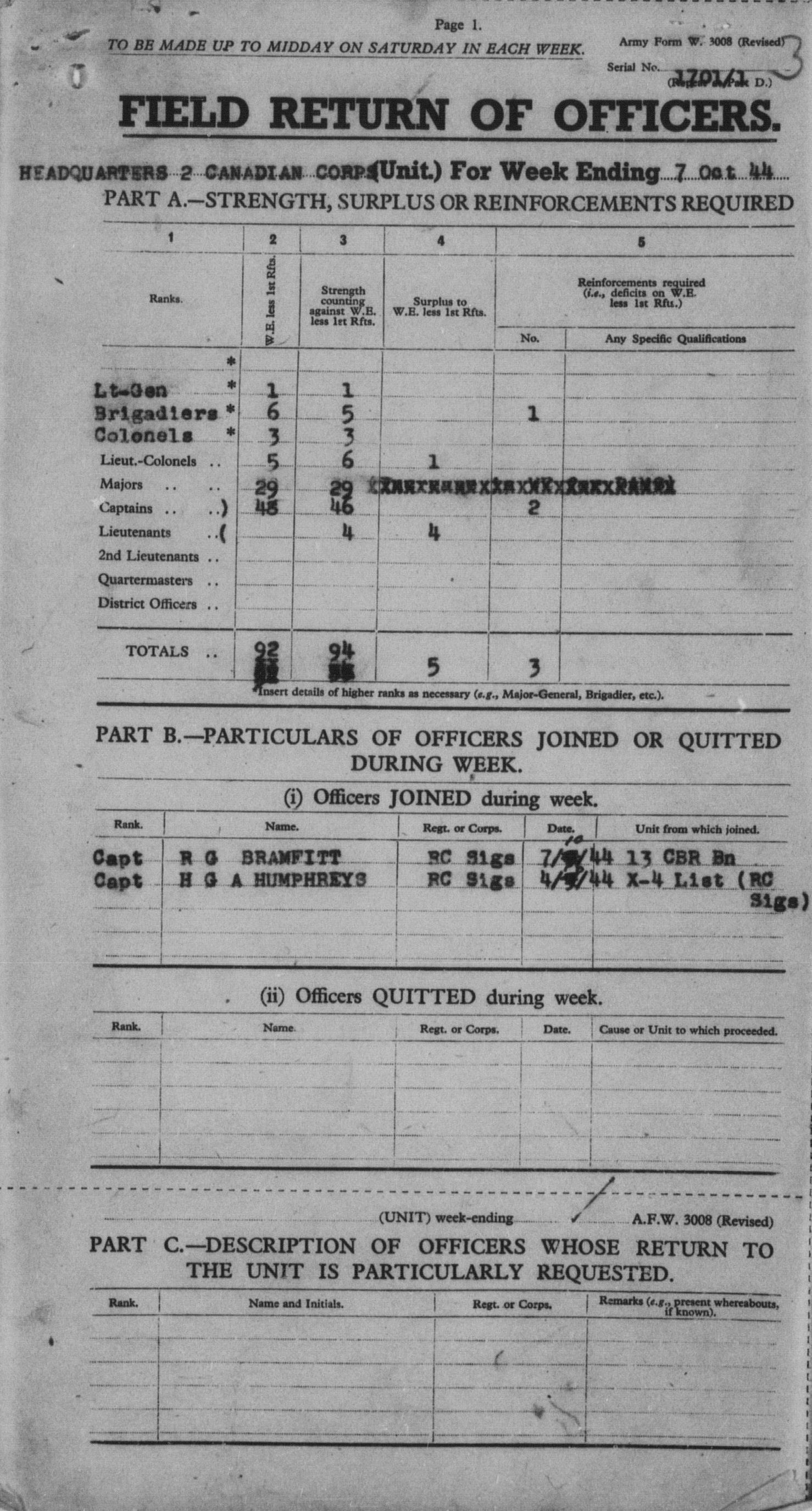

Now I tried the 2nd Cdn Corps, Asst Adjutant & Quartermaster General Was Diaries
His diaries list “every” Officer employed in the Corps HQs (the first files I sent you list only Officers at Corps Main HQ)
Again, 3 name that start with ‘C’……but not sure if this is anything closer………date is 7 Oct 1944

Thank you. Yes, very hard to read…….but I do believe it was MAJOR CARSON, which is on the documents that I found above.

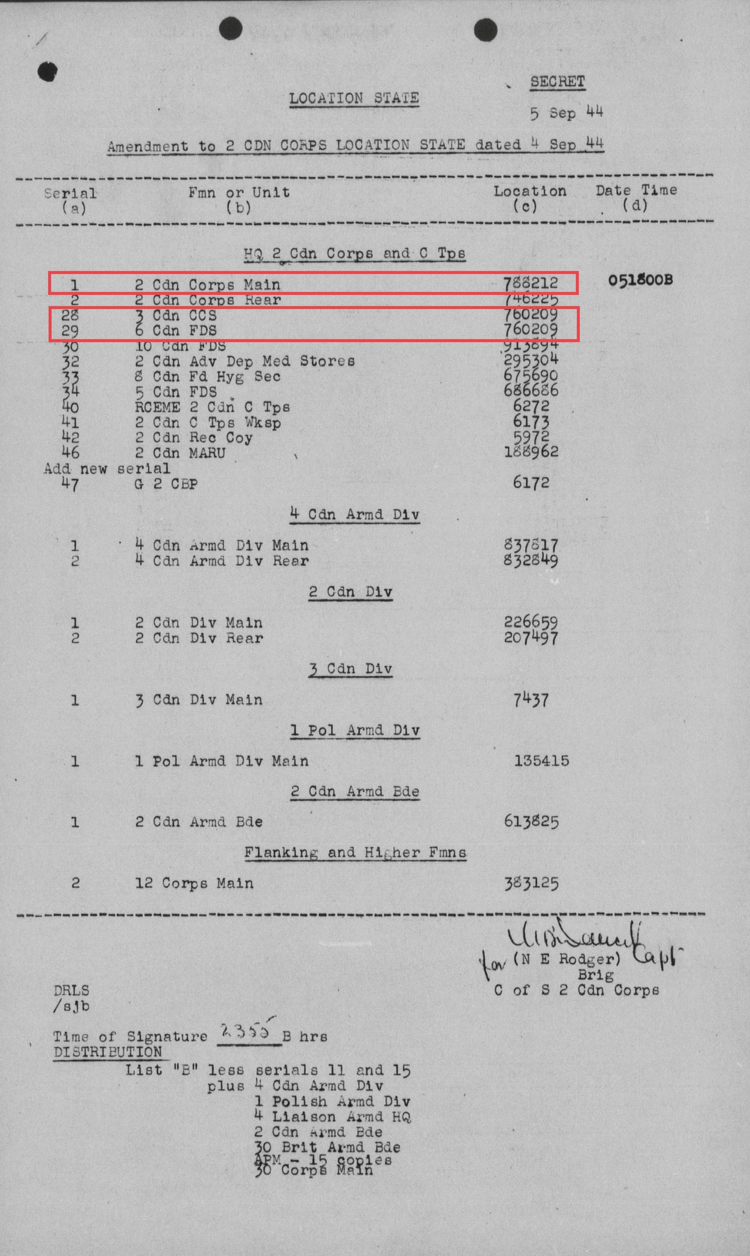

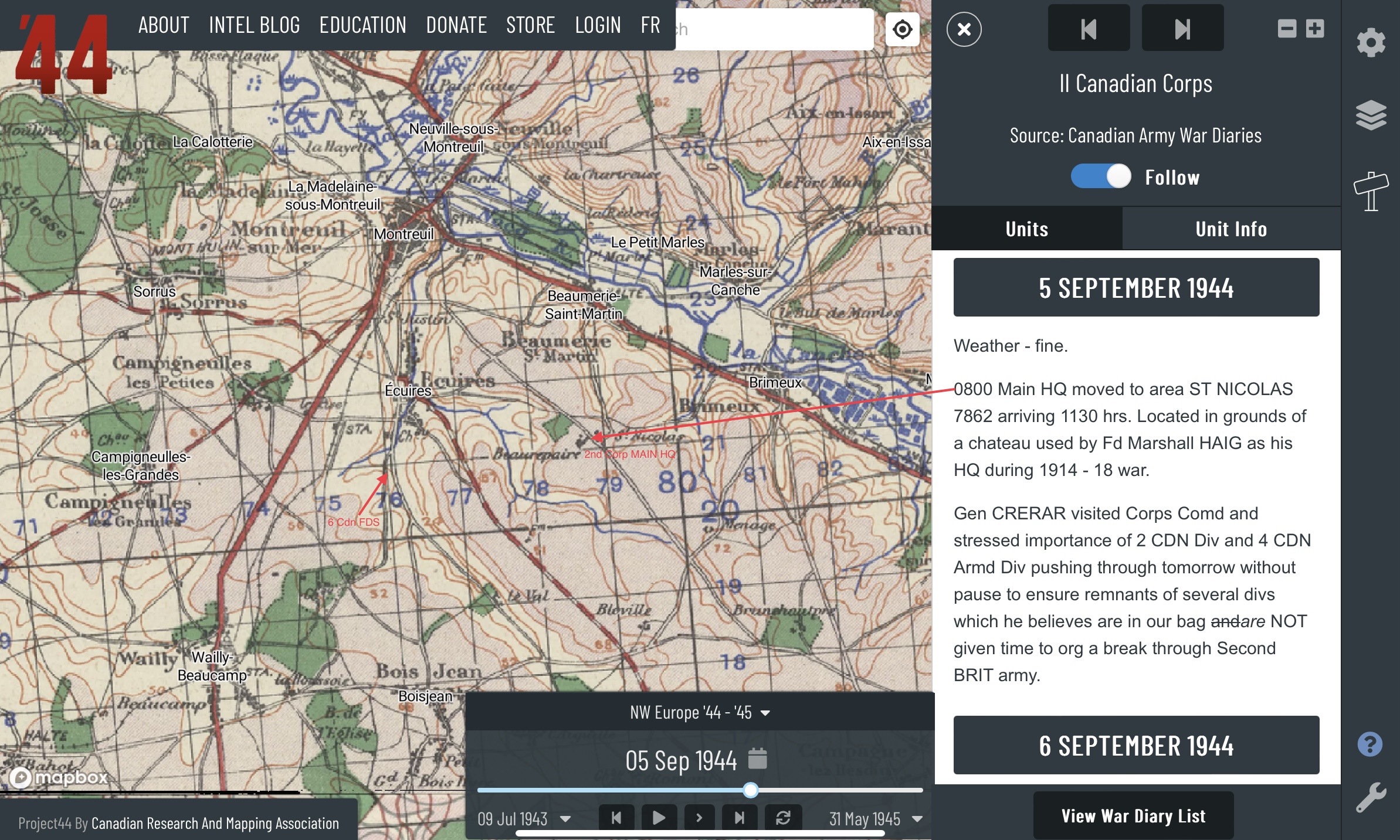

This helped a LOT Seb.
I found the location of 2nd Corps HQ MAIN, it was located very near Montreuil sur mer (see map below), it located their on the 5th Sept 1944
AND
I located the 6 Cdn Field Dressing Station, and it was ALSO located very near Montreuil sur mer
So below is a map show location, and I’ve also included the document showing the location from the 2nd Cdn Corps war diaries
