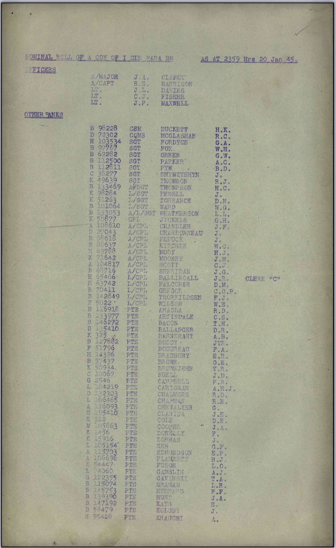

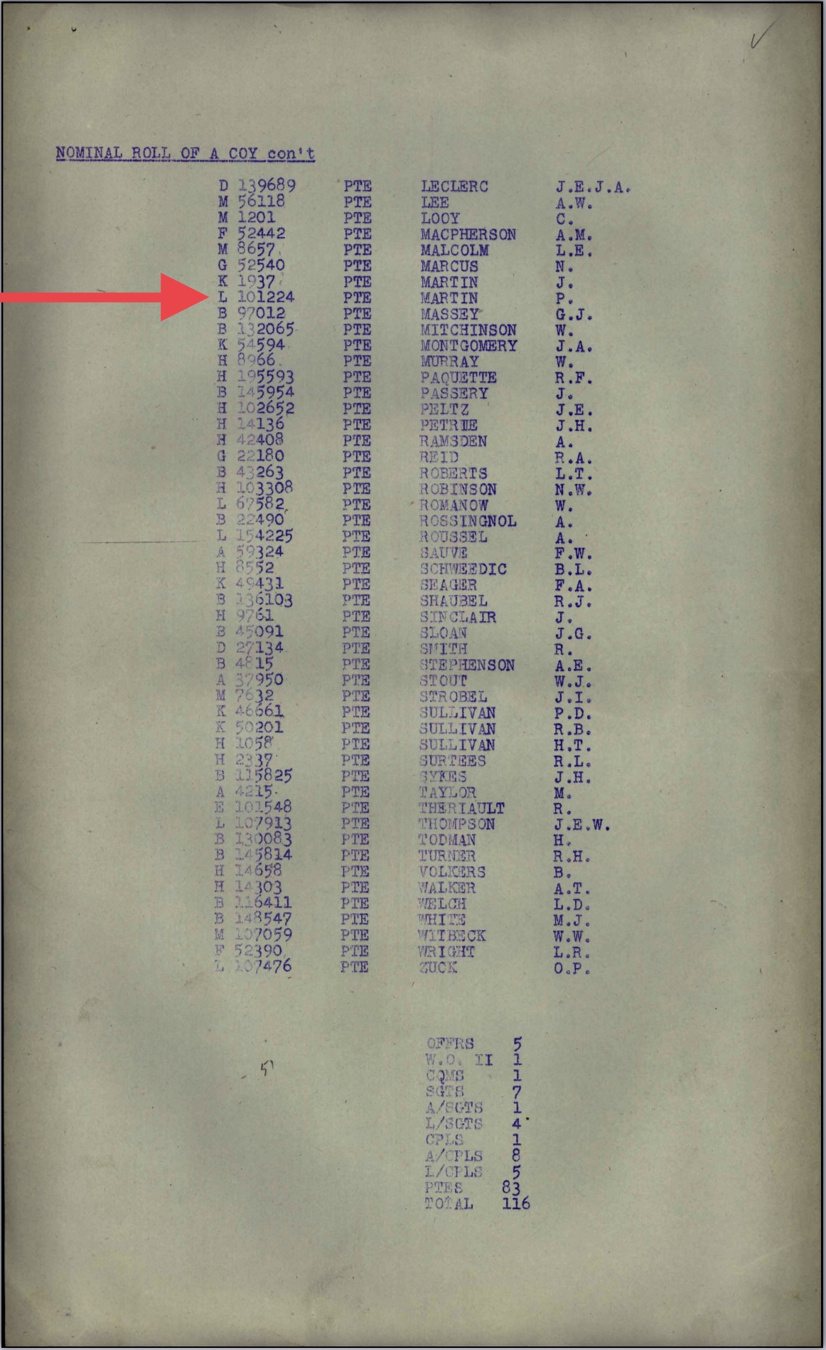

In "Out of the Clouds" (1984) - a book which tells the story of the 1st Canadian Parachute Battalion - it is suggested that a Pte. P- Martin was MIA after Operation Varsity and a Pte M C Meyer suffered injuries during Varsity and later died of wounds. I found a P. Martin (L 101224 / C-Coy) on a nominal roll posted by Temujin on this forum. However, no trace of M C Meyer on that list - which appears to be incomplete (?). My question: There is no trace of those casualties in the CWGC database, they are not listed as casualties anywhere else - would you say that the author of "Out of the Clouds" was somewhat misinformed? As to the MIA case - he might initially have been listed under that category but could have turned up later, after being liberated from a German POW camp. What do you think?

P Martin on Jan 1945 Nominal Roll in ‘A’ Company

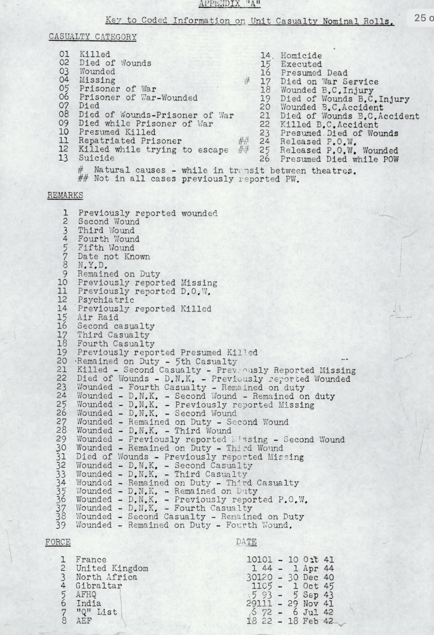

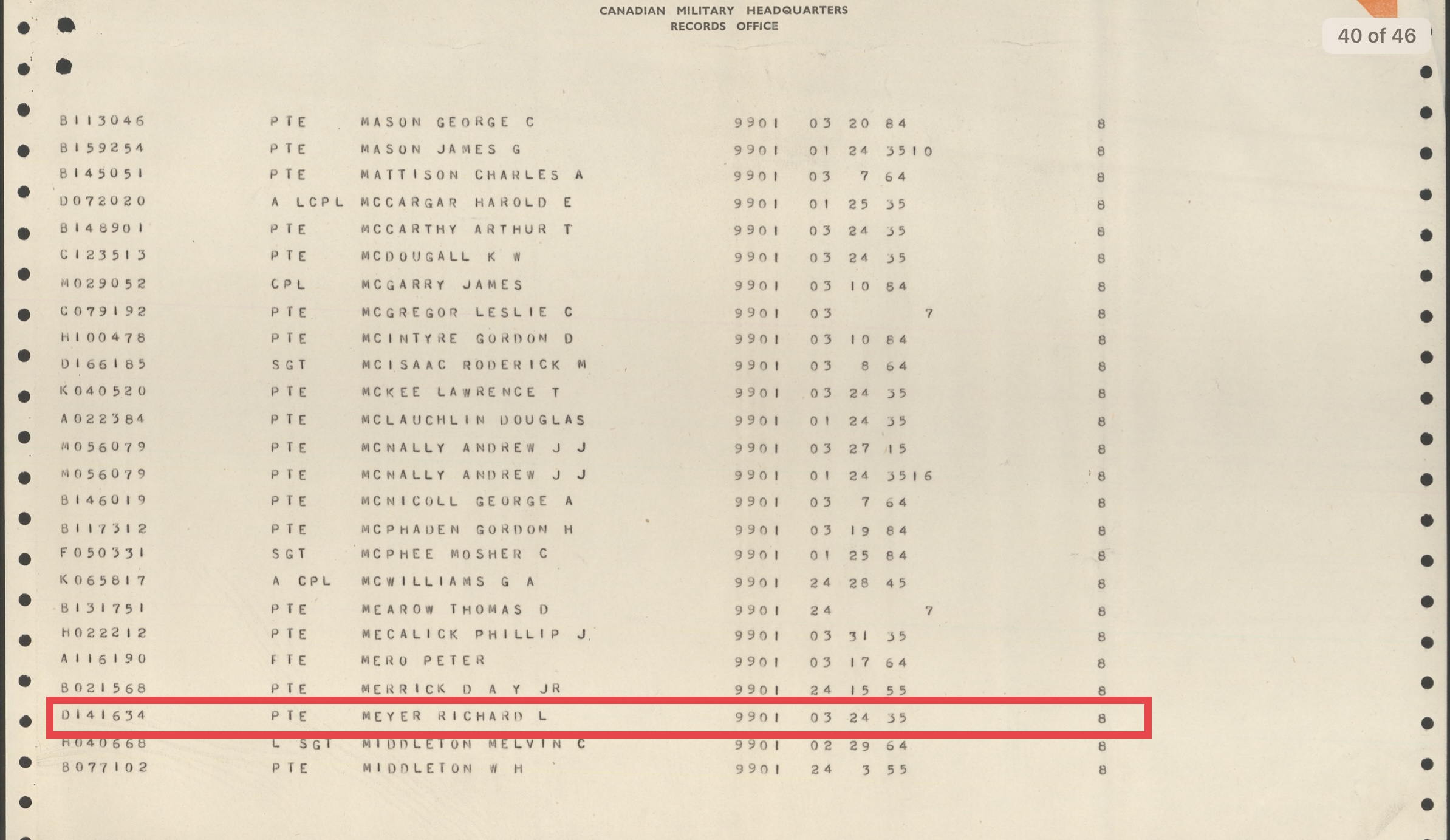

Albert, I found the casualty records of the 1st Cdn Parachute Battalion. At the end of the war in May 1945, every unit of the Canadian Forces was send a list of every recorded casualty in the unit. Units were asked to review the list and report any discrepancies. The list include all casualties, and how they died, were wounded, POW’s etc etc.
Below is the “chart” that they used to tell what each man had, it was possible for men to be on the list more than once, eg for multiple wounds, or if wounded, captured, POW, died of wounds while a POW etc etc.

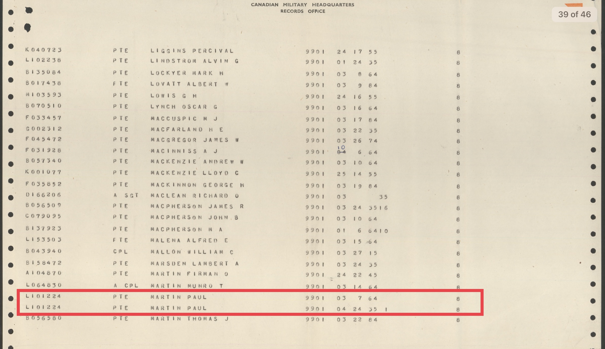

I have found PTE PAUL MARTIN, he is on the list twice, once for “missing” and once for “wounded”…
Second, I cannot find ANY man by the name Pte M C Meyer in any record, the only record I found was for a RICHARD L MEYER that I have included below, and was wounded, but did NOT die. So your reference may have the name of the wrong man, or the reference did NOT exist in the Battalion
To read the columns below, the FIRST COLUMN AFTER the number 9901 is the CASUALTY NO, so this number tells what type of casualty they were, eg ‘wounded’, ‘missing’, ‘POW’, Died of wounds etc etc etc
The record below shows the Pte Paul Martin:
The first record say 03 = WOUNDED, and the date was 7 6 4 = 7 Jun 1944
The second record says 04 = MISSING, and the date was 24 3 5 = 24 Mar 1945
The record below shows Pte Richard L Meyer
The records say 03 = WOUNDED, and the date was 24 3 5 = 24 Mar 1945
Any other questions let me know, I’ll try to see if I can spot any info in the WD’s on the above info

In regards to PTE MEYER, as I indicated I could find no record of a M.C. Meyer, but DID FIND a record of R.L. MEYER. I will check further and see if R.L. MEYER Died of Wounds or is another record on him

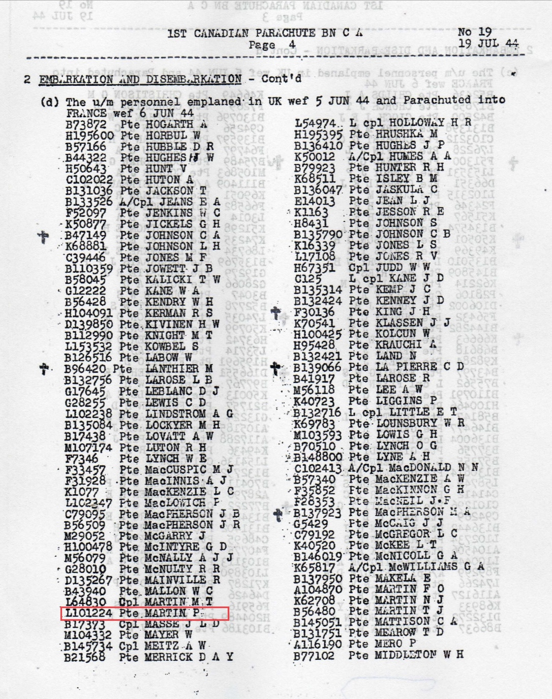

Found this
