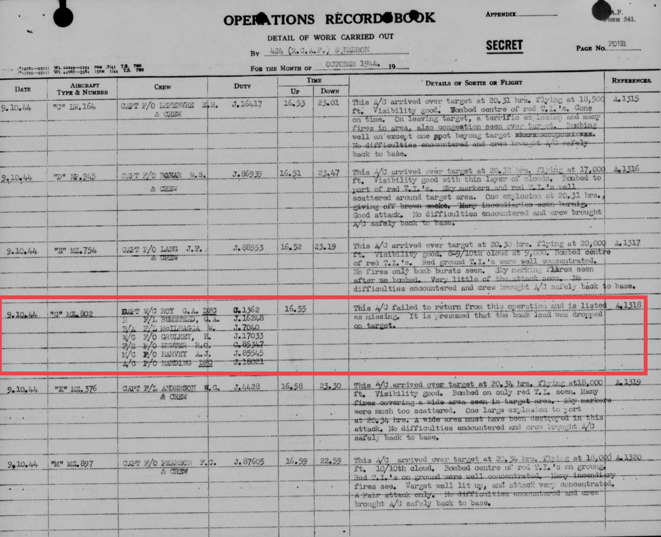

HOLD ON ALL OF THE ABOVE
I found MORE information that now DOESN’T CONFIRM all of the above……
REASON, F/O Keys and Crew FLEW MZ 802 on the next mission, 20 Sept 1944……….so it couldn’t have been his aircraft that crash
UNLESS……the damage was repairable in just a few day, which I don’t this its possible (undercarriage collapsed) so the undercarriage, props, motors etc may all have been damaged……..AND the record says it was a WRITE OFF…….so whatever aircraft it was, it was a wreck……….so NOW did this crew take the SPARE LW 117…….my gut says NO, I do not think a crew that just went through a ground crash could get up, walk to a new aircraft and take off…..and LW 117 is NOT mentioned as going
So, back to “square one” on this on George…….I’m working on it. NOW I’m thinking MAYBE this is the aircraft that had the “Mechanical” (as said in the 424 Squadron Ops Records) and it possible was the OTHER aircraft which I ‘think’ says MZ 310……but I need to check further
The 424 Squadron Ops Record does NOT include LW117 in the mission…….so this one is driving me crazy George……I’m still looking
Here’s the records that shows Keys and MZ 802 flying on the 20th

THE NEXT MISSION, which was OPERATION NO 107
This Shows “G” MZ 802 as FLYING on this mission, with Flying Officer Keys?????? So the Report from Skipton on Swale that Aircraft Code ‘G’ was the one that ground crashed. May be incorrect????

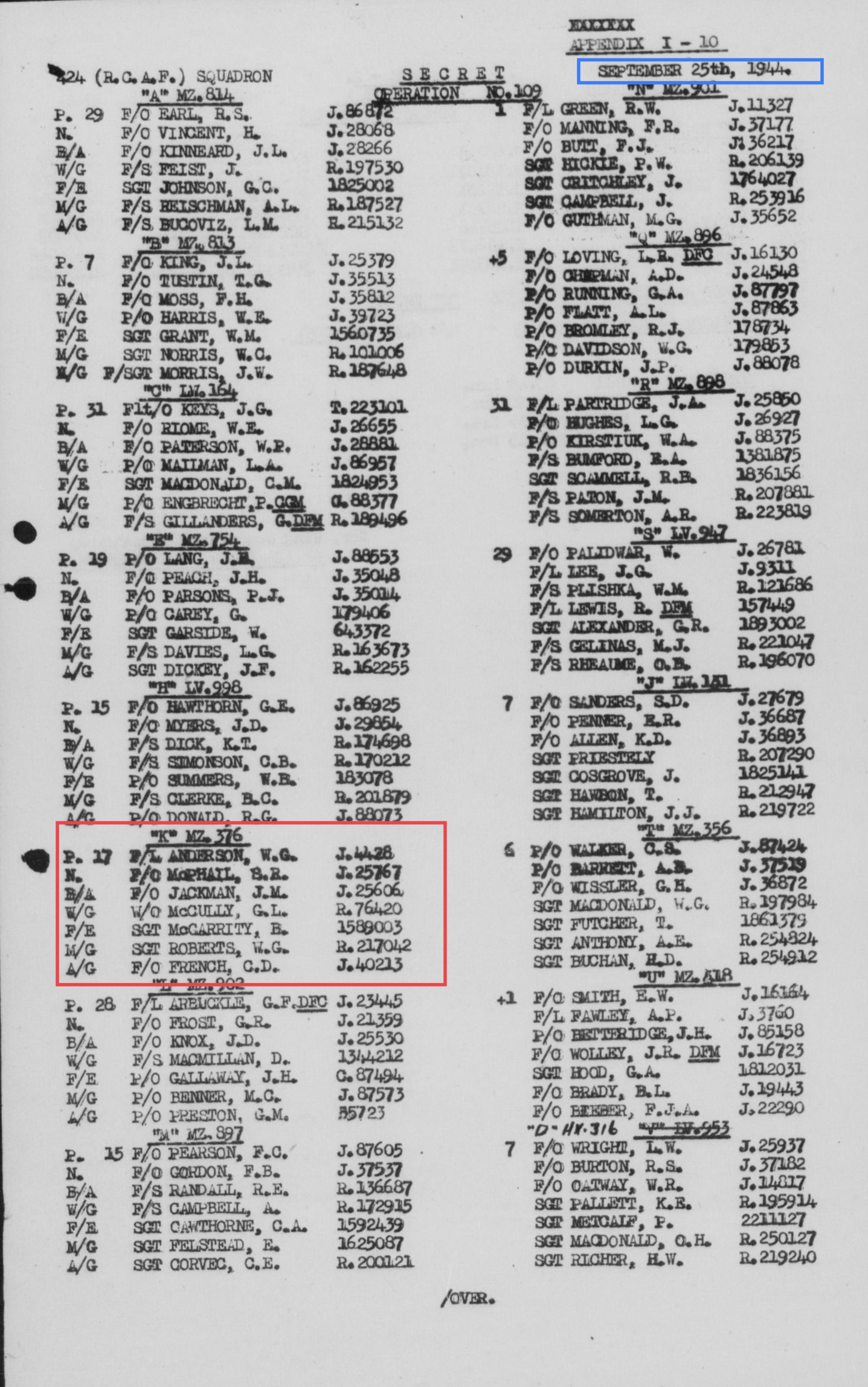

Fact 5:
I’ve checked the next missions and I do NOT see any missions with ‘K’ LW117 BUT…….on the mission on the 25th Sep 1944………a “NEW” Aircraft Coded ‘K’ MZ 376 shows up………As normally in RCAF service they “re-use” the Code letters after a previsous aircraft has crashed or taken out of service……So this is telling me the “K’ LW 117 has been removed from service with 424 Squadron and replaced with a new aircraft………does this mean that LW 117 is the “crashed” aircraft, or it has just been taken out of service?????
Fact 6:
‘G’ MZ 802 is lost in action on the 9th Oct 1944……….which confirms that this aircraft could NOT have been the aircraft that ground crashed on the 17 Sept 1944 as reported by Skipton on Swale……….
