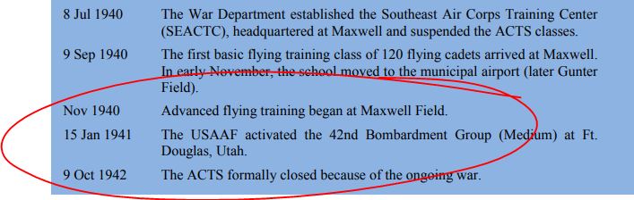

Having looked through some other (A) military abbreviations (Armoured, Active, Air, Advanced, Army) I'm beginning to think that in this case it stands for Advanced. Advanced flight training began at Maxwell in 1940.
Page 12
