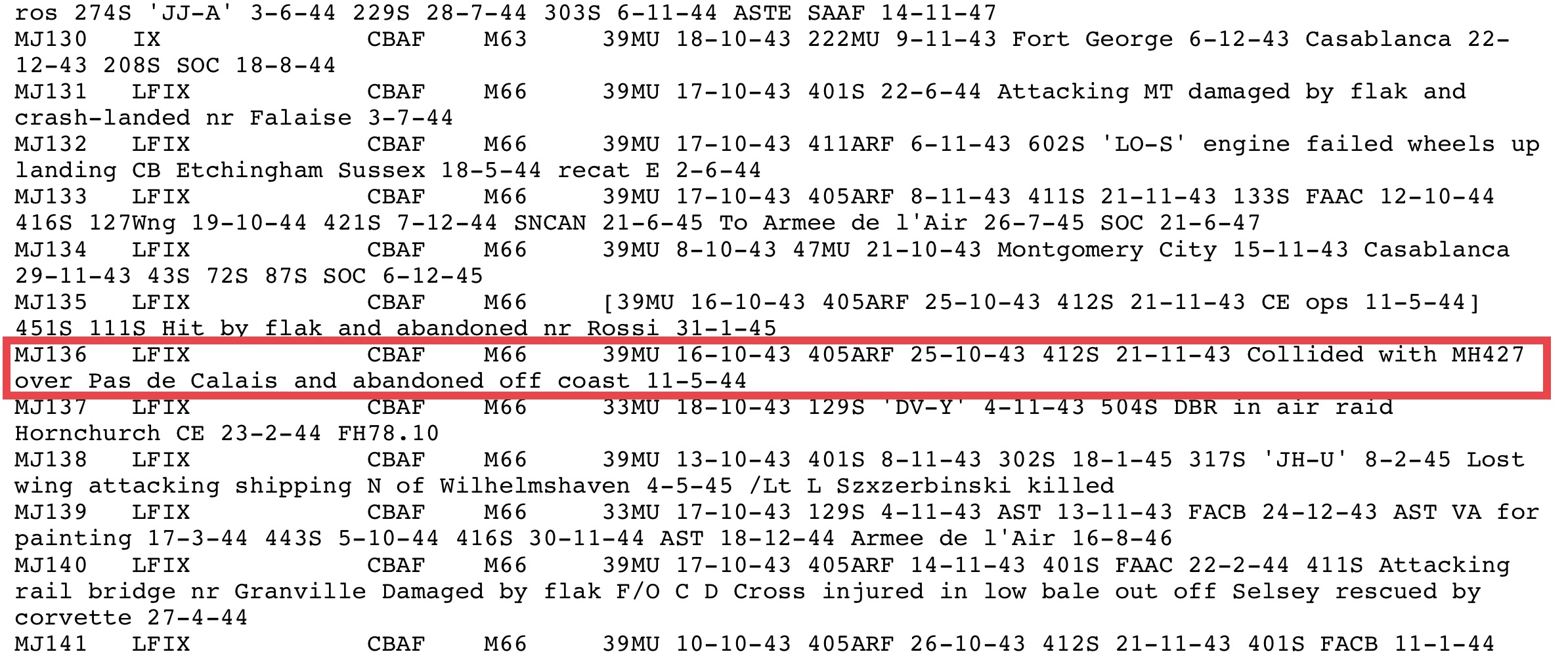

Researching RCAF 412 Squadron I came across 2 incidents where Spitfire MJ136 was lost in crashes, I looked at "Aircrew Remembered" and "Spitfire Pilots and Aircraft" with no help, both pilots are from RCAF 412 Squadron, I have:
F/O J.S. Hamilton RCAF, on 11 May 1944, with a mid-air with MH427 over Pas-de-Calais, France both pilots rescued
and
P/O D.R.C. Jamieson, RCAF on 10 June 1944, aircraft crashed over Tilly-sur-Seine, France
I am sure one of them is a typo ! any help would be appreciated !

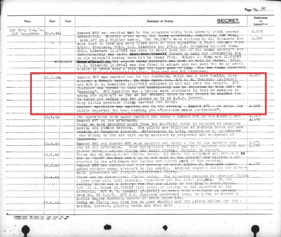

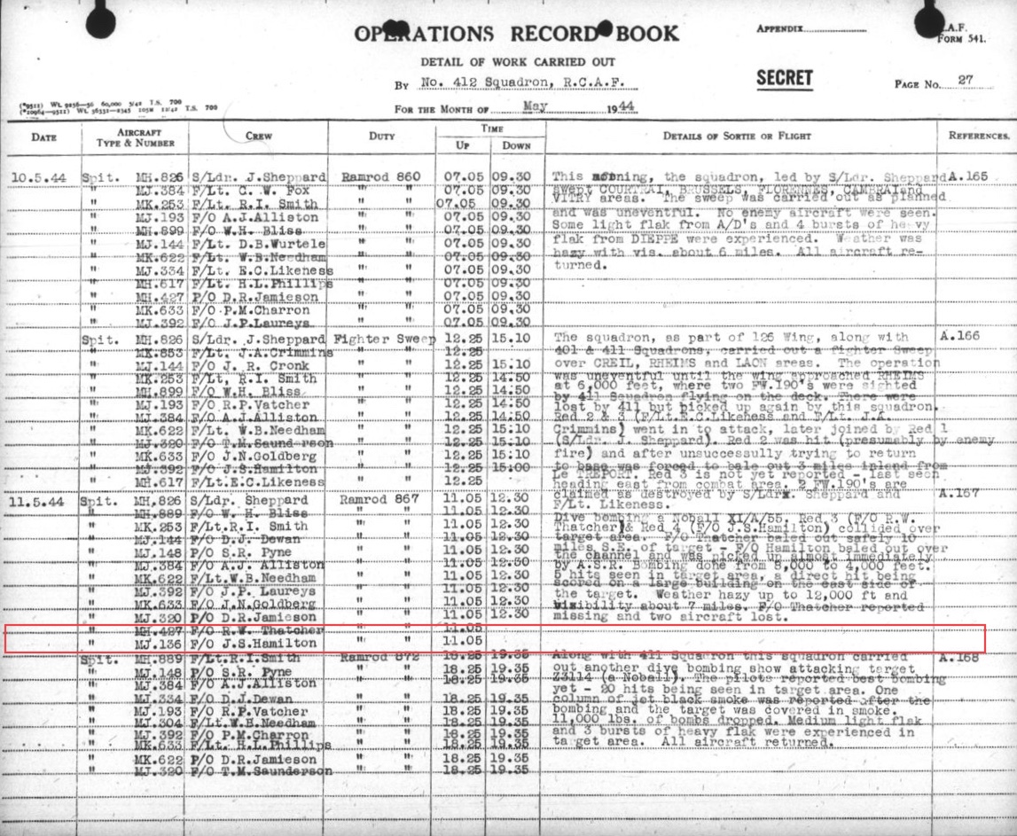

NOTE: George, checked thru the records BEFORE this crash and MJ 136 shows up multiple times......so this records seems correct

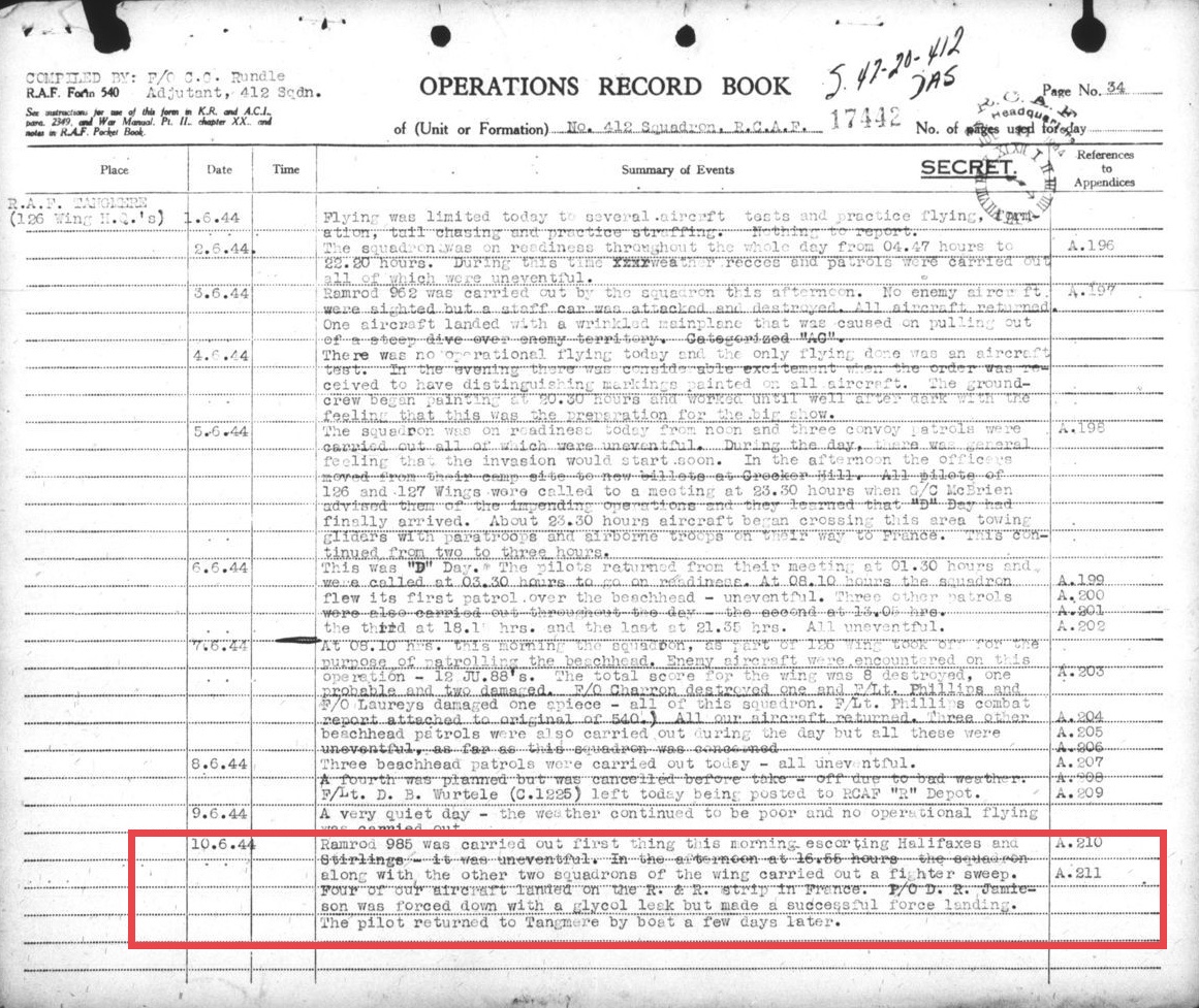

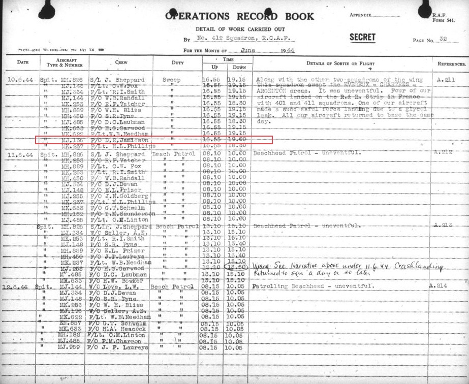

NOTE: George, checked thru the records BEFORE this crash and MJ 136 shows up multiple times......AND so this records seems correct ALSO, Not sure whats going on

Spitfire production list shows it was involved in the “mid air”
Source: http://www.airhistory.org.uk/spitfire/_prodn%20list.txt

So, I’ve looked thru the records....and MJ 136 shows up in BOTH months.......and being flown BEFORE each of the ‘crashes”........so if its a “typo”....the typo’d many many times........
At first I thought that maybe it made it back on the first “crash”........and it ALMOST did, but the pilot “bailed out” when reaching England (or just before).......so I don’t think the recovered the aircraft, repaired it, and flew it the next month......

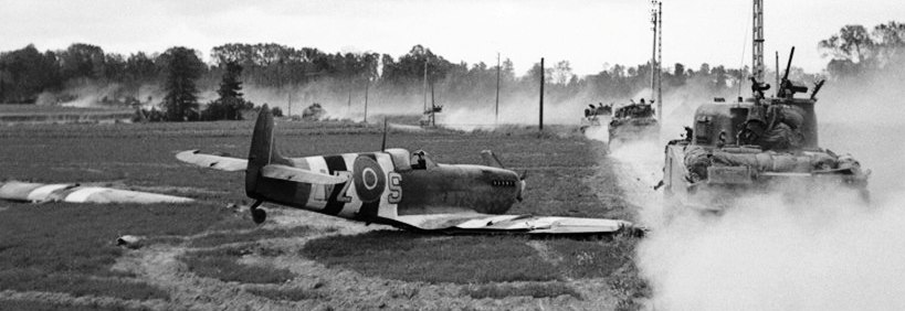

Note of interest George, if you look down the record I posted previously, you will see aircraft MJ255 crash landed the next day on the 11th Jun (I thought this may have been the confusion......but it’s not).
I found a photo of this aircraft after it crash landed........just for interest
Supermarine Spitfire Mk. IXE (Serial No. MJ255), coded VZ-S, No. 412 Squadron, RCAF, Tilly-sur-Seulles, Normandy, crashed on 11 June 1944, photo taken on 17 June 1944

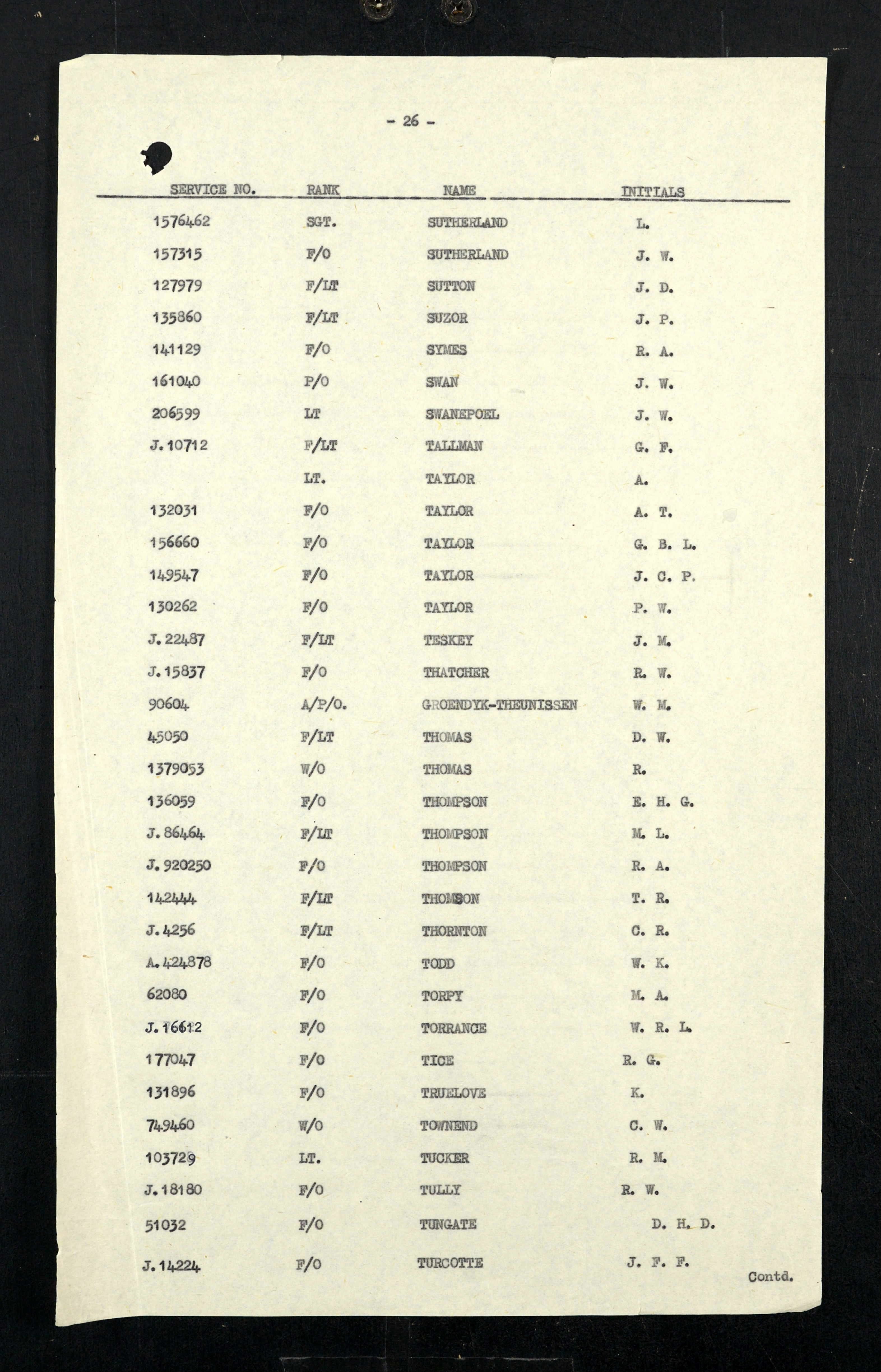

Another note of interest, F/O R.W. Thatcher, the pilot of the second aircraft that collided, was captured and a POW
POW No 5840. F/0 Thatcher, R.W. J15837
Name: R. W. Thatcher
Rank: F/O
Military Date: 1939-1945
Service Number: J.15837
Source Description: 1490: Stalag Luft III (Belaria): Nominal Roll of POWs and Recommendations for Meritorious Work

Post by georgetanksherman » Thu May 02, 2019 9:06 pm
Yeah, that was my dilemma, how can an aircraft be in a mid-air collision, pilot abandon the aircraft over the channel and then 30 days later, the aircraft be back up in the air and have a forced landing due to a glycol leak ????
