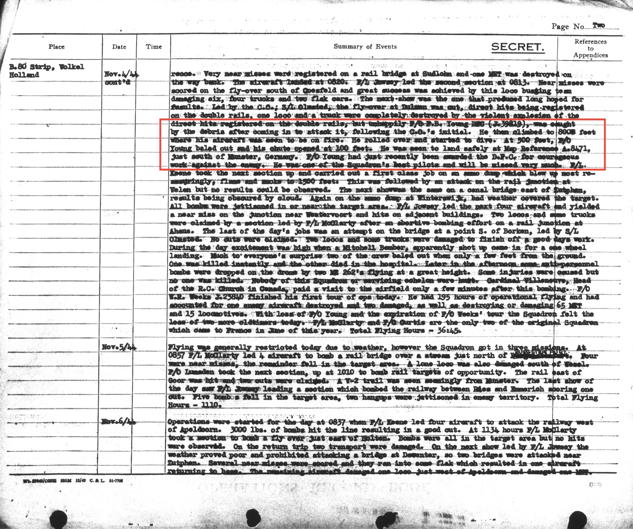

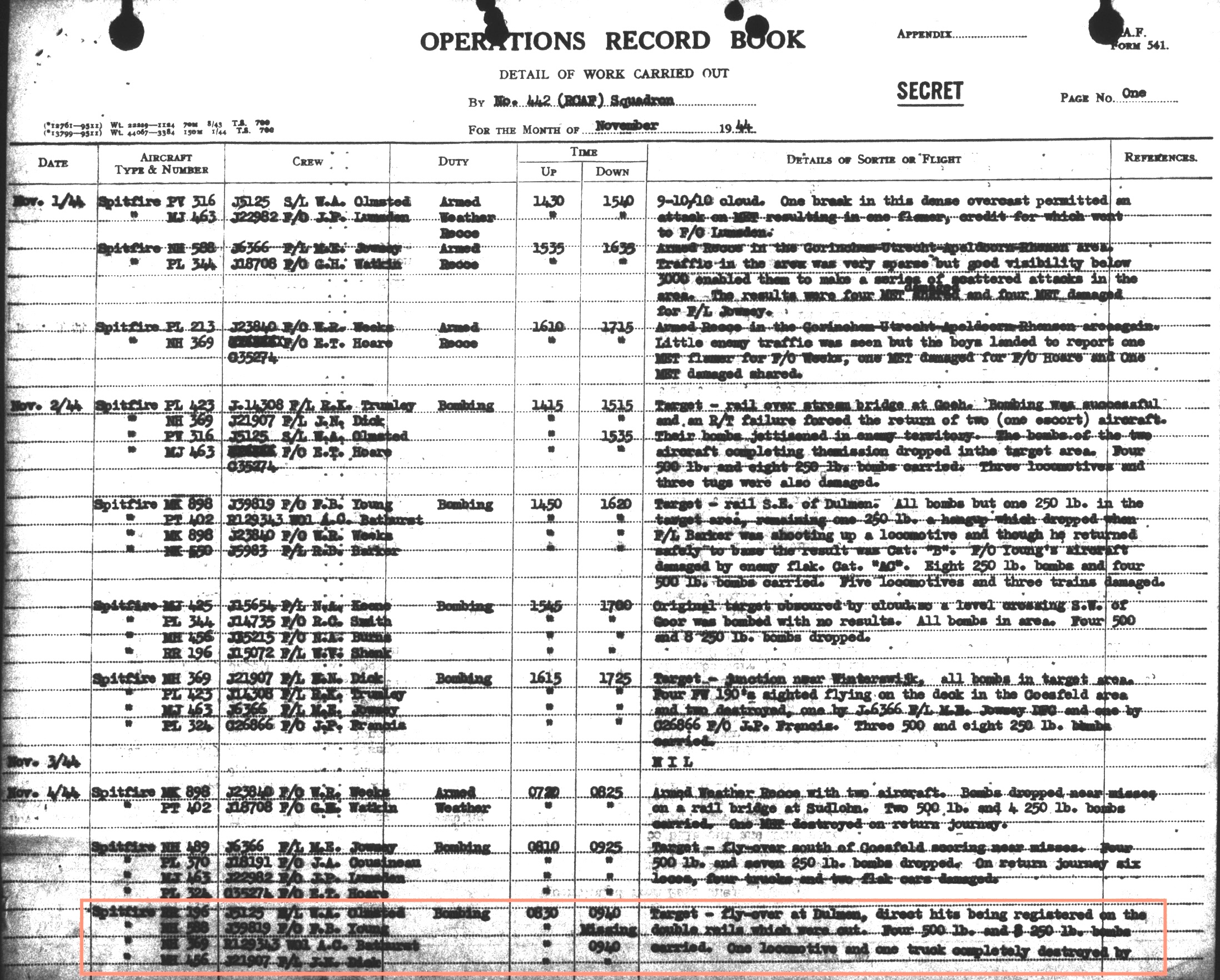

George I’ll check out both…….but I found a FO F.B. Young, 442 Squadron, shot down on 4/11/1944 BUT aircraft number was NH 588

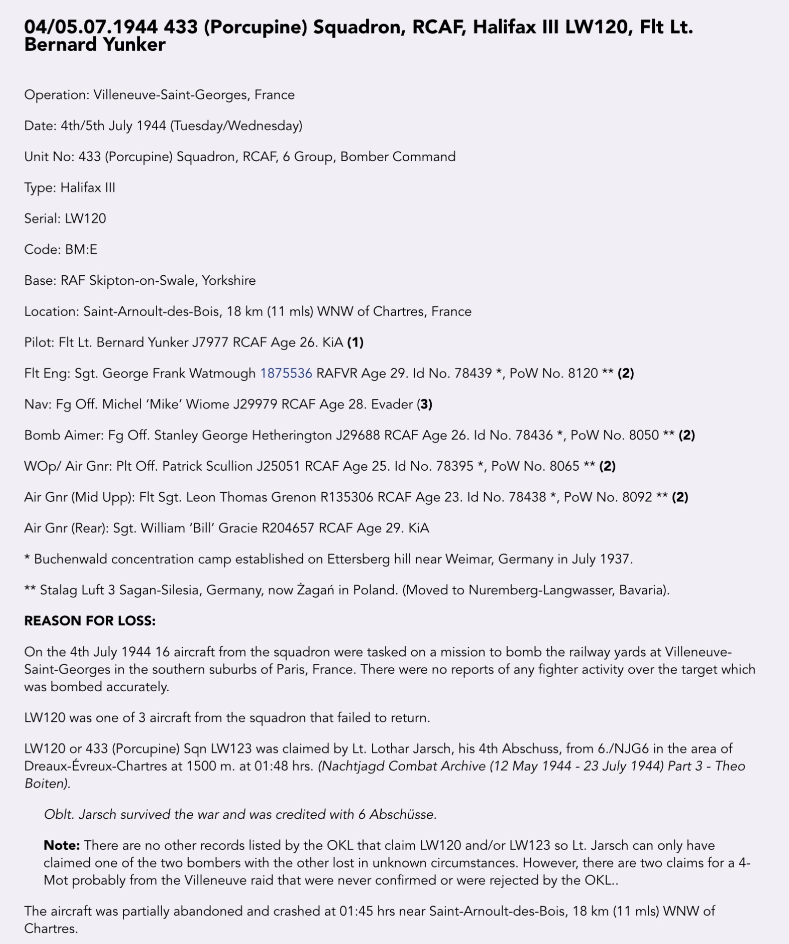

George, their was no “Young” aboard LW 120 which was shot down on the 5/6 July 1944

Some background, from the chronology.
July 1944
4-5 Immediately following the TALLBOY attack on the V-1 storage caves at St. Leu D'Esserent it was bombed by a further 231 Lancasters and 15 Mosquitos which destroyed the access to the site. Within 2 days the number of V-1 launches is reduced due to the destruction of these attacks
(http://www.flyingbombsandrockets.com/Timeline.html). Another 282 Lancasters and 5 Mosquitos attacked 2 rail yards, while 36 Mosquitos bombed the synthetic oil plant at Scholven-Buer, 11 GARDENING, 16 Special Operations, 25 RCM, 30 OTU and 61 SERRATE/INTRUDER/V-1 patrols, a total of 712 sorties with the loss of 28 (BC War Diaries). This was the first operational use of JOSTLE RCM jamming, flown at high altitude by Fortress aircraft of 214 Squadron (Ken MacLean www.rafcommands.com).
4-5 433 Sqn. Halifax III LW120 BM-E shot down by a night fighter over France, pilot F/L B. Yunker RCAF and his rear gunner P/O W. Gracie RCAF killed, F/O P. Scullion RCAF, F/O S.G. Hetherington RCAF, F/S L.T. Grenon RCAF, F/O F.B. Young RCAF and Sgt G.N. Watmough RAF PoW, F/O M. Wiome evaded (www.rafcommands.com PoW list; O. Clutton-Brock).
It is as Temujin reported, just adds some details of the operation.
https://www.bombercommandmuseumarchives ... irwar.html
Paul Squires
