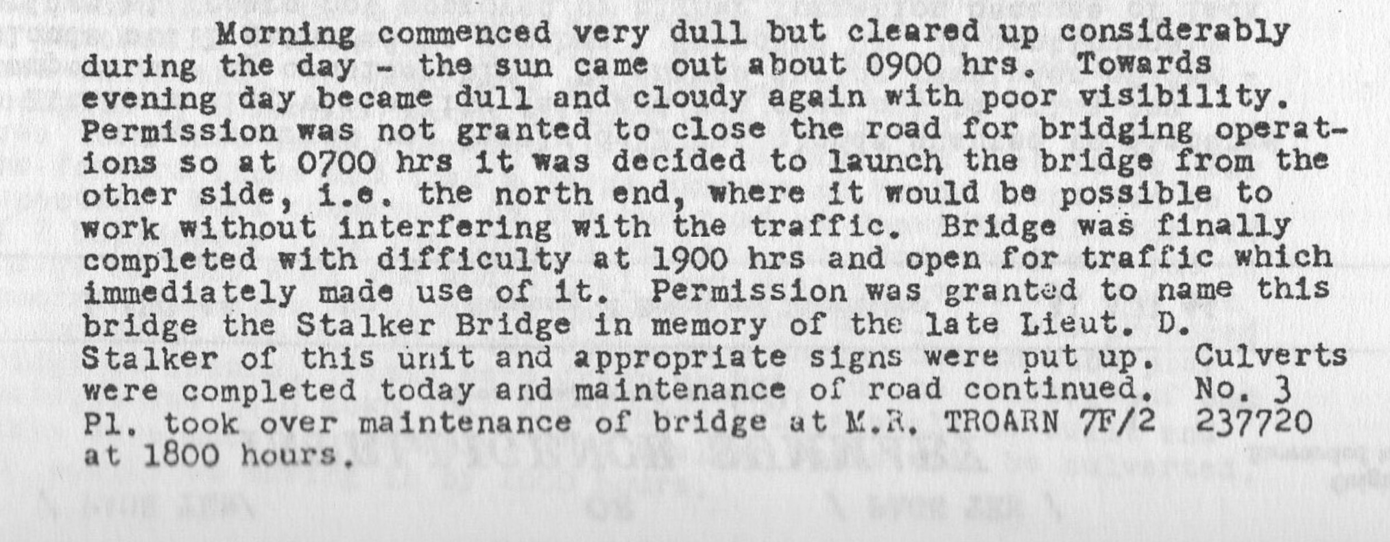

Lorraine, I have some questions, and then some information. Before I started looking for the bridge site, I read the war diaries to give me info on the bridge. Here’s the info you posted on the bridge
If you read this, it tells us how the 5th wanted to build a bridge but they needed to close an existing ford, and the road, which HQ’s denied (they needed the trucks and men moving forward)......so then they decided to build the bridge to the NORTH of the existing road. So we know that the bridge was NOT built “on the road” but slightly north of it.
Then the war diary says that NO 3 Platoon took over the maintenance of the bridge (after it was built).....I’m ASSUMING this was the bridge they just built........BUT, it “MAY” have been another bridge???

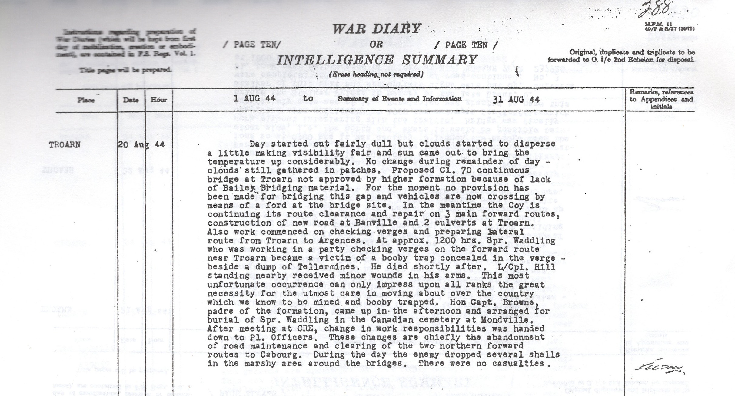

Could you post the war diary page for the day BEFORE this page, I’m trying to see if I can get any other clues on the exact location of this bridge. JUST WANT TO MAKE SURE

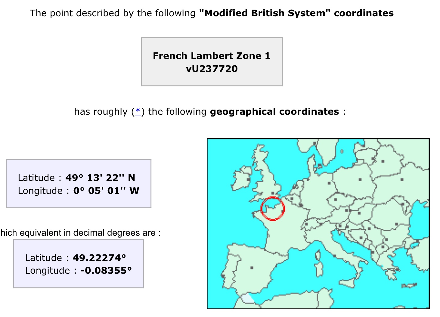

So first off, I had to determine where the co-ordinates come from. France etc was mapped with the Lambert System. So I had to find the location using this system, and the British Map Reference.
Here’s the location of the map reference, converted to the Lambert System Zone 1 (note: if you look at the bottom of the map that Phil Posted, or the “whole” map.....you can see in RED the reference to the map being Lambert System Zone 1)

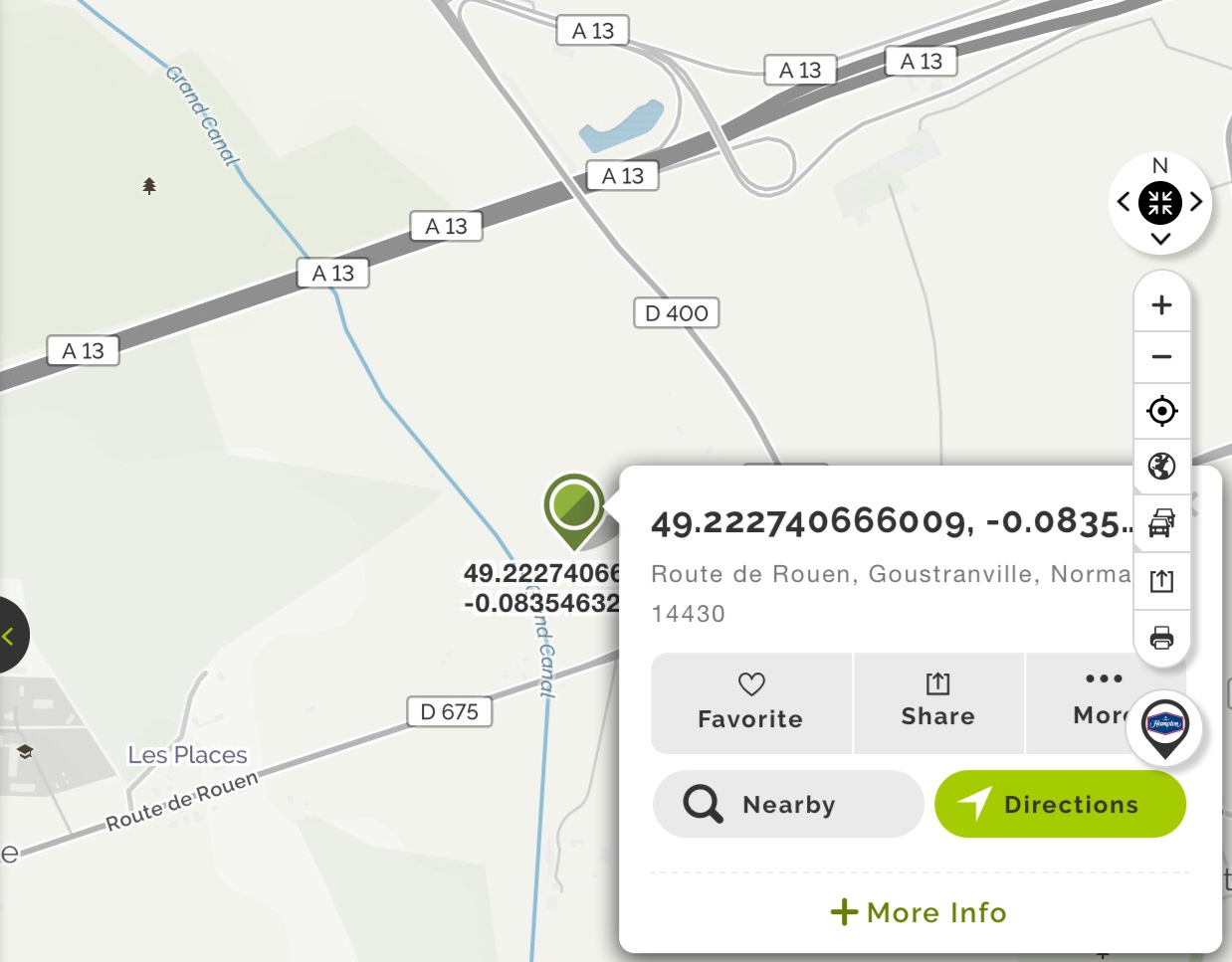

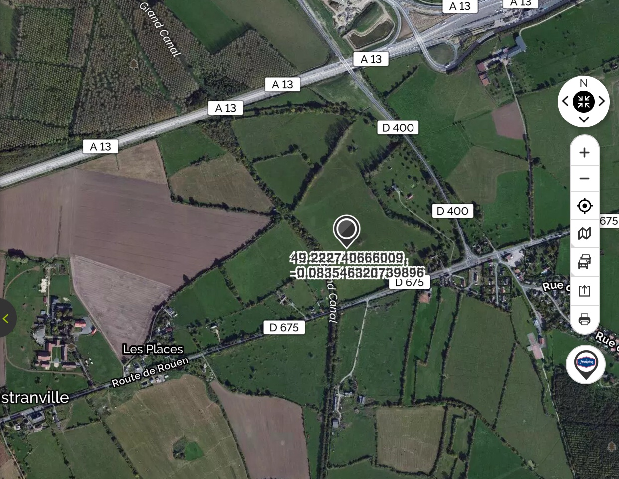

Then using the co-ordinates that this gives us, I’ll now post a series of maps, first large ones so you can see the area we’re in, and then zoom in..
You’ll see the co-ordinates come out to JUST NORTH of the existing highway and bridge over that highway, so using the info in the WAR DIARY, this seems to be correct, the bridge was built JUST NORTH, of the existing road
So the above shows the approx location. Remember the conversion isn’t EXACT, so that is why the postion is slightly off the river.

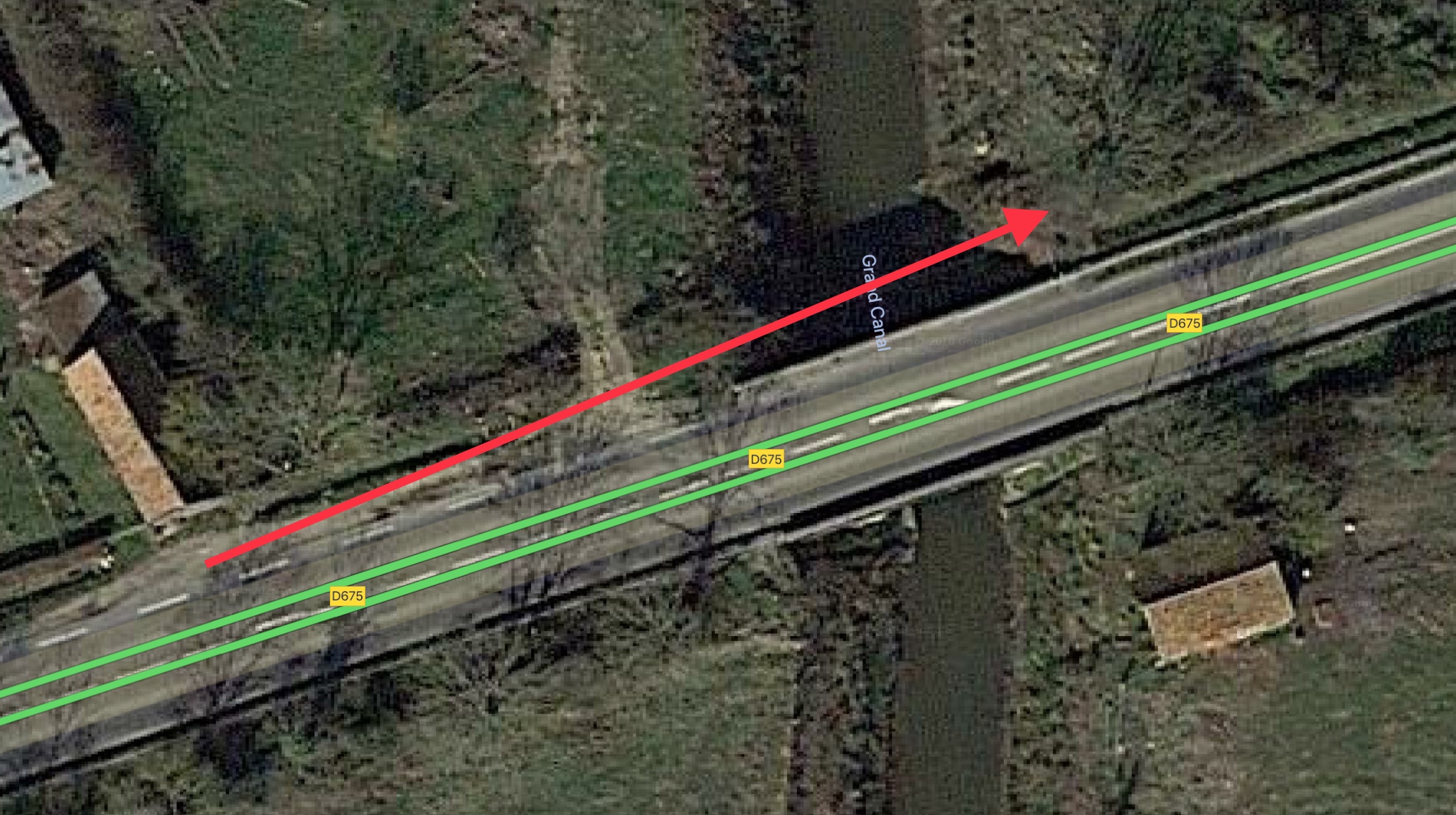

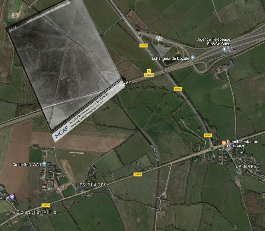

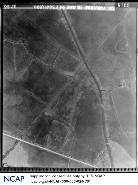

I found some aerial images from 1944, and I've overlaid this one onto a current image. It looks to me that it's a railroad crossing the canal diagonally and proceeding into the town. This could the rail bridge mentioned in the previous account. You can also clearly see another bridge North of the road, though this is the road to the North of the one we've been looking at previously.
https://www.google.ca/maps/@49.2248079, ... a=!3m1!1e3
https://ncap.org.uk/frame/1-1-70-14-18

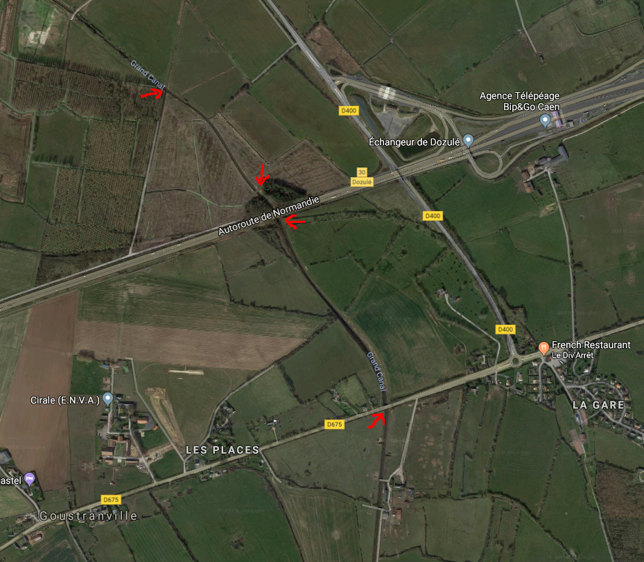

So, to summarize, here are the bridges in the immediate area of those coordinates.

Phil and Lorainne, I have to give you my opinion. I do not believe the bridge was built at the northern locations. I believe the bailey bridge was constructed close to the bridge on D675......(the south bridge on your Map Phil)
My reasons why:
First, before I start my reasons, I have to assume that the Map Reference in the war diaries IS the map reference for the Stalker Bridge. I’m hoping that Lorainne will give us the War Diary Page BEFORE the one she posted, and if she has it the one AFTER. I think if I have a little more info, I should be able to confirm the Map Reference location....
Having said that, I am assuming that the MR 237720 is the location therefore my reasons:
1. Having spent 17 years in the Army, I KNOW that Map (Grid) References are one of the “most practised” items in the military. If you don’t know where you are......then you can’t do your job. Engineers are particularly good at Map References, as they have to find exact locations, to build bridges, plant or remove minefields etc etc........SO having said that I KNOW the MR 237720 is most likely correct.........ALSO, all “jobs” that the Engineers preform are first “RECCE’D” by an Officer or Senior NCO. They confirm WHERE the bridge will be built. The war dairies that you posted talk about the bridge for at least 2 days, so they knew where it was built, IMHO
2. And Using the Map Phil has confirmed, their is NO DOUBT in my mind that MR 237720 is the location of the bridge, over the canal on Route D675 (this is a modern day highway number).....so the bridge had to be built at that location or shortly north of the existing bridge.
3. Zooming in on google maps, shows a “build up” on the north side of the existing bridge. To me, this looks like where the bridge was built (the bailey bridge).......as you need room to build and launch the bridge, but on the other side, you only need enough room to deconstruct the landing nose, and prepare the bank and road. Also the almost “straight” approach from the road to the Bailey Bridge, again makes sense, as this is how we are taught to place bridges, close to the main route, NO HARD TURNS so tanks or armoured vehicles will tear up the approach road, and close to the main route on exit. ALSO, normally we would try to use the existing bridge (lay the bailey bridge over it)......but I’m not sure why they didn’t do this, the bridge and abutments may have been to damaged (blown up) or some other reason.
4. Another assumption is that the existing FORD was close to the bridge site, and because the 5th Field Company was NOT ALLOWED to close the road for construction or close the FORD.....I would assume the FORD site was below (to the south) of the existing bridge......I’m assuming, it would be nice to know where the FORD was?? By the war diary it was right next to the existing bridge
Having said all of the above, this is my best guess.....and I may be wrong.......and if I am WRONG, luckily I’m a moderator and I can delete all my post so I don’t look dumb......Ha ha
SO, next step is if we can get more pages of the War Diaries for this time period, I may be able to confirm I am “right” or “WRONG”.....

here are the war diary pages from the days before and the day after.
